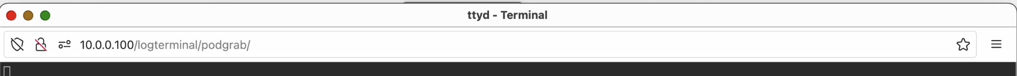

When I’m trying to access a docker container by clicking the docker app icon and selecting ‘Console’, a new Firefox window opens and closes almost immediately. I had to film and isolate a frame of the new window (attached) to read it because it closes so quickly.
The window is called ‘ttyd-Terminal’ and looks like this for podgrab, binhex-syncthing, and heimdall.
serverip/logterminal/podgrab
serverip/logterminal/binhex-syncthing
serverip/logterminal/heimdall
