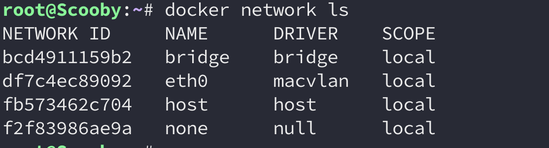

Well, I got it working, though now I have an eth0 instead of a br0. I'm sure my system is in some weird state now, completely off what the Unraid developers designed. I'll plug at it a bit more after I create a backup and feel a bit safer. Is there a way to do a soft-reset, resetting unraid without losing the data? I'd like to get back to a factory default state and start building things again.

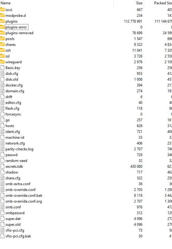

First, make a usb backup. Main Flash
Everything that is Your Unraid system is in the config folder.
Pools, disk configuration, templates, plugins etc...
Including your UIUD key!
*if you format the same drive the UUID is the same. the key is still valid for the new flash format of the same USB disk.
With the backup created. Format the usb and make a fresh unraid and copy the entire config folder from that backup.
Its been a while and pulling from new and old notes and my experiences:
iscsi is the folder from the iscsi plugin...
modprobe.d is info on vfio/custom modprobe configs.
Plugins is all you currently installed plugins
plugin-erros are bad plugins that limetech said failed and moved their
plugins-removed are dead plugins that failed
pools folder is info on you unraid disk layout
shares are your samba shares settings.
ssh is you info for the sshd daemon
ssl is your inform and certificate for your device.
wiregurad is the config data for unraids openvpn
*.key is you license file tied to the uuid. I have a basic grandfathered license.
disk.cfg is the settings in the webui that auto start the array
disk.old is a backup of the disk config settings
docker.cfg are the docker web ui settings
domain.cfg are the qemu/kvm web ui settings
drift  is ??? - couldn't figure it out... may be disk related...
editor.cfg is a webui file for mime types
flash.cfg is the smb share setting.
foresync is the file used for parity and is disk related
go is a script file at preboot to run other setting. this also started the webui back end service for unraid.
hosts is a custom file that I use to replace the unraid host file
ident.cfg is a disk/array needed file that identifies what disk is what.
machine-id is a unraid file used in NetBIOS/smb
network.cfg is your saved network settings - i would delete this! to make sure you get a proper setup...
parit-check.log log is a log
passwd is the root password file delete to regain access to unraid root user also continues password of other users added
random-seed is a p rng used with encryption like ssh and other processes this is your mod p
secrets.tbd is the database for login credentials and hashes
shadow is a disk unraid file of data
share.cfg is the web ui for disk share and smb may be added form unassigned plugin
smb-extra is the webusi for samba extras
smb-overide is my user script to replace and set specific smb settings i want to run on my network
smb-conf is a backup of unraids original smb config i made...
smbpasswd is you share users and access to unraids smb
super.dat is required to maintain your disk configuration
super.old is a previous disk configuration and is needed to maintain you disk configuration
vfio-pci.cfg is the bind for vm/hardware passthrough
You may have other or different files. Since Unraid is a mutable OS. similar to have to delete the database file for the docker networks, there is a database file for network configs. I don't know where it is at!
as such, a fresh format and a copy of your config folder should be fine with no data loss. Do at your own risk.

in truth, you can stop all dockers. Delete that network and recreate a docker macvlan network...
https://docs.docker.com/reference/cli/docker/network/rm/
https://docs.docker.com/network/drivers/macvlan/#:~:text=To create a macvlan network,through on the Docker host.
docker network create -d macvlan \
  --subnet=192.168.1.x/24 \
  --gateway=192.168.1.1 \
  -o parent=br0 pub_net
^Which has been known to cause macvaln trace kernel panics...
this is why bridging is off...
if bridging is off and bonding is off that is normal to see as the default custom docker.
