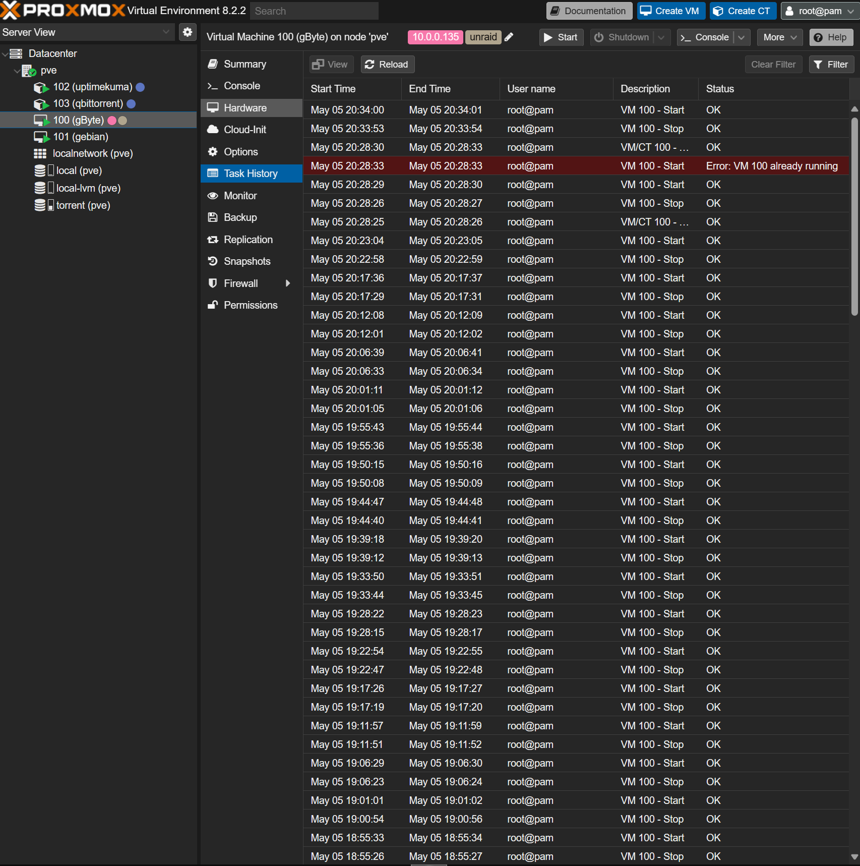

I recently deployed a new Proxmox server. I am intending to use Unraid as a VM to manage the storage. I have the VM created and booting from a USB, however, I noted today that it will randomly restart every few minutes. Despite my troubleshooting efforts I cannot pin down why.
Here is a screenshot of the task history of the VM in Proxmox:
Attached are my diagnostics. Is there anything in there that sticks out as problematic? Thanks in advance for any guidance.

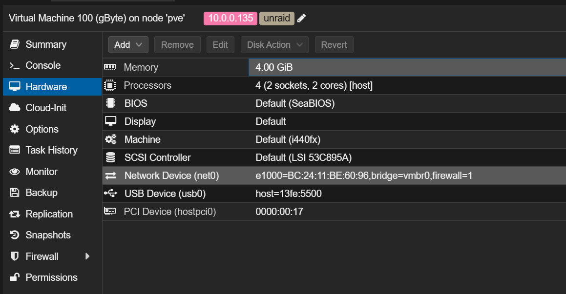

Can you post a screenshot of the proxmox hardware config page for the VM?
What kind of hardware is Proxmox running on?
@tjb_altf4certainly - thanks for lending a hand.
This is what I have configured in proxmox for my unraid machine:

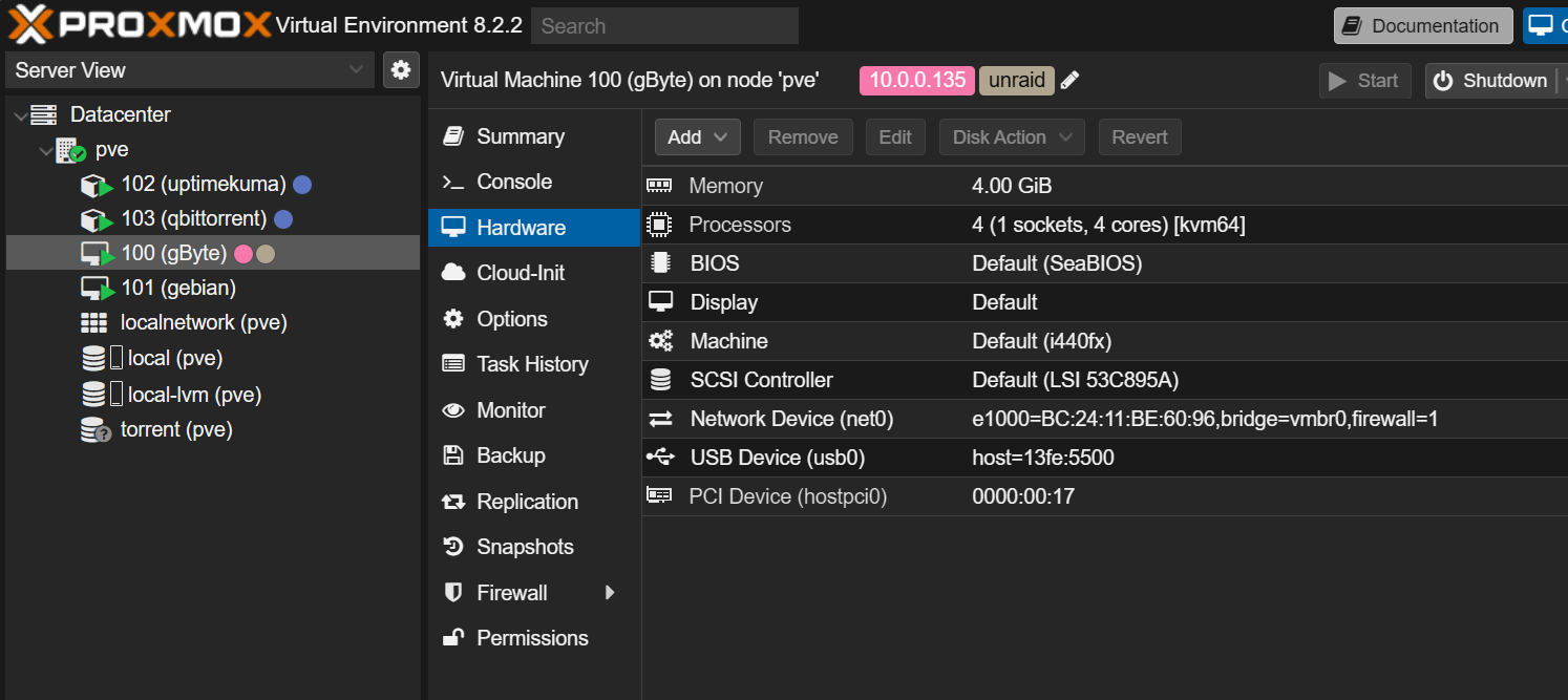

Try changing "Processors" to the following
Gave this a shot, unfortunately I see the same behaviour. These are my current hardware settings:

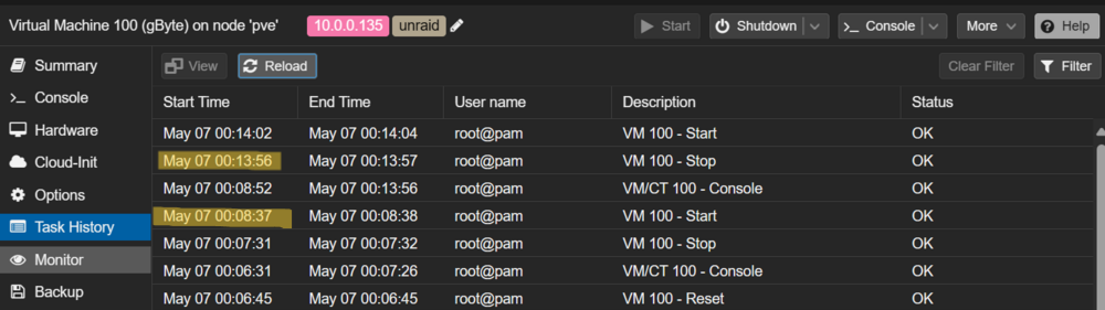

We can see it reboot 5 minutes & 19 seconds after startup:

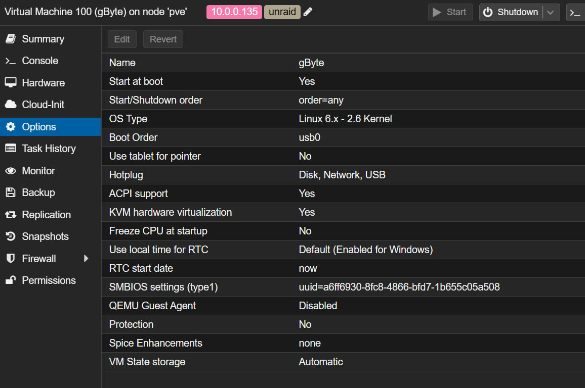

Here also are my VM Options:
