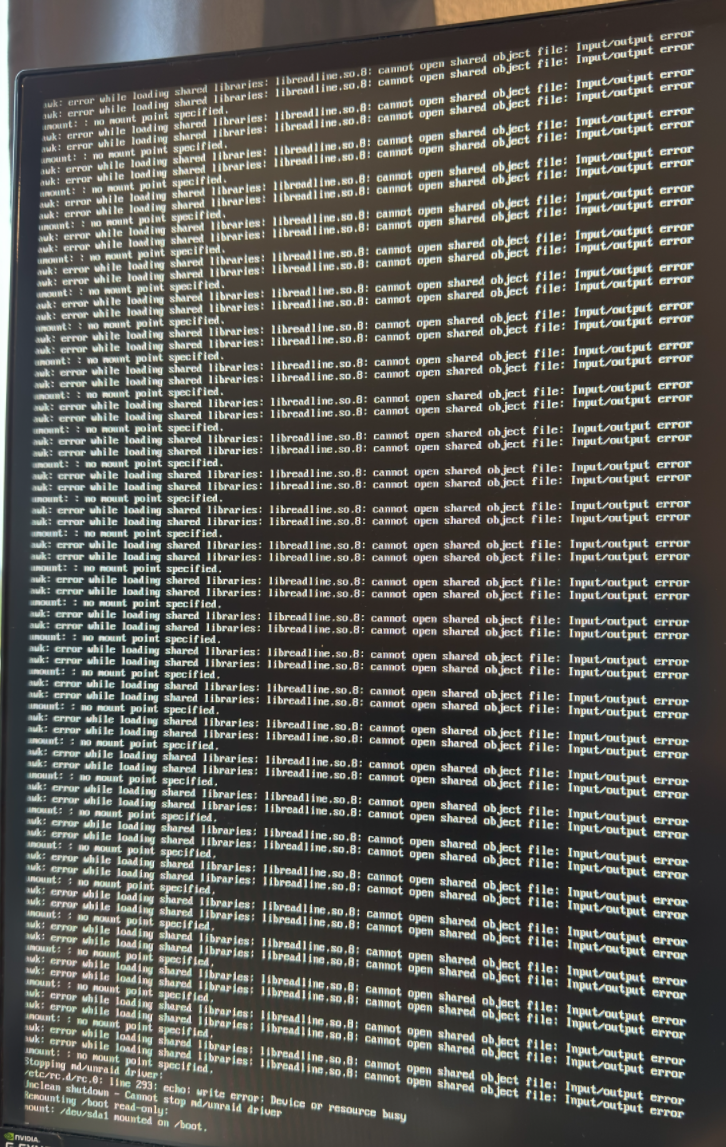

I will also attach a picture of the monitor that is hooked up to the server so you can see the error messages its having while its crashed.

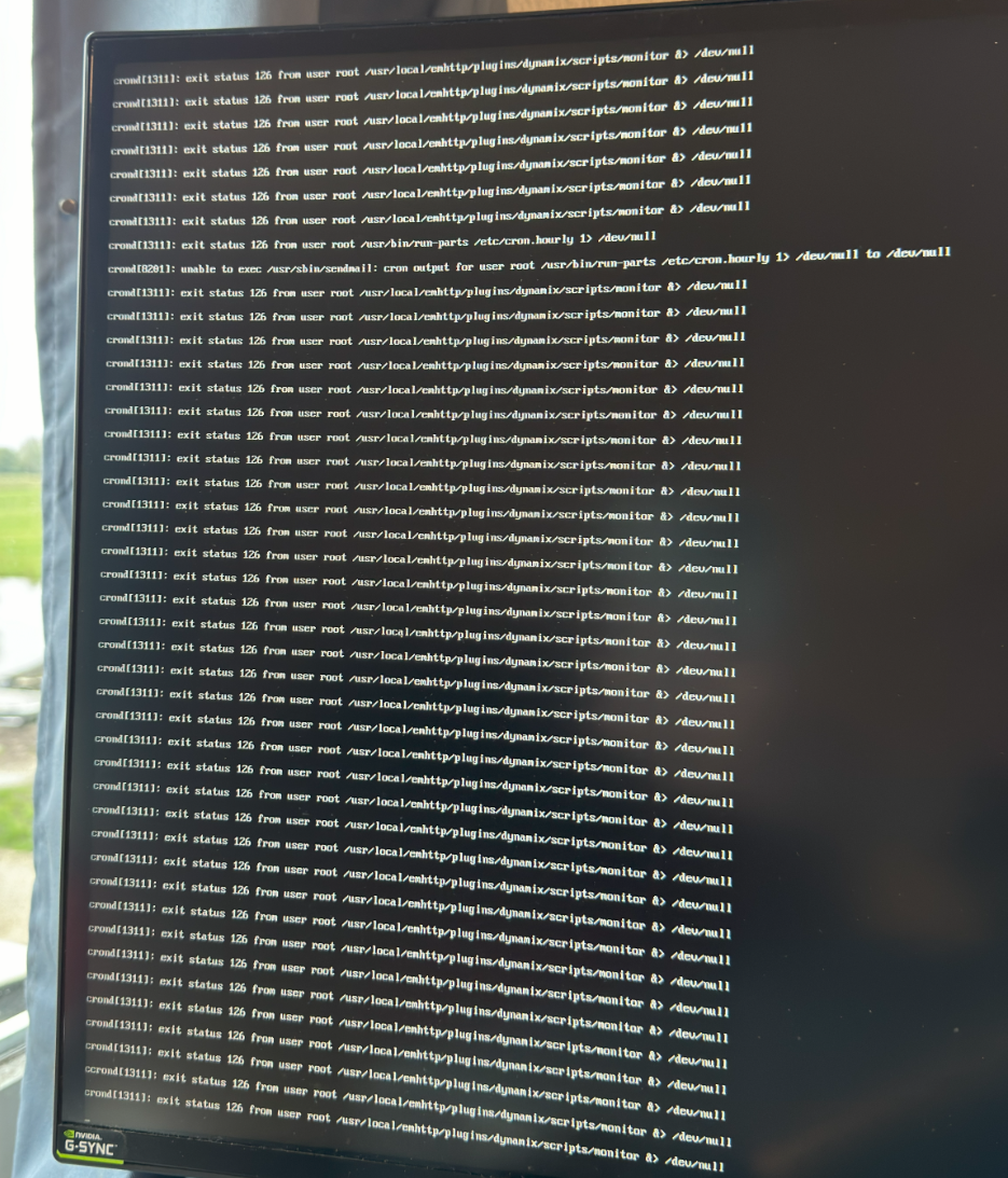

and another pricture of the screen when i was shutting it down by short pressing the power button.
crash.thumb.png.65aef18a6d2ead8180705866035b7a3a.pngshutdownimg.thumb.png.48300d729175eda9ec8ad1ef386b4105.png This is when i shut the server down
