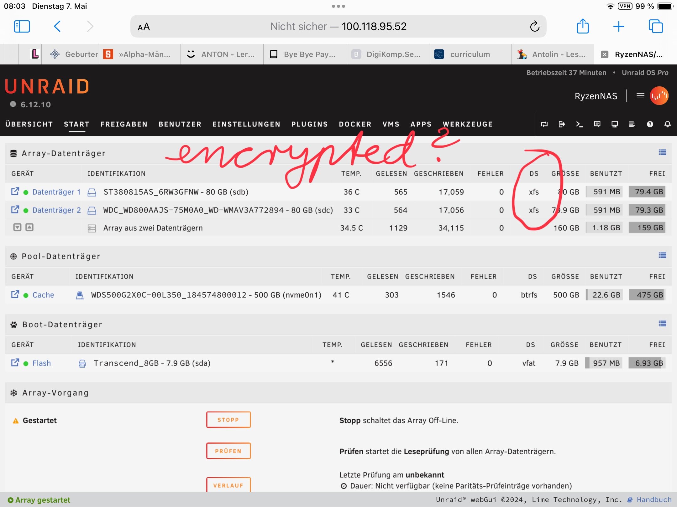

are unpaid array drives encrypted by default? or can I just pull them out of the array and access files on another computer?

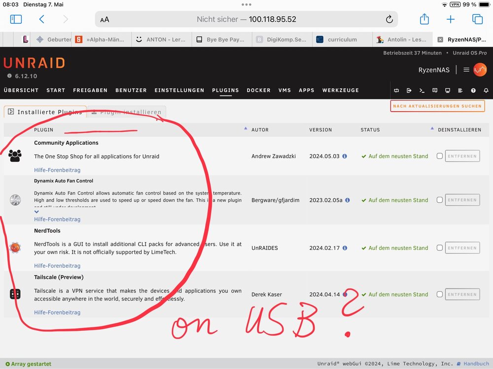

I noticed that my cache drive was also formatted when starting the array. where are the plugins saved to when not the cache drive? are the on the usb drive?

Drives are only encrypted when you set them to be encrypted before formatting them.   Unraid uses standard Linux encryption so even when encrypted they can be read on any Linux system if you can provide the key.
Formatting is not automatic and only happens when you decided to use the Format option after starting the array and it would list the drives about to be formatted.   I assume you did not notice that the cache pool was amongst those listed.   Note that Unraid does not require you to have a pool - this is optional although frequently done for performance reasons.
Plugins are stored on the flash drive along with all your settings, and loaded into RAM along with the main Unraid OS as part of the boot process.
So I will format again with encrypted XFS and I will remove the cache drive from the pool, right?
Assuming you want encryption?   It is worth pointing out that encryption can compromise the ability to recover without data loss if you have harware issues with your system.
