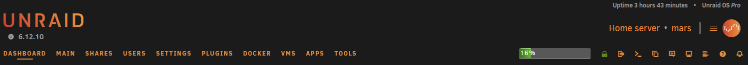

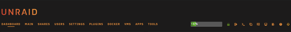

The version number, details, Connect, and Update sections on the top right are completely missing.
But when I tested it in Incognito mode, it seemed to show up just fine. I have also turned off all my adblockers and other possible extensions that may cause conflicts, but it still doesn't seem to work.
What it looks like on regular Chrome and Brave:
What it looks like in Incognito mode for both browsers:

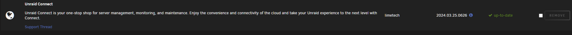

Make sure you are using the latest Connect plugin release.
Yup already updated it and still have the issue. Also, it isn't just Connect that is affected there are other text like version number, uptime, etc missing. But on Incognito it all shows up normally.
