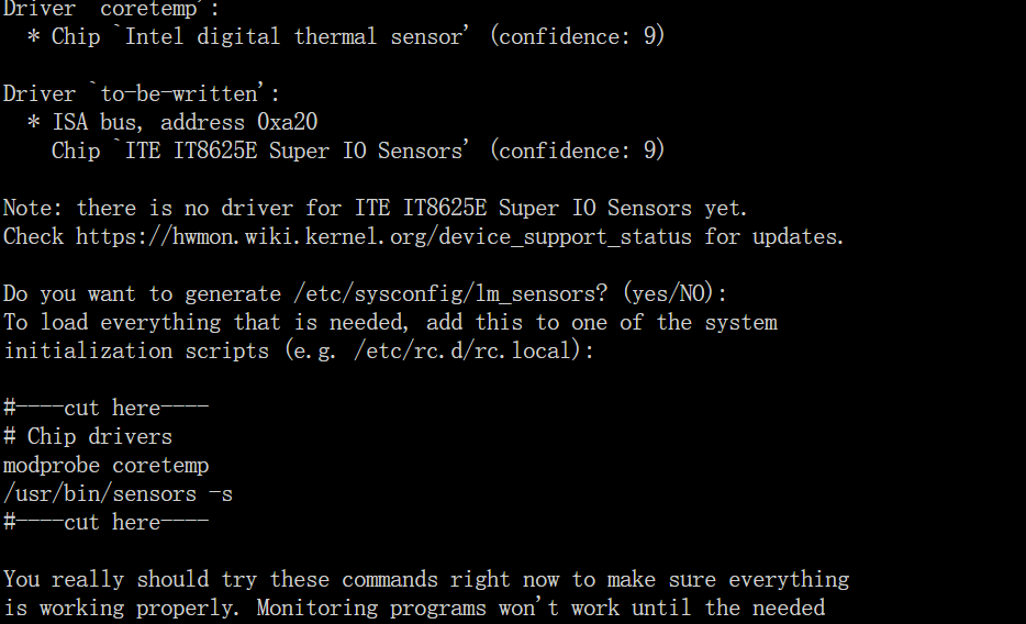

run:
sensors-detect
reply to Y
at  end type sensors
You may need to use an extra module lm87.
You can load it with modprobe lm87.
And for reboot survival you need to add it to system devicse / script / go file...

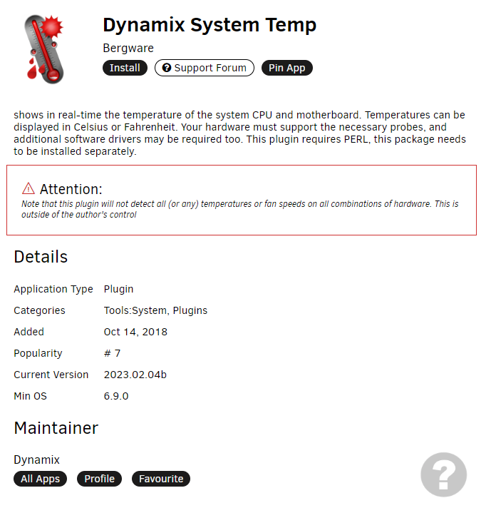

Otherwise try plugins ex:
