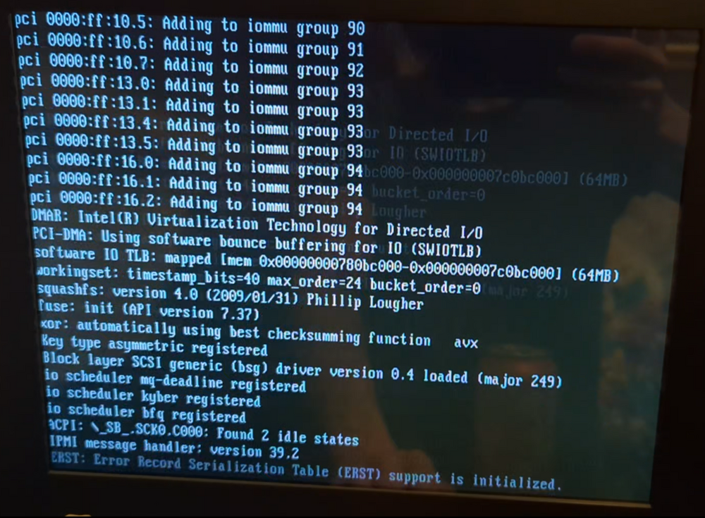

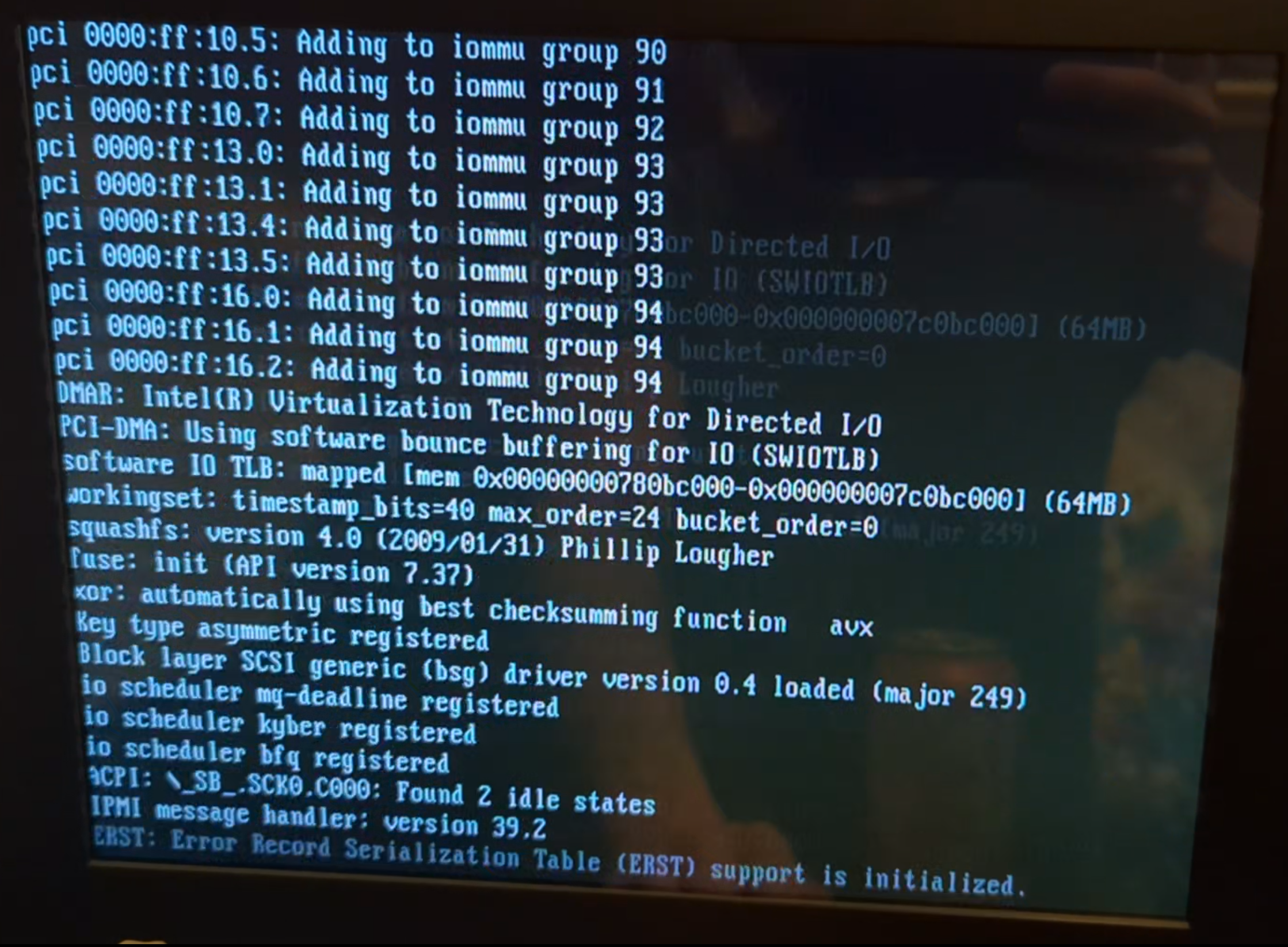

Well..... I highly doubt it is the USB unless a file in the config folder is corrupt. I did a fresh install on a new usb drive that was confirmed genuine by the manufacturer and the error on boot is the same. I then tried booting from a different USB slot with the original usb drive and the error persists. This is either something in the config folder that's messed up somehow. I am sorting through the video of the boot to see if I can find what's right above this. It paused here for a few seconds and I had time to snap a quick photo. Any ideas at all?
The first photo is the very last frame before the "errors" in the second photo fly by.

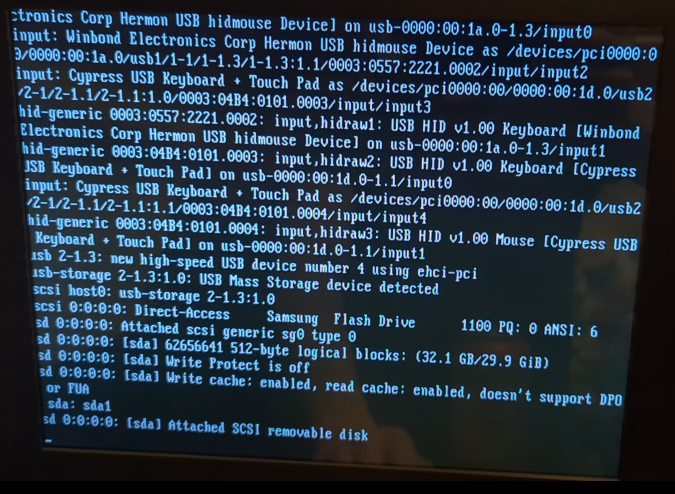

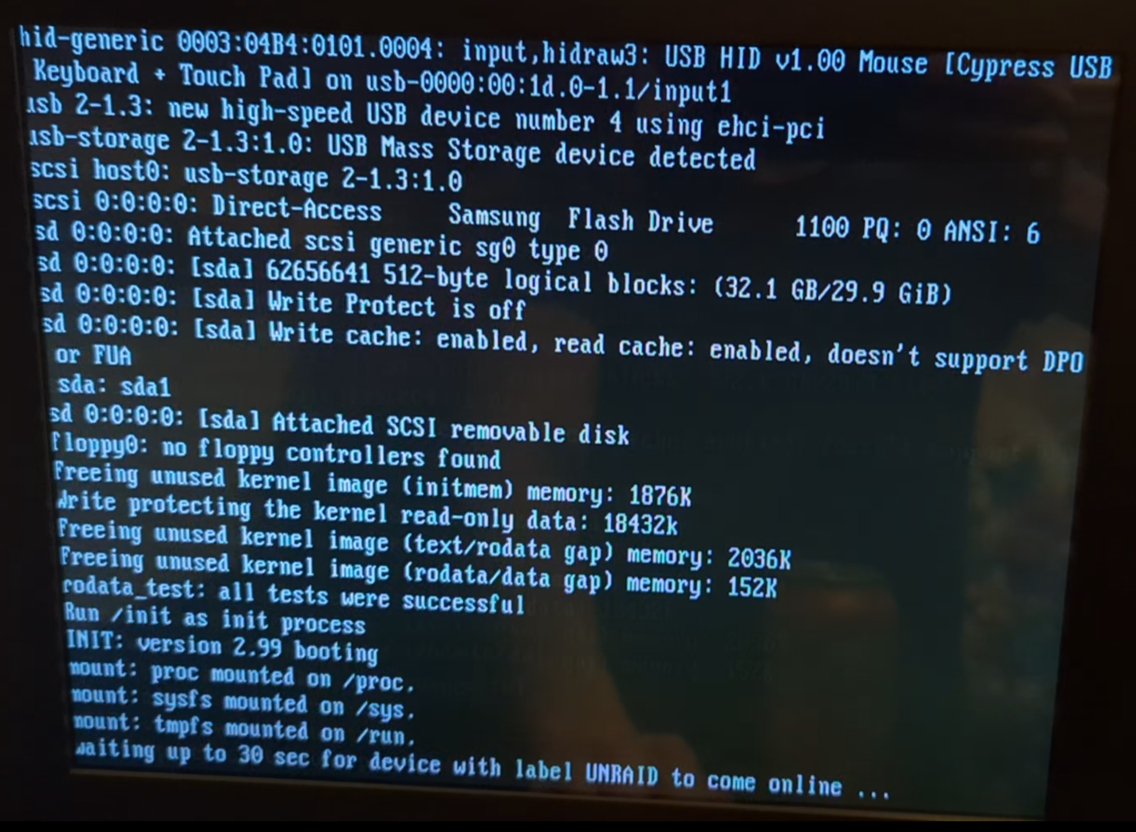

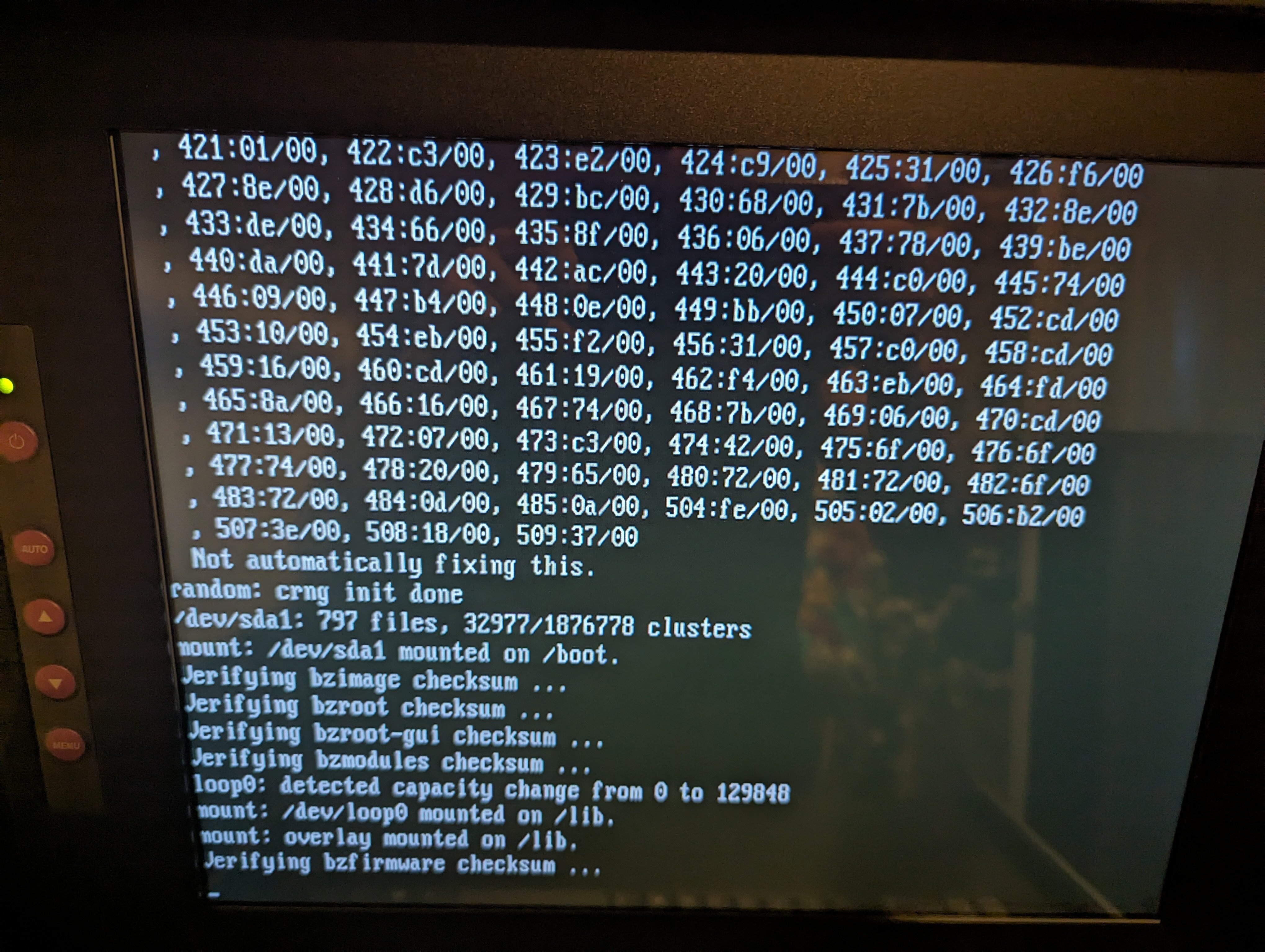

Here are some more shots.

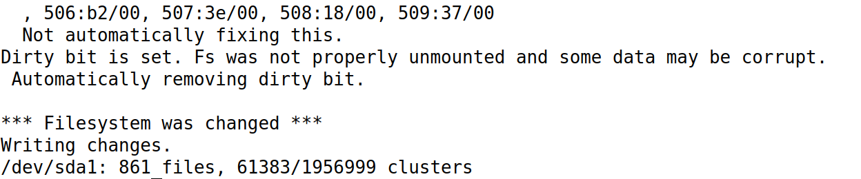

This doesn't really have to do with why the system went down, but perhaps a side effect of it going down uncleanly.
lsscsi to get list of devices
Confirm your device and run the following in your unraid terminal
fsck -y /dev/sda1
I got this from reddit:
Here is my result
