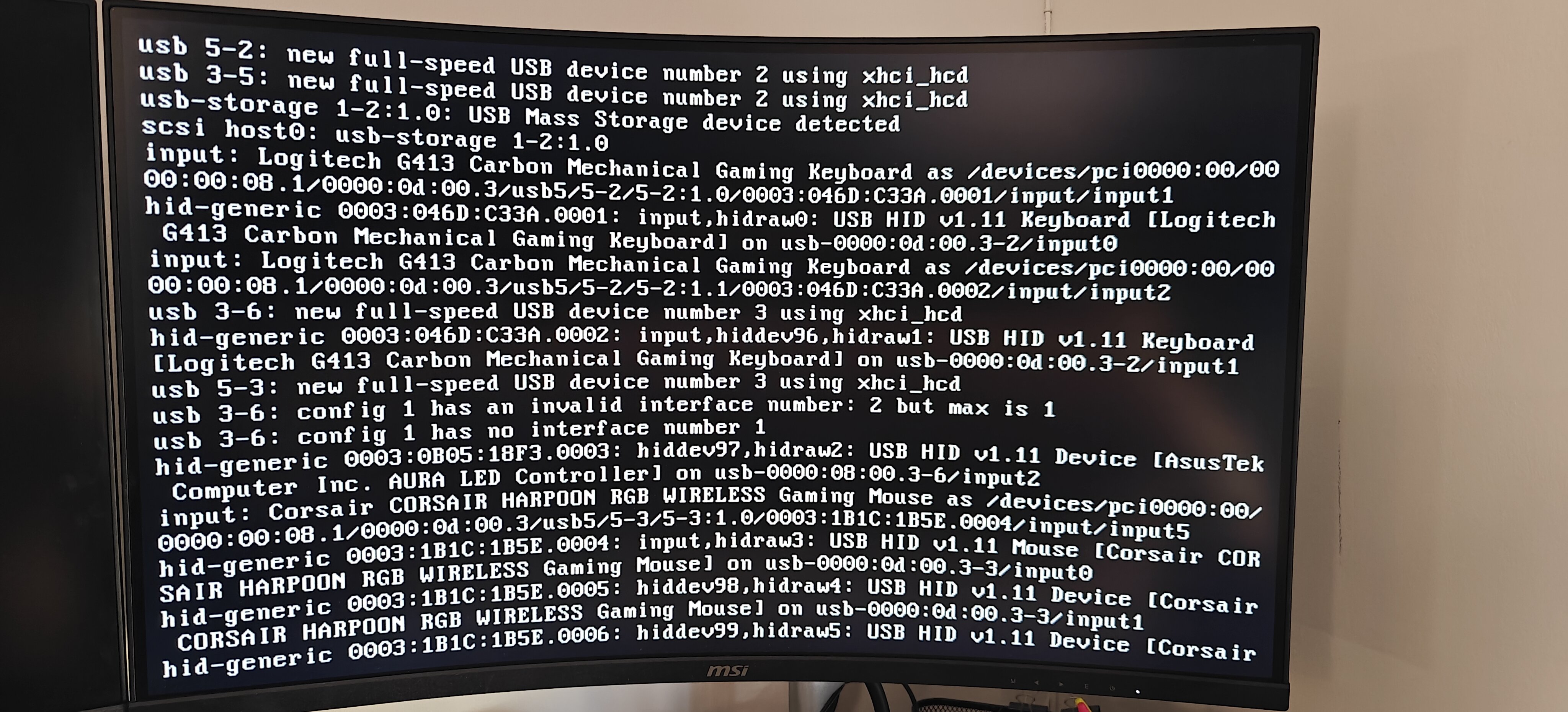

Woke up this morning to this screen.  I've tried restarted.  Going into safe boot. It always gets stuck here.  I did notice one time something about a possible file corruption due to fs not being shut down properly.
Hope someone can assist.

my ident.cfg file is corrupt. Apparently we had a power outage that must have caused this. What can I do so I don't lose my entire system and library of everything?
ident.cfg is just a text file, like most of the config files. You can extract just that file from the latest download from https://docs.unraid.net/unraid-os/download_list/ and edit it, if you don't remember customizing the entry in the file just leave it as default, you can change things after you boot.

When I was making a copy of the folder it gave me an error saying this file is corrupt and can't be copied.  Everything else copies just fine. So I can just delete that file and try booting again basically?

No, I'd replace it with a stock file extracted from the download I listed above. You can edit it and change the server name to what you had before instead of "Tower" if you want.
I made a new USB and copied my old config folder. Still had same issue. I disconnected ALL USB devices I had plugged into the tower and it booted up no problem. Now just working on getting everything reconnected.  I did take a new ident.cfg file from the fresh install config folder though. Thanks for the help.
