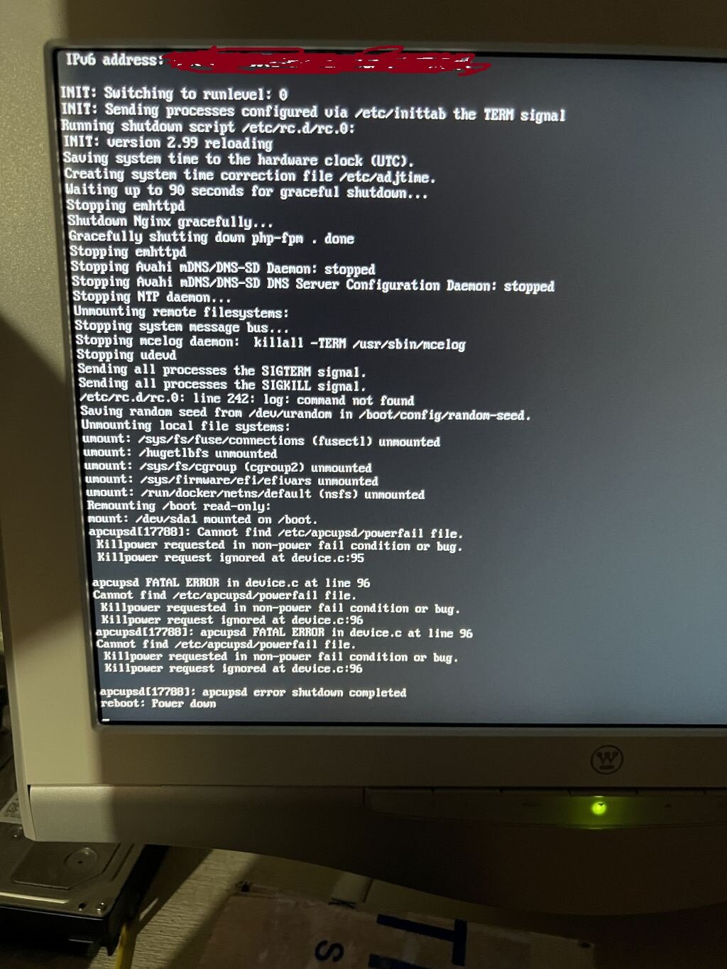

I am randomly unable to do a shutdown or reboot in Unraid successfully requiring me to physically hold the power button to force power off the server.  It appears to be failing on a missing file in "/etc/apcupsd/powerfail" but do to my lack of much Linux knowledge this rabbit hole is endless for me.  I did manage to snap a photo of the error which I have attached.
I currently have a Smart-UPS 1500 attached via USB to unraid 6.12.10.

Does anyone have any insight to this? I'm running APC Back-UPS 1400VA and seeing effectively same error during normal (i.e. not a power event) Unraid shutdown. Cannot see these errors in syslog.
Quite sure this is also what causes the shutdown procedure to take over one minute. Running 6.12.13

I'm having the same issue.
I haven't had an issue when shutting down from the web interface.
However after a power failure my Unraid box would not shutdown properly and required a parity check.
Recently I tested a shutdown using the powerbutton and it hung on the error as per this photo.
Hitting the power button after waiting a while shutdown successfully.
Leaving this comment here in hope someone can provide a solution at some point.
