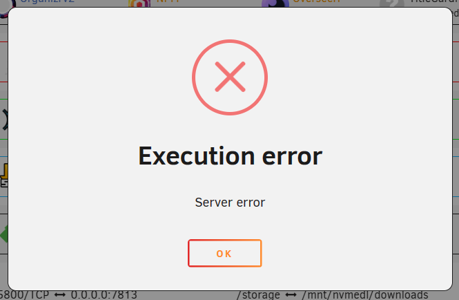

Entire folder directories become unresponsive
Between 4-18hrs after server start, my entire folder structure becomes unresponsive and I cannot start or stop Docker services and get the following error
My Plex server becomes unresponsive, but all other apps like Sonarr UI loads, but can't import/delete/access any files as the storage system is locked up. The only thing thats fixes this is a hard reboot of the server, which is not practical to do multiple times per day. It can go anywhere from 4-18hours without doing it, before being stuck in this state again.

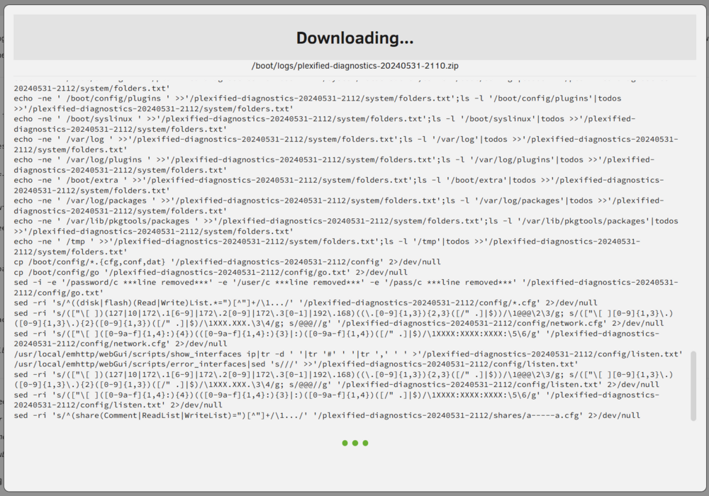

When running diagnostics download it gets stuck on
sed -ri 's/^(share(Comment|ReadList|WriteList)=")[^"]+/\1.../' '/plexified-diagnostics-20240513-0907/shares/a-----a.cfg' 2>/dev/null

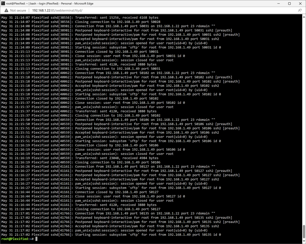

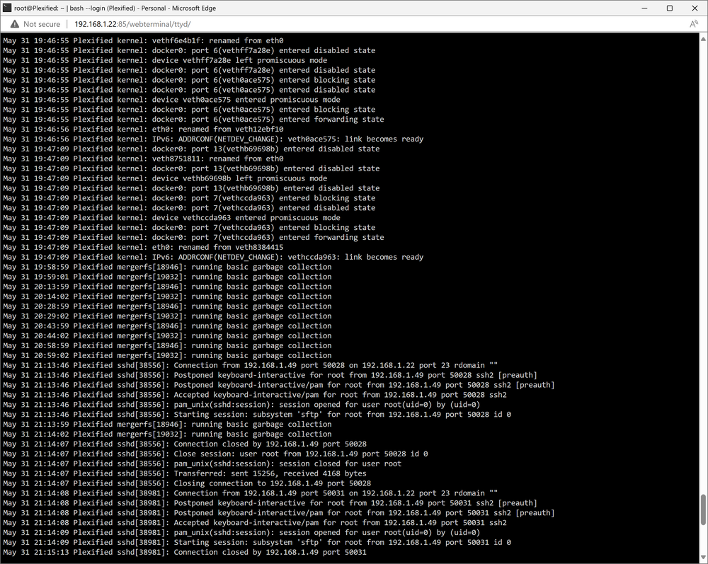

Okay so server restarted again. I can't access UI but can SSH, and when running "diagnostics" it just sticks on;
root@Plexified:/mnt# diagnostics
Starting diagnostics collection...
Could this be a case of a failing flash drive? or bad files on flash drive?
/mnt is once again inaccessible.
