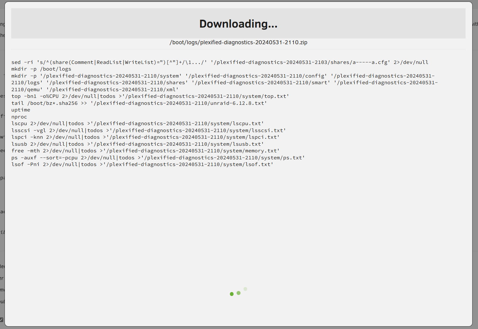

Managed to get this off the flash drive in /boot/logs

It has just happened again after almost 12 days of uptime.

Okay, so I've just tried running the first one
df -h
And my ssh window is hanging atm. Has been for around 3minutes now

That's what I get when I run cat /etc/mtab
The other two just hang without an output.
Edited by thatja
Getting Diagnostics through the Ui also freezes
And also trying to get them via "diagnostics" inside ssh also just hangs
Just now, Rysz said:
Can you try: df -h /
/mnt is completely inaccessible aswel
Just now, thatja said:
Ok, that rules out the theory of a full rootfs ramdisk. Did you test your RAM sticks with memtest in the meantime?
