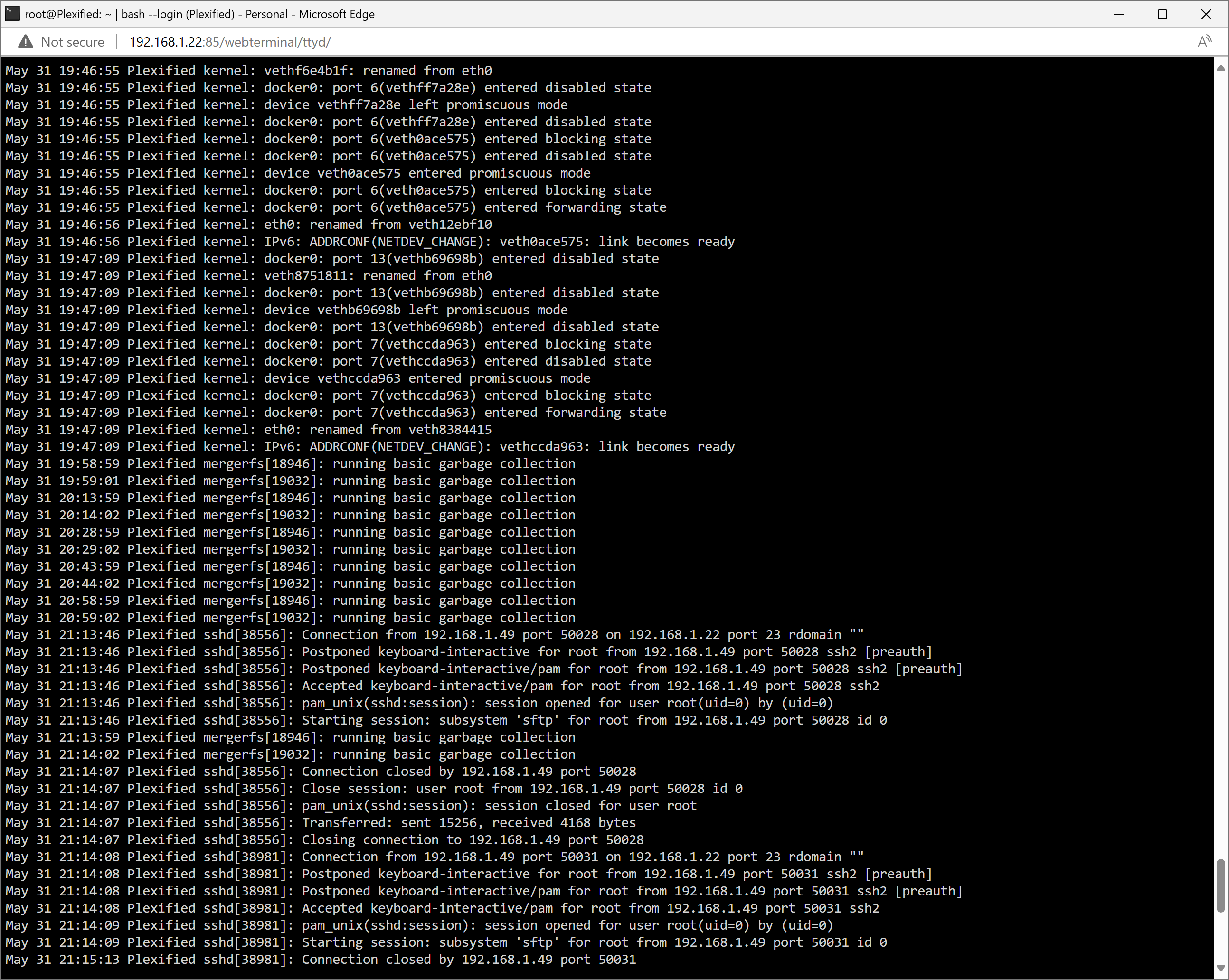

  • It may well be, I just wanted the user to test without mergefs to rule that out, since there's nothing else relevant logged that I can see that would explain folders going away.
  • Funny you should mention GPU driver, it did update a couple hours before this first outage occurred. I will try going back one driver!
  • Post a new syslog in case there's something there now.

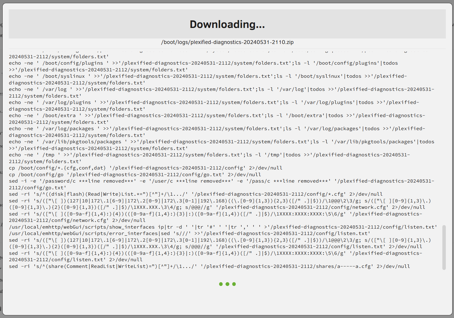

Diagnostics is stuck on this stage

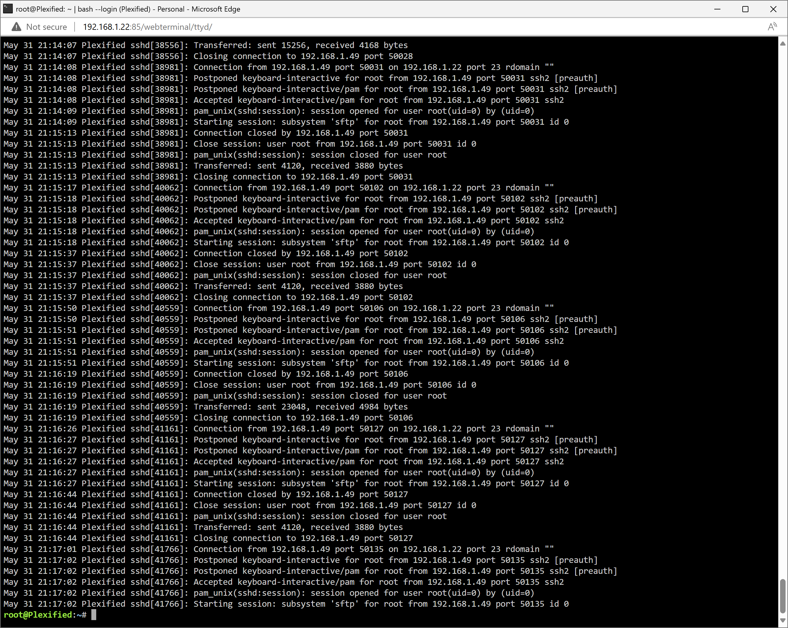

Server crashed around 21:00-21:15ish
Edited by thatja
1 minute ago, thatja said:
Server crashed around 21:00ish
Nothing stands out, I honestly have no idea. 😞
