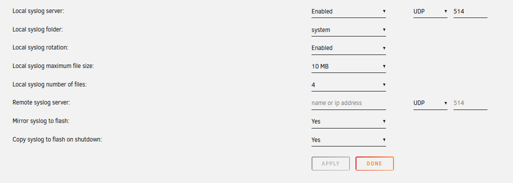

Is any another option to syslog write on flash and deepper logging?
here is my syslog option.
syslog
