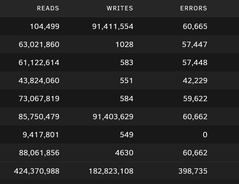

Two weeks ago, I noticed what I thought was a bad drive. I replaced it with a brand new 18TB WD Gold drive (pre-cleared fine) and rebuilt the array. I woke up this morning to over 390,000 errors on nearly every drive but one. After only having the array rebuilt for a day or so.
Do you have any idea what is going on and how to fix it?
I have attached my diagnostics and am thankful for any assistance provided. I have never had something like this happen. The screenshot below is something that shows up know for every drive, but the one drive that doesn't have any errors (super old 1TB WD Black drive).

Syslog already rotated so we cannot see the beginning of the problem, but looks like a controller issue, reboot and post new diags after array start.
