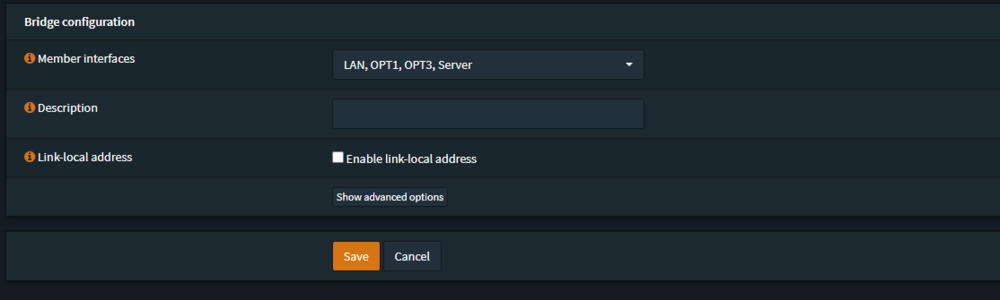

It still shows online when the 2.5G port was unplugged (this reset not anymore, but that's probably because bridging was disabled). The 10G port is straight out of my firewall's bridge as I don't have a 10G switch yet (ix1 bridged to igc1, and LAN is the bridge - showing a picture of that).
igc means 2.5G and ix1 is 10G ? But why ix1 was linkdown ?

I am an idiot thank you for helping me narrow it down to the firewall. I learned today FreeBSD handles the bridge members thru the packet filter rather then the bridging interface went into tunable and changed net.link.bridge.pfil_member to 0 (off) and net.link.bridge.pfil_bridge (on) which changes the member iterfaces of the packet filter to the full on packet interface.
