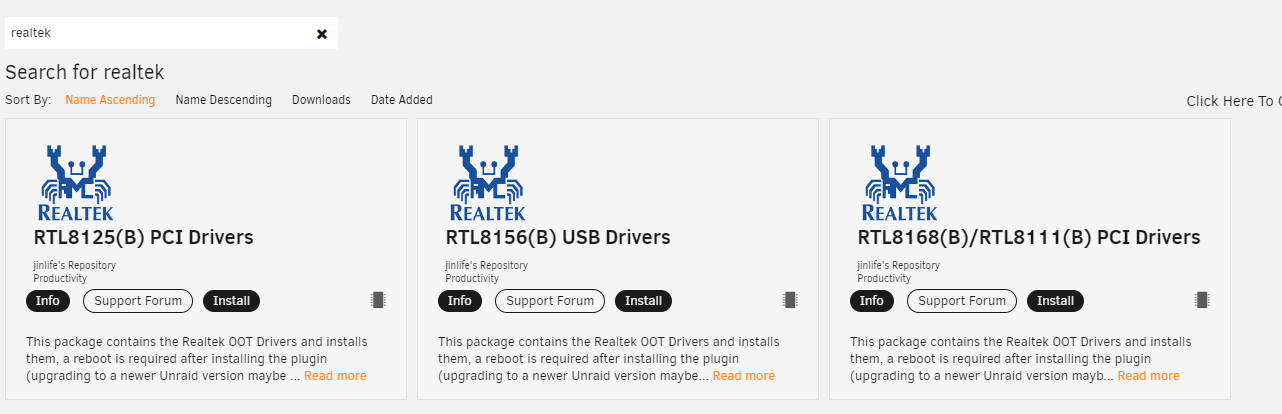

there is a known issue with unraid kernal and those relteck nics.
Something on th lines of:
If you have br0 and bond0 there is a linux issues with MTU as a 2.5 GB nic may not support 1000 / 100 / 10 base-t.
Please install the realtek plugin and see if that helps. I believe you want the 1st option:

I have that Realtek plugin installed already.

thank you for that clarification. The diagnostic didn't show that plugin instaled/enabled, but did show the modprobe of disabling Unraids realtek kernal driver.
