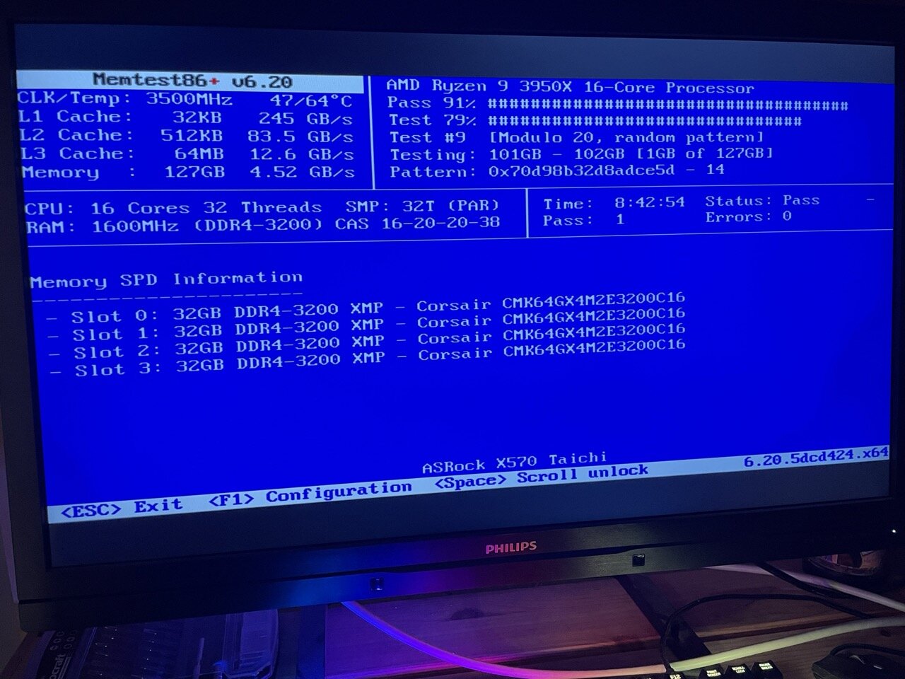

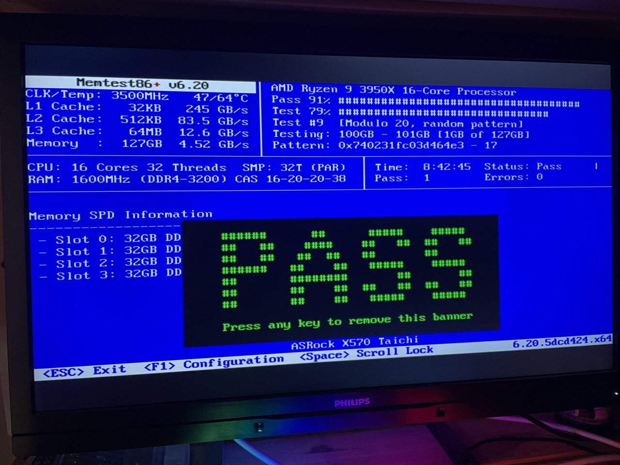

OK, will start by running memtest tonight.
