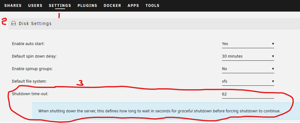

Determine the time to stop the array.  Add 10-20% to that number.  Now go to   SETTINGS  >>>  Disk Settings     and look for this parameter:
Enter that number you just calculated and 'Apply' and 'Done'.
I've timed it and calculated 10% to it.
I came out on 127 secs, so replaced that to my Shutdown time-out value.
Now I go to main and reboot, and I get immediately System is going down for reboot.
Could it be that that new value fixed it?
I doubt it.  Did you restart the array before you tried to reboot?   The parameter tells Unraid to wait for that period of time for the array to stop before it forces a shutdown.  If Unraid has to force a shutdown, it will be an unclean shutdown and parity will be rebuilt when the server comes back up.  (Before this parameter was added, Unraid would wait FOREVER for the array to stop.  As I recall, there was considerable discussion about this issue as sometimes server access was an issue and the unclean shutdown was deemed preferable to having to gain access to the server to force a shutdown.  The problem of the array not stopping is generally caused by a plugin or Docker container that doesn't close a file when it receives a request to do so!)
EDIT:  What I did when there was an issue in one of the 6.12.X release with the array not stopping is that I manually stopped all of the Docker containers.  Then I manually stopped the array.  When the array had stopped, I then rebooted the server.  However, I believe the issue has been fixed in ver6.12.10.
