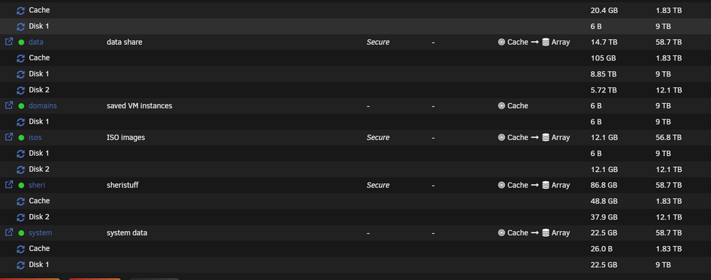

Layout:

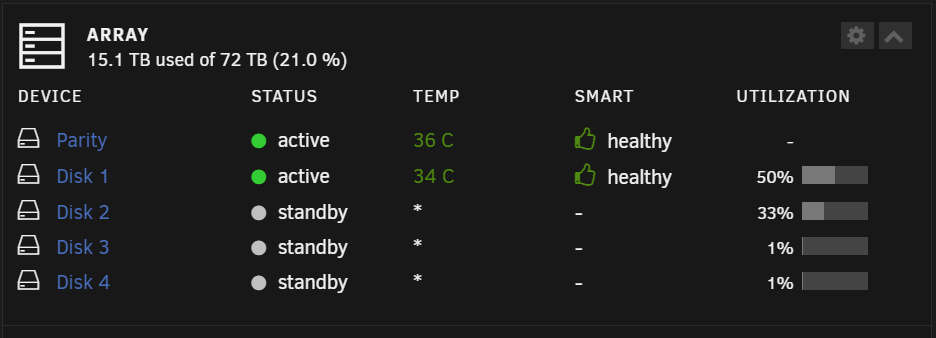

These are the 2 drives that always spin back up :

Looks like the docker.img file (in the system share) is on disk1.   That means that any time the docker service is running those two drives will be spun up.  Ideally you want all of the 'system' share to be on the cache both for best performance, and also to let the array drives spin down.

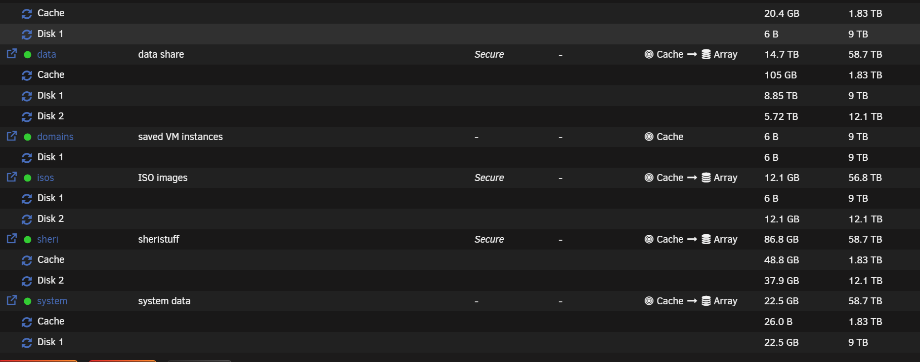

Ok I changed System to be cache, Stopped all the containers, enabled the mover. Once the mover was complete I enabled the dockers again. But I see its still utilizing disk1. Is there something I should do to ensure that docker.img is in cache and not on disk 1?
I also tried these steps:
except for exclusive.
From what I can tell it didnt move the docker.img to cache
/mnt/cache/system/docker# ls -lah
total 0
drwxr-xr-x 1 root   root   0 May  7 09:07 ./
drwxrwxrwx 1 nobody users 26 May  7 09:07 ../

@itimpi finally started working. Now all drives spin down thanks for the help it just took a while.  I think the issue ended up being the system share didnt get moved to cache or didnt finish.
