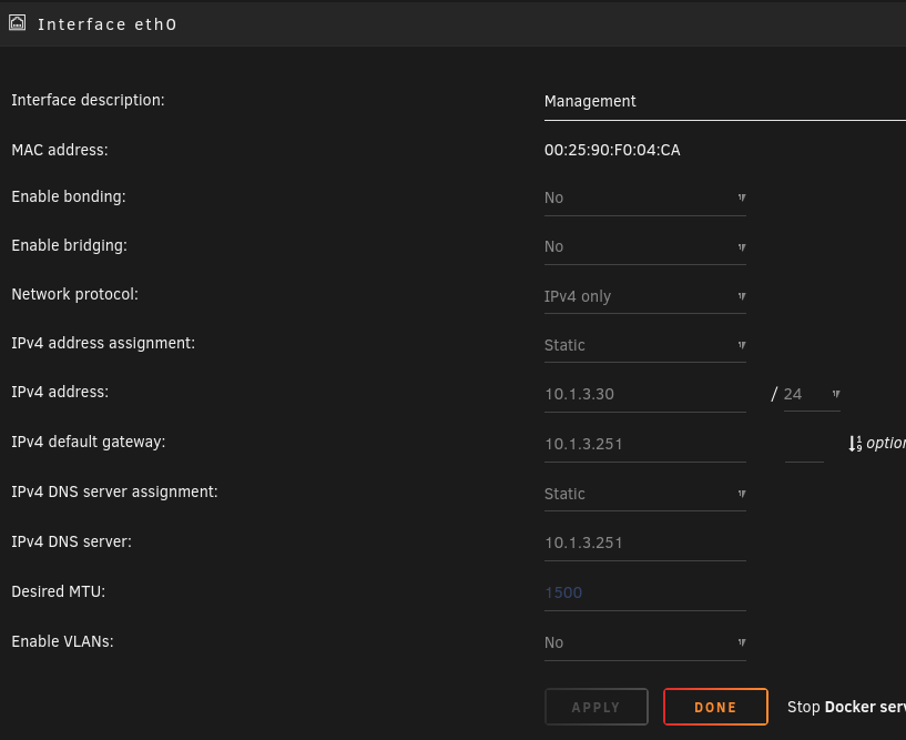

The server, apart from the dedicated IPMI interface has two RJ45 adapters (eth0, eth1) and I did put a 10GBe mlx_4 PCIE card (eth2) on it. It was already in use before, in the previous system in the desired configuration.
My intention is running the following configuration:

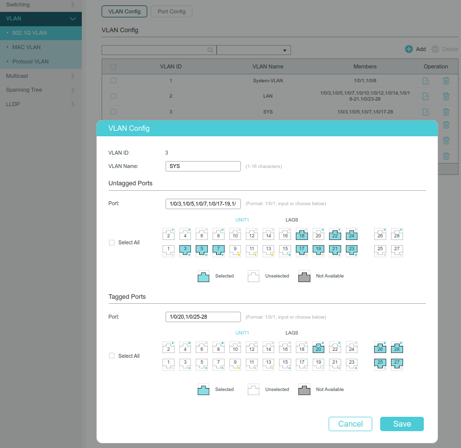

eth0 port as a management network at vlan 3. It is connected to an untagged port at id 3.
eth2 connected to a trunk switch port configured (tagged) for vlans 2 and 5. (untagged or main vlan for this port is 3)

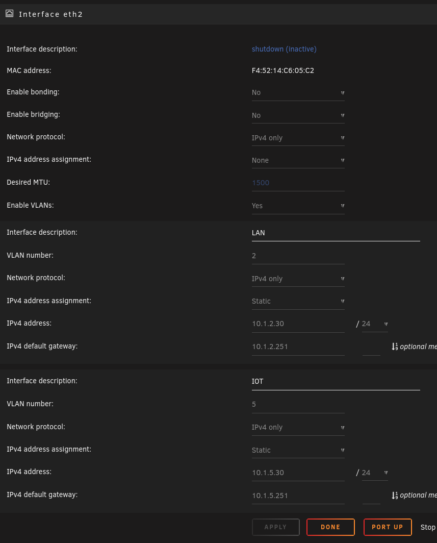

I have configured the following settings:
As you can see, I have to leave the eth2 interface disabled, because when it is online, all network connections reset after some seconds.
So if I access the Krusader container GUI, it's frozen after some seconds. If I establish a SSH session, it's closed after some seconds. 1-2 minutes aprox.
What's the problem?

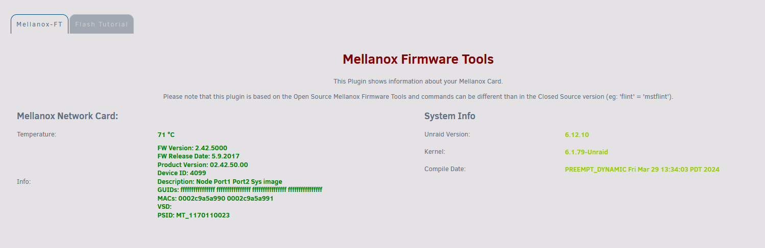

Install the plugin "mellanox firmware tools" and check the settings
Keep an eye on your FW Version. If it is below 2.42.5000 you will need to update it before you can proceed (yeah, those nasty resets...) The plugin will provide the
download links and the flash tools for you. Follow the orders.

Thank you very much @MAM59, that's a good amount of info. I'll proceed by steps. I'm still doing the data transfer from the disks and can't afford a dropout.
I've installed the plugin and that's the output:
Mellanox Network Card:
Temperature:         62 °C
Info:
	FW Version:      2.31.1602
	FW Release Date: 9.11.2014
	Product Version: 02.31.16.02
	Rom Info:        type=PXE version=3.4.225 proto=ETH
                     type=UEFI version=10.3.39 proto=ETH
	Device ID:       4099
	Description:     Node Port1 Port2 Sys image
	GUIDs:           ffffffffffffffff ffffffffffffffff ffffffffffffffff ffffffffffffffff
	MACs:            REDACTED REDACTED
	VSD:
	PSID:            MT_1270112023

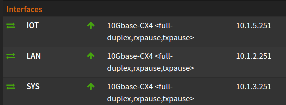

I have an opnsense router implemented. Just migrated from pfsense as recent updates broke my installation and I got tired. That router manages all the inter-vlan and wan isolation. Also I have two more servers with Proxmox.
Yeah, this definatly needs an update. If you worry why it worked without on other OSs: it depends on the driver. Some of them contain everything by themselfs, others, like UNRAIDS offload many tasks to the firmware of the card. They only have a mini-driver. Therefor you need to keep the firmware recent.
But BEWARE; there are many many versions of these cards out there, be sure to download and flash the CORRECT one! Keep the PSID in mind it will lead you to the correct driver on the download page.
(if you flash the wrong one, you could brick the card. Flashing under Windows does not work anymore since Win7. Do it from this plugin in UNRAID)

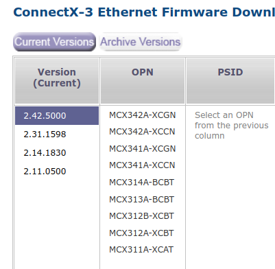

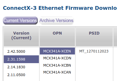

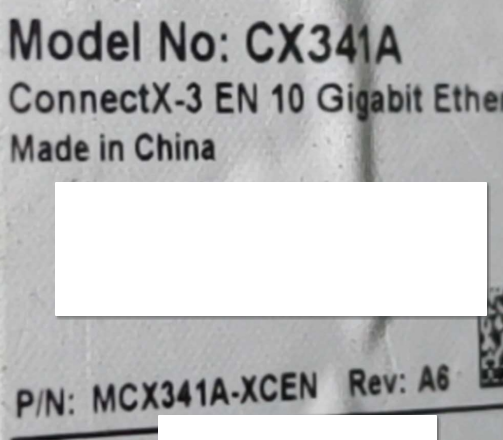

I'm afraid that there's no newer firmware for my card. In fact, it appears that I have one newer than the manufacturer 🫣
image.png.a36bfe211bca2f08bb8645813460a43e.pngimage.png.fba90e074824eae9b95280c404459484.png
hmm... strange... i am not really a mellanox specialist, dunno the differences between -XCEN and -XCCN.
Maybe somebody here can offer deeper info. Or, ask the author of the plugin (support page!) for help.
As far as I know, 2.42.5000 was available for ALL X3 cards, but again, I maybe wrong...

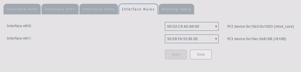

Excuse me @MAM59. How I must do the network change you told me first?
As soon as I change the rules, it asks for reboot. And then it loses connection.
I had to psysically reach the server and alter the rules config file to revert the change and reboot.

This is normal, because the interfaces change you have to change the cables too (considering your switch and or firewall are configured to those ports). Or change the network config.
What was eth2 before is now eth0, cards change, config stays. So without changing the config the vlans are now on the wrong ports.
If I would be you, I would delete all network, make the mellanox eth0, reboot and start from scratch (attaching the mellanox to a port without restrictions).

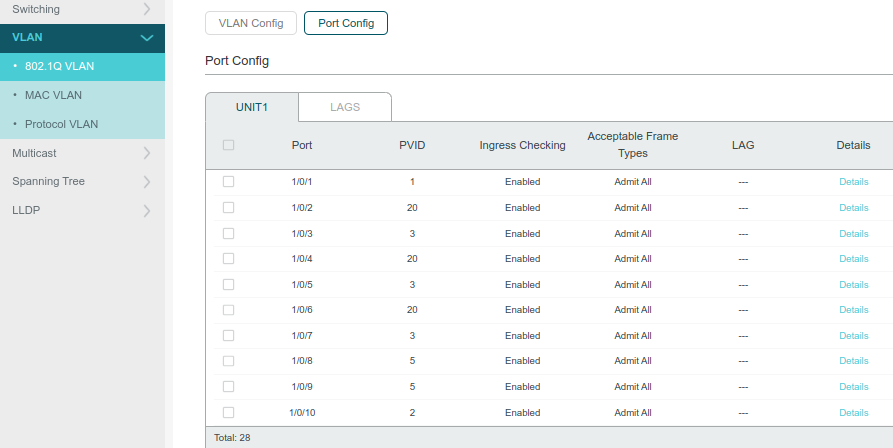

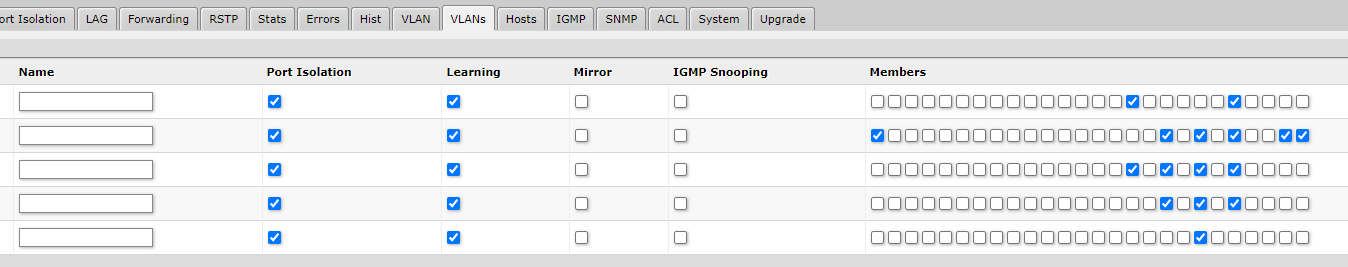

     The 10Gb link: vlan id 3, Tagged for 2, 3, 5.
     The RJ45_1 link: vlan id 3, Untagged for 3.
I'm a developer, not a networking technician. But when I bought this router it was different to the one I had before. For a port to be a "client" one, you must give it the id of the target lan and untag it for that vlan. That means that will only accept untagged frames, (all, because the device is not configured for vlans) and will be tagged for the vlan.
Then a trunk must be given the id of the main/default vlan, and then tag all the vlans that will accept. It will accept only tagged frames.
I'm afraid that it is not possible to disable inter-vlan routing at my router. My systems would stop working.
The main problem is that I think that my NAS should be at the LAN. Because I understand that the users storage function is more important than media storage. But that media storage must be served to the media devices, the TV for example, the services and players that organize and serve the content, all of them are on the IOT vlan.
And I want a good bandwidth for my storage, but is also needed for the media.

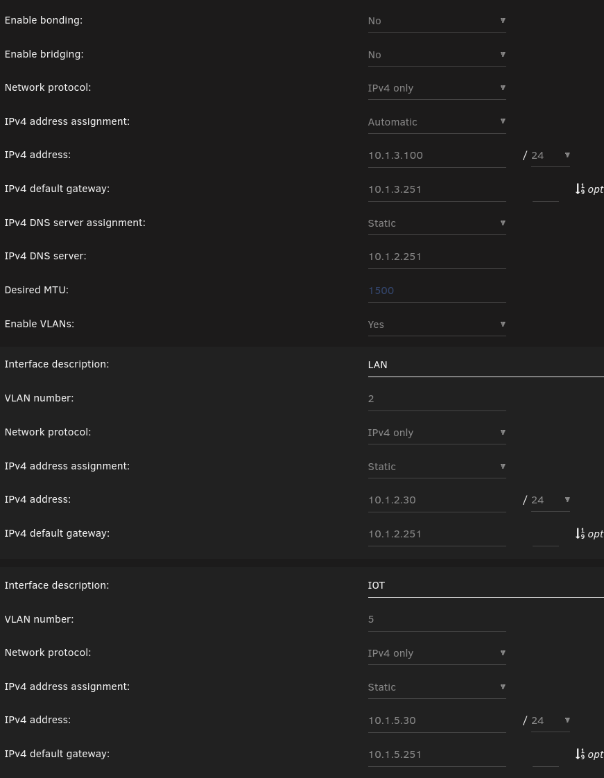

Now, I have the interfaces configured as:
Interface eth0
Interface description: (RJ45 1GB Untagged 3)
MAC address: REDACTED
Enable bonding: No
Enable bridging: No
Network protocol: IPv4 only
IPv4 address assignment: Static
IPv4 address: 10.1.3.20/24
IPv4 default gateway:10.1.3.251
IPv4 DNS server assignment: Static
IPv4 DNS server: 10.1.3.251
Enable VLANs: Yes
Interface eth1: Shutdown (Inactive)
Interface eth2
Interface description: (Mellanox 10Gb DAC Trunk)
Enable bonding: No
Enable bridging: No
IPv4 address assignment: None
Enable VLANs: Yes
Interface description: LAN
VLAN number: 2
IPv4 address: 10.1.2.30/24
IPv4 default gateway: 10.1.2.251
Interface description: IOT
VLAN number: 5
IPv4 address: 10.1.5.30/24
IPv4 default gateway: 10.1.5.251
The problems I see: Vlan is active for eth0, but I can't remove the main Ip configuration. I know that this combination is wrong and is the cause that I don't have communication on this interface. But the other works without interruptions.

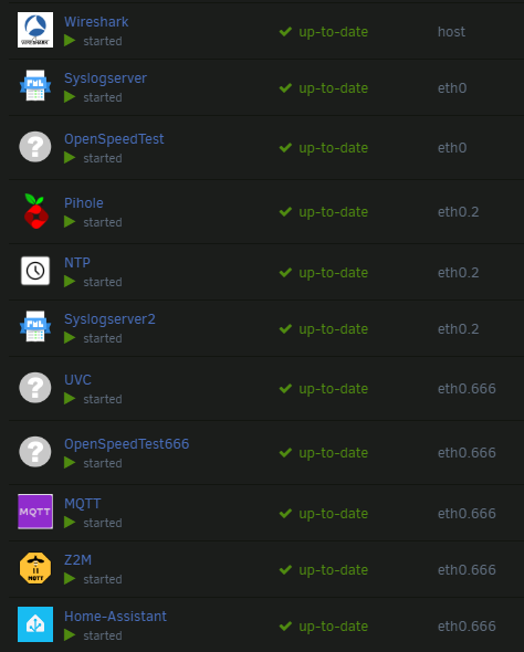

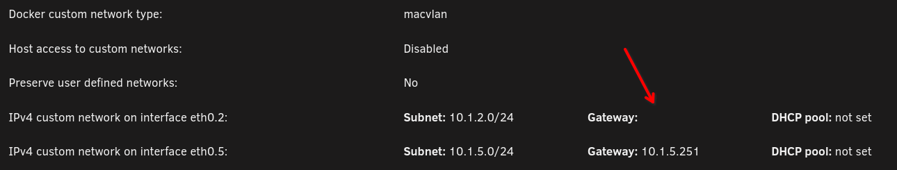

If I configure a container to be linked to a vlan on eth2, the container loses communication.
This doesn't work.
Can anyone help me configuring the network, so I can have containers on IOT and LAN and I serve files on both LAN and IOT?

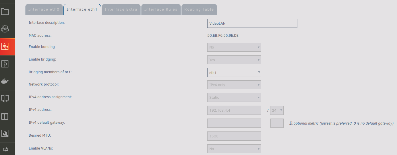

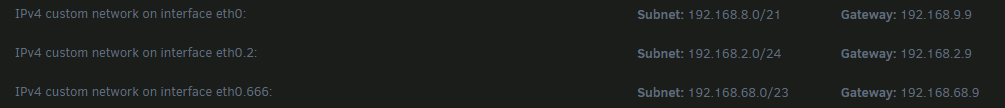

I have a very limited "need" for VLANs here: I have "normal" devices on the main LAN, and there is a "Video LAN" seperated for SAT-IP Devices (which are very sensible for LAN Delays).
I do this in one single switch, assigning Ports 1-8 to the Video LAN and the rest of the ports to the main LAN. All untagged, no need for tagging.

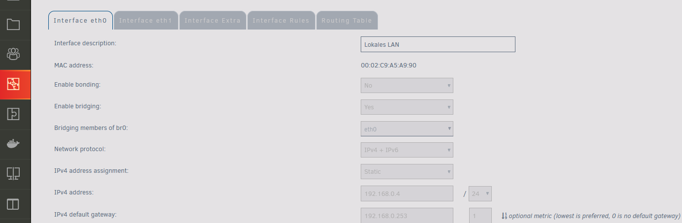

is simple. looks simple:
Every device that I put in Ports 1-8 immediatly joins the "Video LAN", others go to "Main LAN". (Note, the Mellanox goes to a different Switch with 10G of course, but that is connected to one of the ports 9-24 of this 1G switch)
On Unraid I use 2 LAN Cards, one Mellanox for the main LAN and one simple 1G Realtek for the Video LAN:
and
Done! thats all! No other Switch or other Computer knows about VLANs!
(note the "missing" default gateway on eth1, it would break a lot of things if it would be filled in)

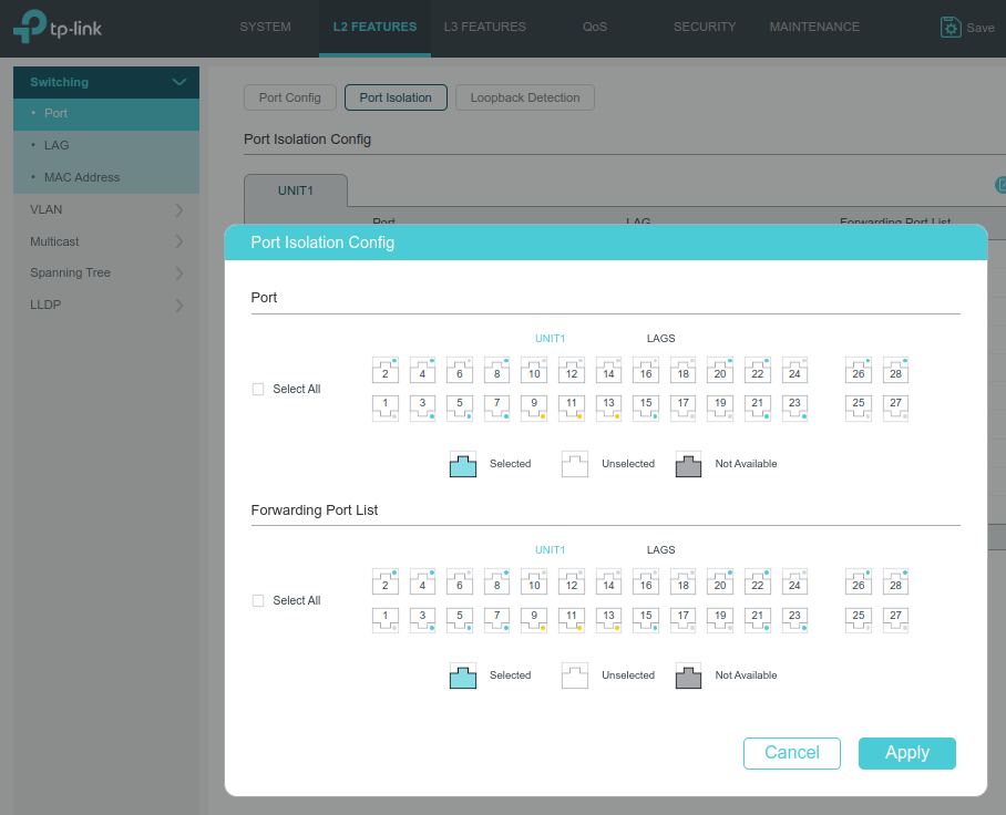

People always think use vlan to seperate things but in other way think they need communicate each other .....
Your Unraid setup haven't problem, just your network environment have problem ( likely looping ) so network down. If you want simple separate stuff, pls try not use tag-base vlan and use port-base vlan + single subnet only.

Perhaps I'm not completely understanding you, but I think that's incorrect. Vlans are isolated (if you want) network segments. You can't specify a gateway from another network into one interface. My switch does not offer inter-vlan routing, so it's the router who does the task. I think you mean that the configuration for an interface in the IOT vlan (5) should be configured this way:
fixed ip: 10.1.5.100
segment 255.255.255.0
gateway: 10.1.2.1 <== the LAN gteway? Perhaps SYS gateway?
There will be no communication to this gateway, if the GUI allows for that.
XXsenses have different gateways for each interface.
We are talking about network gateways here, not internet/wan gateways, right? My network topology has independent switch, router, and internet gateway+modem.
My router has only one gateway, but could be configured with several for redundancy, for example.
With the configuration posted above, but with vlan disabled at eth0, I'm at a somewhat working state. But the interface eth0 is losing communication periodically.
The eth2 interface is rock solid, and I can attach docker containers to each vlan and they're accesible. But they don't resolve DNS queries.
I think it's a problem of dockers configuration from unraid side. But as it works from an image, I don't know how to fine-tune docker configuration for macvlan.
I don't know if this solution is prepared to do virtualization if it can't successfully manage networking. Perhaps I have something wrong.

Yes, It's the same for me. But if you configure a Trunk port, vlans must be tagged. Seems like you don't use trunk ports. I do. That's the only difference.
Also a D-Link was my previous switch. If you change it for a TP-Link in the future, prepare for hair pulling trying to replicate your config. There's something totally inverse vlans that I can't remember, but I almost went crazy.
I've also noticed that you have bridging enabled. Could that affect to docker macvlan? 🤔
Don't get me wrong, but... on the lack of gateway on your 2nd interface... could simply be that you have all your cameras "pointing" to your management device.
I don't know, perhaps it's unraid special with interfaces configuration, but how debian works is that creates a route for each interface such that request from a segment goes to the interface that has the gateway in the same segment. I see nothing strange on it.
If the OS needs to communicate with 10.1.2.10 sends it through eth2.2 to 10.1.2.251. I currently have my 2nd Proxmox sever offline, and the 3th is only on IOT lan... let me turn it on.

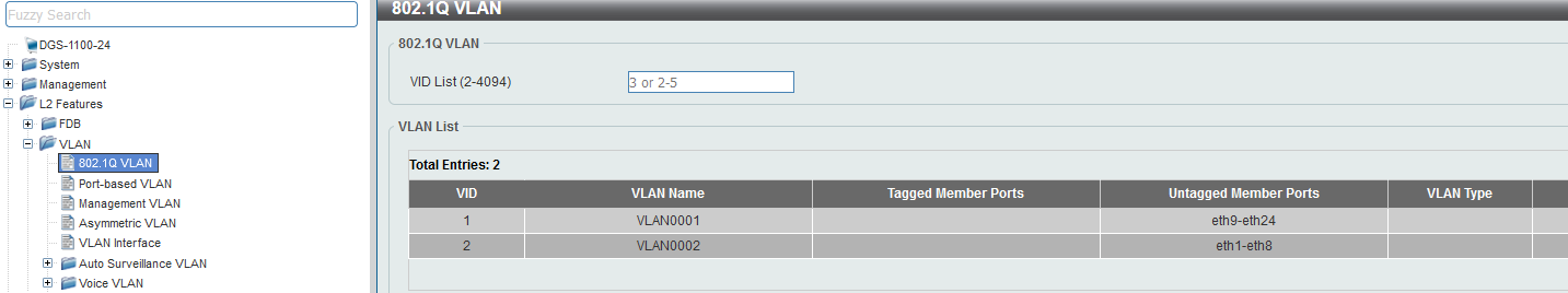

I don't understand your pictures, as I never fiddled with microtik, but those seem better to configure than mines:
(I think you mean L2 port isolation)
As for 802.1Q VLAN configuration, first every port has the id of an VLAN, that's mandatory:
And then you configure each VLAN. Untagged ports are the ports with just a "normal client" connected, in the way MAM explains, and tagged are the trunks.
The ports on the lower graph (tagged) will be also tagged in other VLANS, but the ones above (access ports) can only be untagged in one. F.Ex 3, 5 and 7 are the ports for the APs. They are tagged also in the other vlans they serve through dedicated SSIDs. If that wasn't configured that way IOT devices could never use wifi unless I had a physical AP for IOT.
I think I guess where must be the problem. The eth2 interface LACKS configuration in the base "interface". And it doesn't have VLAN 3 configured. I bet that unraid is sending some packets untagged though it and my router is giving that interface an address in the VLAN 3 segment. My previous sever had one there and it was the same ip that eth0 currently uses. Summarizing: The mellanox MAC previously had the 10.1.3.20 address. So could be a problem with DHCP, ARP or ROUTES.
What do you think?

The D-Link here is the last of 10 that is in use for "slow devices" that only can do 1G or less. The other 9 were given away, I guess 2 or 3 sit still in a shelf waiting for somebody to take them with them.
Here all clients and servers do run on 10G fiber (at least).
No Cameras 🙂 Cable and SAT Tuners for recording purposes. And the "lack of gateway" is only on the UNRAID side. It prevents UNRAID to think it could go elsewhere on this interface. Implied routing allows access to devices on this cable. But the other devices get a totally different setup from a DHCP Server in that "video LAN". This includes a gateway.
But it CANNOT BE UNRAID!!! (In my Case it my central FreeBSD Box used as a router, firewall, dhcp and dns server and so on.)
The no gateway in unraid is just a precaution to avoid any loops.
no! This is a complete misunderstanding. If eth2.2 has the address 10.1.2.30 (like shown above), it sends packets to 10.1.2.10 DIRECTLY, there is no gateway involved.
Gateways are only used to LEAVE the local LAN area and reach other LANs.
I could have a problem here:
unraid:~# route -n
Kernel IP routing table
Destination     Gateway         Genmask         Flags Metric Ref    Use Iface
0.0.0.0         10.1.5.251      0.0.0.0         UG    0      0        0 eth2.5
10.1.2.0        0.0.0.0         255.255.255.0   U     1      0        0 eth2.2
10.1.3.0        0.0.0.0         255.255.255.0   U     1      0        0 eth0
10.1.5.0        0.0.0.0         255.255.255.0   U     1      0        0 eth2.5
172.17.0.0      0.0.0.0         255.255.0.0     U     0      0        0 docker0
I don't found the graph. You mean you have three AP to serve three different vlan ? anyway this fine.
But if you connect three port to a AP then it usually form some looping.
A more elegant solution were use single AP and different ssid corresponding to different vlan, my AP support eight ssid, and different ssid bond to different vlan, then tag all to single ethernet port only.
Edited by Vr2Io
With the graph I meant in the 3th image I posted of the switch configuration, the picture of the switch, the top or the bottom ones.
No, no... I don't have tree APs for covering vlans 😄 I have 3 but for covering all the space. Each AP can broadcast different SSIDs and I have one dedicated for IOT.
Enable / disable vlan on eth0 won't cause problem, but best set to "no".  As mention, I don't found  problem on your UnraId setting, I just try to provide some change to troubleshoot.
I understand , my bad. for more detail : set that switch port ( connect to eth2 )  with a new vlan id then vlan3 won't go there.

Thanks @Vr2Io for all your help.
My current docker configuration is:
And I can't change the empty gateway in eth0.2. And you can see that it's not creating a custom network for eth0.
BTW I've managed to rearrage the interfaces. The mellanox now it's the eth0 and the two RJ45 are eth1 and 2. I've only left attached the link to eth0 (10Gb).
Network is stable without disconnects.
Still I don't have DNS resolution inside dockers.
Krusader on eth0.2 hangs here:
And other container on eth0.5 fails to resolve:
The containers are present on the network, and for example, Home Assistant that s on another machine records to influxdb correctly.
Samba shares work as expected, but NFS shares do not. I'm trying to mount a backup share on my proxmox server and it can't communicate with the nfs server.
My computer can mount NFS shares and it's on the vlan 2.

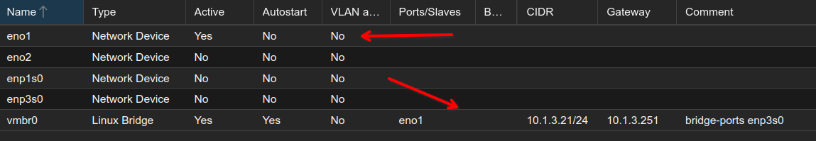

I think the problem is related to being unable to reset the main IP configuration of the interface and to raise an address in 10.1.3.xx segment as vlan:
Proxmox let's you leave the parent interface unconfigured, and configure the bridge:
