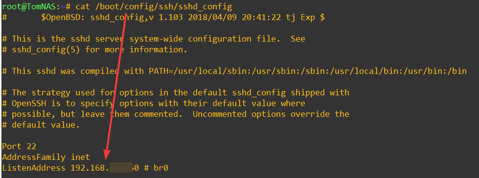

I have ZeroTierOne running which I would like to SSH to, however every time I reboot my unraid server, or even restart the service now - the ListenAddress in ssd_config goes back to the BR0 address / LAN address but I want it to be a custom address or 0.0.0.0.
I have tried editing /boot/config/ssh/sshd_config and /etc/ssh/sshd_config locations but after a reboot both are reset back to the br0 address.
I have the SSH plugin installed which I am not sure if it's doing something. There doesn't look to be any way of setting the listen address in here, so my next option would be to remove it, but I wanted to get some opinions in first before I sarted doing that.
Does anyone have any ideas why this keeps resetting back to the default LAN and not what I've set it to?

Thank you @bmartino1 however I have already tried this as I mentioned in the original post and when I restart the service the settings are reset back to br0.
This is the proccess I'm following:
nano /etc/ssh/sshd_config  --->  Add the new network
/etc/rc.d/rc.sshd restart --->  Restart the SSHD service
nano /etc/ssh/sshd_config  --->  Open the config file again to see that my config has been erased.
I don't think adding this as a user script will help the problem I'm encountering where my config alterations are being wiped out.
I can also confirm that after a reboot the /boot/config/ssh/sshd_config is overwritten and reset back to just my default bridge, even though I added the extra IP address of my ZTO interface in here as another line.
Any ideas for why when I restart the service the default br0 network is being added back into the config?
Edited by tomwhi

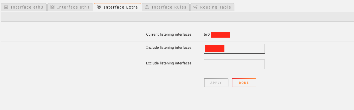

I have found a much easier way and that already brings the tool (check first the docs :p) in which you declare the name of the zerotier interface in this way will be linked locally and so you can have access to ssh, nginx and others.
Go to:
Setting -> Network Setting -> Interface Extra
netstat -tunlp o ss -tunlp to check:
Go to:
