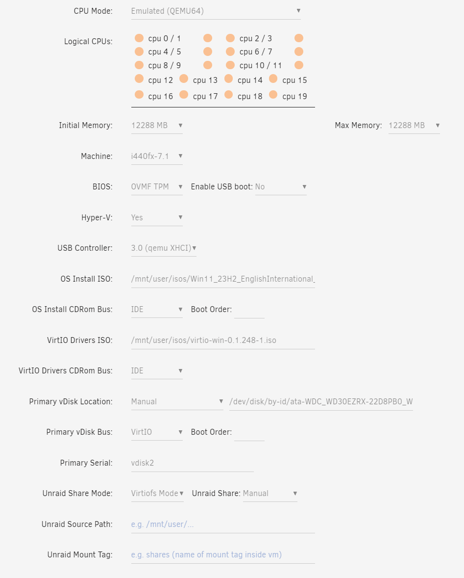

Hi all, i'm new to unraid and have been struggling with a few things. I managed to get a vm up and running with blue iris working and disk passed through working well. I then realised that i was using a virtual gpu. I stopped the vm and selected the igpu then things went bad. The vm wont boot (stays on the ufei boot screen) even if i select the virtual gpu. Any ideas how to get it working even with the virtual one so i can keep the cameras going? heres the settings i'm using. Thanks

to pass any gpu you need the kernal in use driver to be vfio.
you may also need to install the intel pulgin driver for the igpu...
