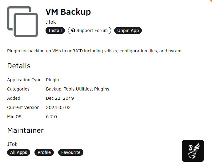

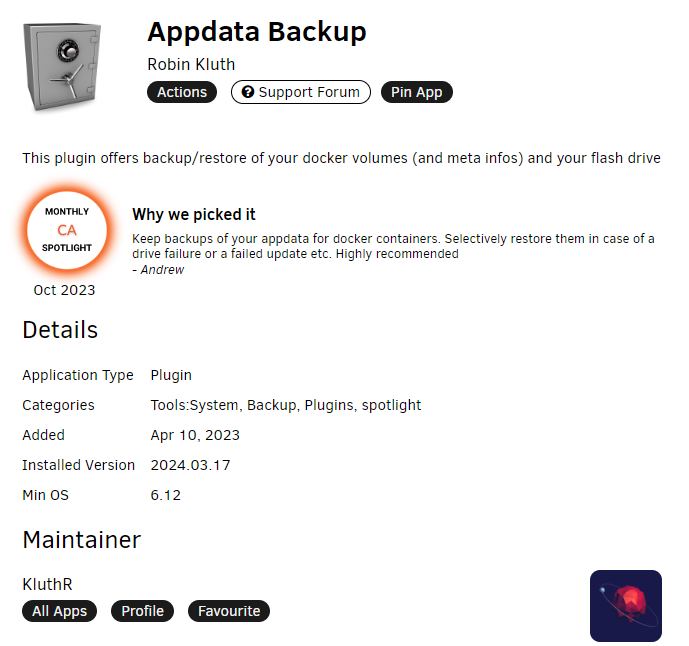

? run the plugin to backup the vm> appdat backup

Thanks for the suggestions! I'll start experimenting and will get back with the results. The VM Backup plugin is not as "production grade" as I would like it to be (it's in beta and the only developer is quite busy). Due to the plugin status I actually made a feature request for Lime back in 2022 to help make it stable or include similar features in Unraid, and the response was "That's a very requested feature and one we plan on adding in the future, but no ETA for now"

I installed the QEMU guest agent to all VMs I could to enable the snapshot feature in the VM Backup plugin - the snapshot feature is a must.
I moved any problematic VMs back to the Array (XFS) and I'll use the old User script backup script for these. For example pfSense has the QEMU guest agent installed and the network interface listing is visible in Unraid, but when the backup starts, an error occurs:
"failure: snapshot command failed on pfsense-vdisk2.snap for pfSenseXXX."
"failure: snapshot_fallback is 0. skipping backup for pfSenseXX to prevent data loss. no cleanup will be performed for this vm.".
I checked that the virtual disk paths are not using /mnt/user, but didn't investigate much further. Edit: under the "Number of backups to keep" tooltip it mentions that if multiple vdisks are present, they need to be sequentially numbered - there is only one vdisk in this VM, but it ends with 2, could maybe be an issue...
