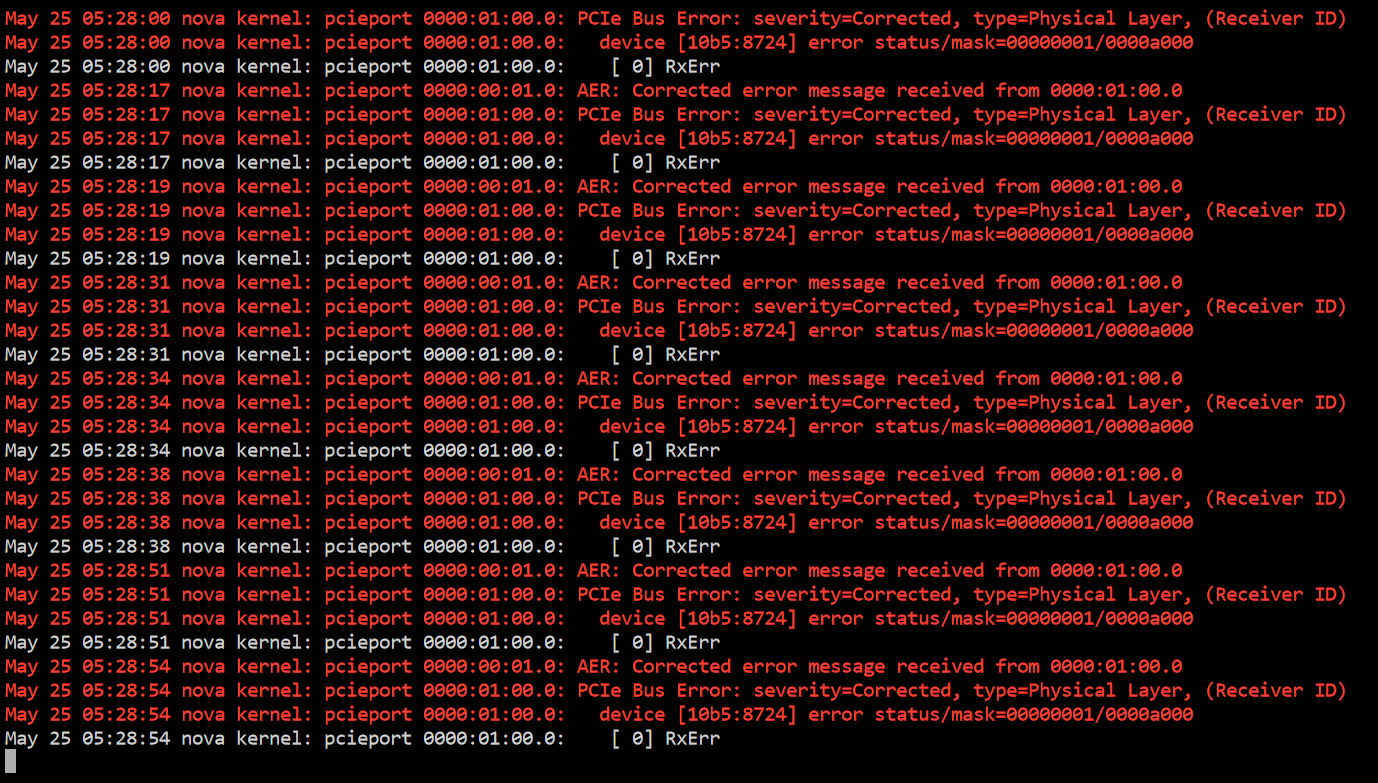

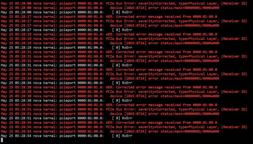

May 25, 20242 yr Community Expert I have been getting these errors since I started using Unraid. I am not sure if they actually cause harm, but the server recently shut down randomly after I initiated a reformat of a drive. The only two cards I have attached are an Asus IPMI card and a Broadcom LSI 9300-16i. Any suggestions? Edited May 25, 20242 yr by Bob-omb

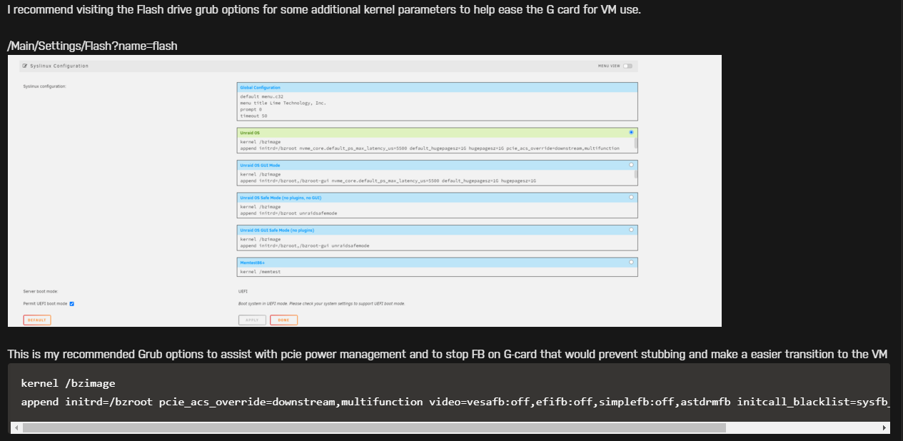

May 25, 20242 yr Community Expert AER Errors are usually power/cable connection and/or sleep states. The PCIe AER driver provides the infrastructure to support PCIe Advanced Error Reporting capability. The PCIe AER driver provides three basic functions: Gathers the comprehensive error information if errors occurred. Reports error to the users. are they being passed to a vm? see vfio notes: https://forums.unraid.net/topic/164064-cant-passthrough-nvidia-gpu-anymore-to-vm-used-to-in-previous-unraid-versions/?do=findComment&comment=1413526 I recommend a grub option to turn of aer... the grub option: pci=noaer pcie_aspm=off kernel /bzimage append initrd=/bzroot pci=noaer pcie_aspm=off review: https://www.kernel.org/doc/Documentation/PCI/pcieaer-howto.txt Edited May 25, 20242 yr by bmartino1 forum post link lost wrttin dat in post..

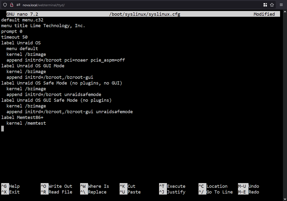

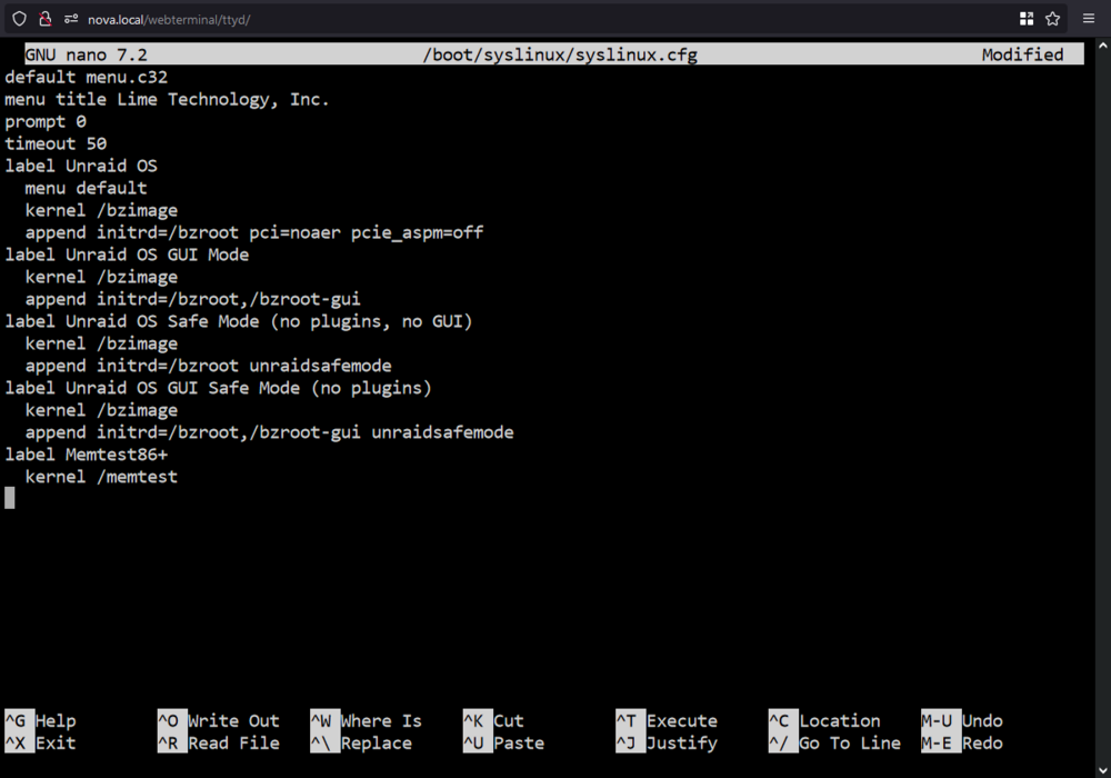

June 4, 20242 yr Author Community Expert Solution Edit: In the end, I decided to get rid of the LSI 9300-16i because I didn't want to take the risk of using it while not fully understanding what the error messages meant. The following part was my solution to turn off the warnings, but it might not be so wise: OK I think I managed to turn off the warnings eating up the log file. I am not seeing the error anymore, but I also don't know if I should be worried about it. Everything works, but only as far as I can tell. Here is what I did: Made a backup of the flash drive I opened the terminal in Unraid and entered: nano /boot/syslinux/syslinux.cfg I entered the pci=noaer pcie_aspm=off on line 9 CTRL + X to exit, Y to confirm, and Enter to save. Here is the full syslinux.cfg after the change: default menu.c32 menu title Lime Technology, Inc. prompt 0 timeout 50 label Unraid OS menu default kernel /bzimage append initrd=/bzroot pci=noaer pcie_aspm=off label Unraid OS GUI Mode kernel /bzimage append initrd=/bzroot,/bzroot-gui label Unraid OS Safe Mode (no plugins, no GUI) kernel /bzimage append initrd=/bzroot unraidsafemode label Unraid OS GUI Safe Mode (no plugins) kernel /bzimage append initrd=/bzroot,/bzroot-gui unraidsafemode label Memtest86+ kernel /memtest Edited June 16, 20242 yr by Bob-omb
