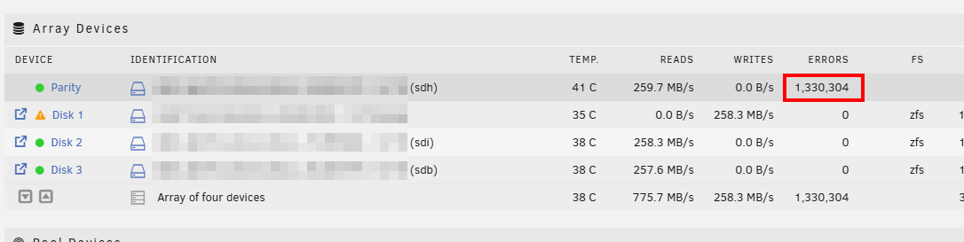

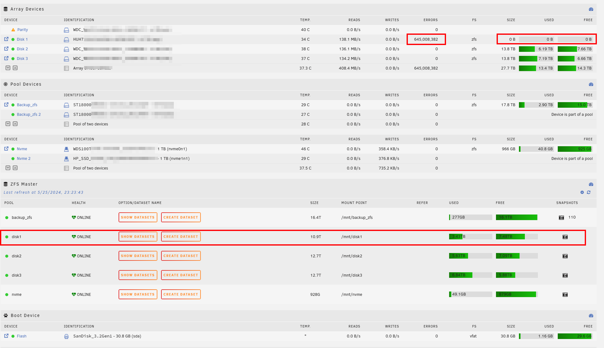

Picture of main tab to show layout of disks.
did you install all the zfs Community app plugins?
it looks like you make a single disk pool with 1 disk. and uses a partition instead of the disk itself...
Review:

Today I got errors on disk1 during parity sync (it is continue running) and according to screenshots - size is 0 and I can not open any files on this disk:

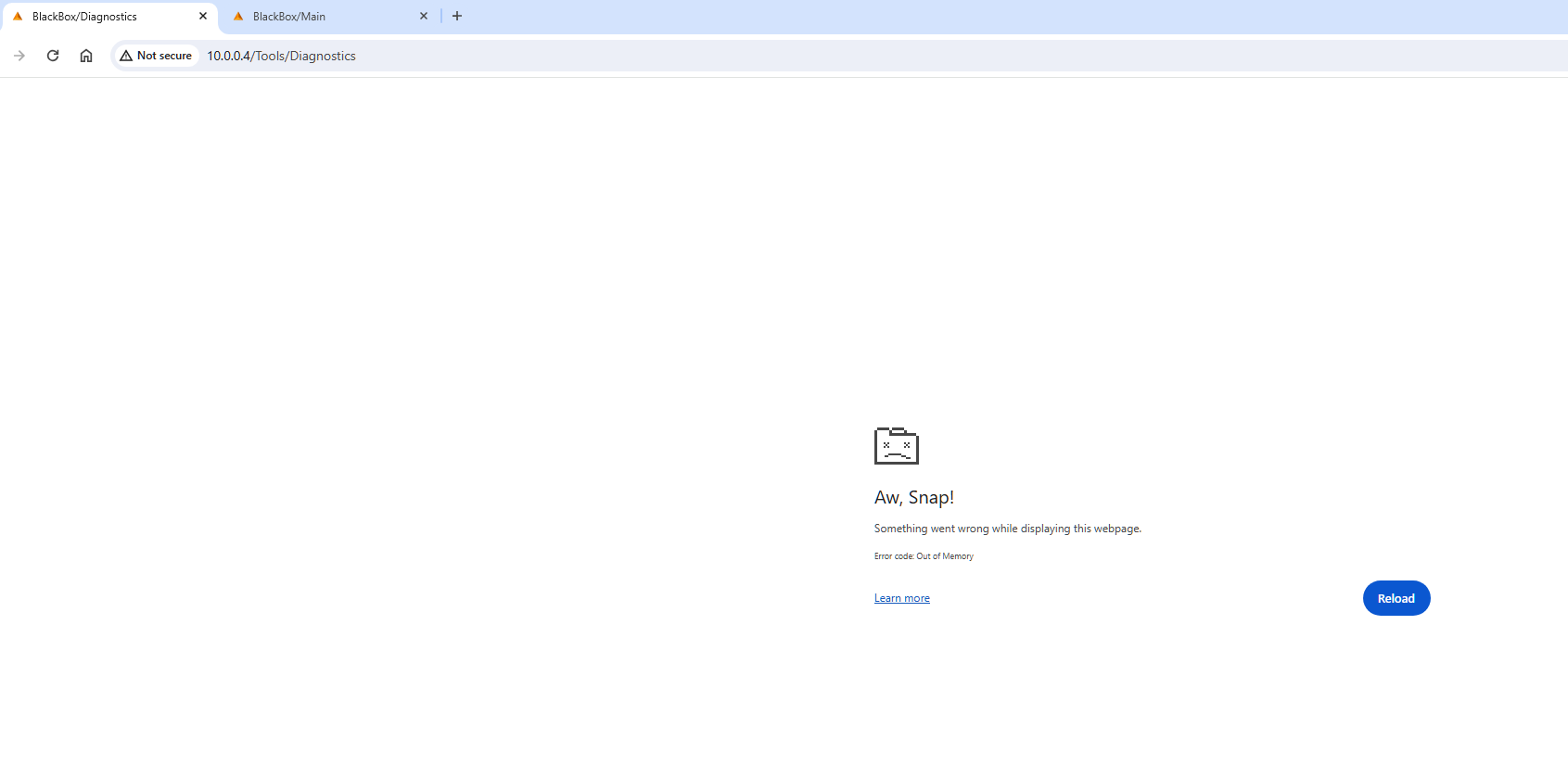

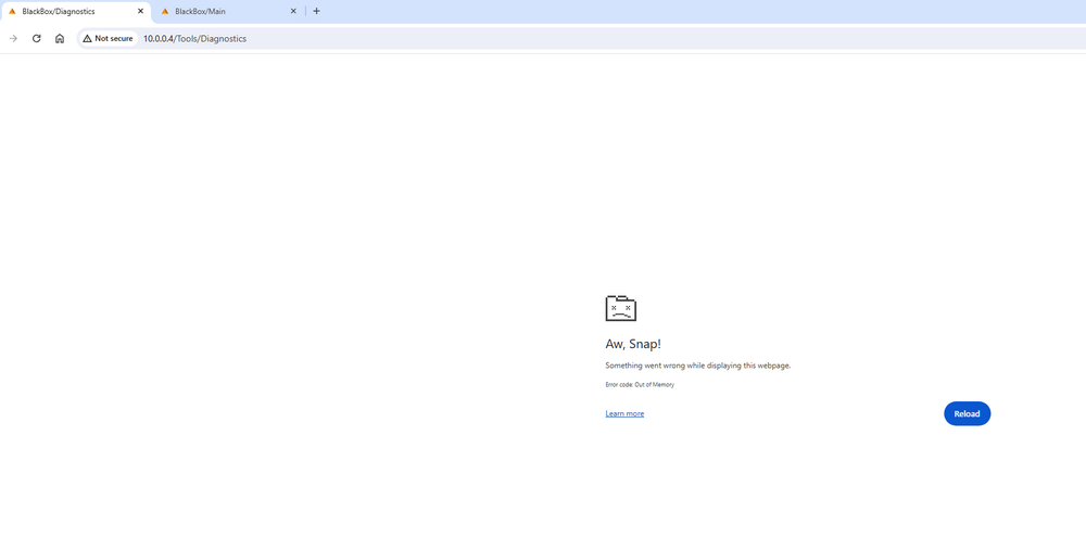

I was trying to download diagnostic file, but it failed in chrome tab
Will try to get it from boot/logs if it is created.
open terminal and type diagnostic
Thank you.

It looks like you used zfs as the array file format per the main pciture...
I've had terrible experience with unraid doing that. Thee aray and how it works done't act nor work right with unraid array setups.
See docs: https://docs.unraid.net/unraid-os/manual/storage-management/
if you're doing ZFS it should be pool devices only. At least that is the recomend keeping the array formatted as xfs/btrfs.
some of the weirdness can be explained as the array and partiy are not tralking/working as they dhould based on the file system type.

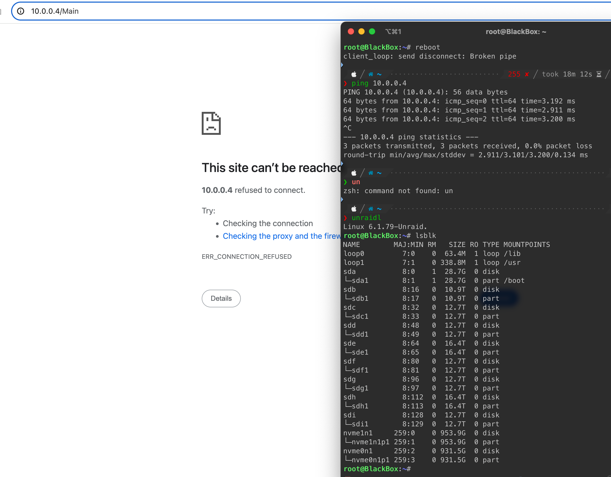

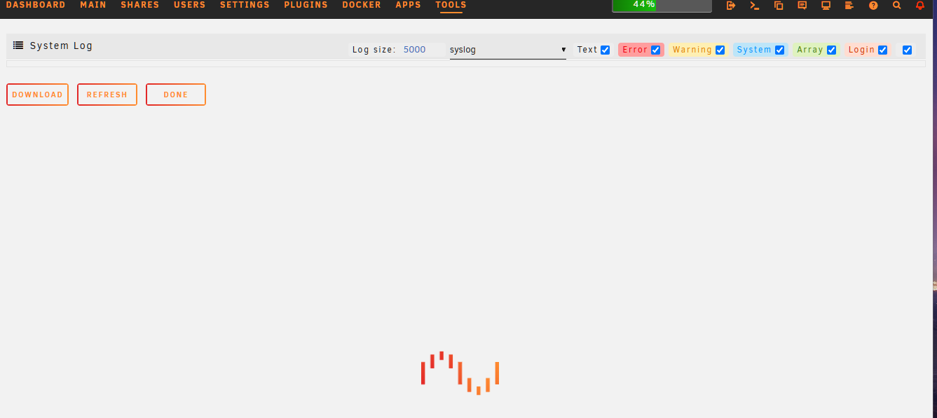

Tried, rebooted, changed cables. First reboot I couldn`t see GUI, but was able to login via ssh and removed network config, rebooted from ssh again and was able to see GUI.
But array didn`t start, status "Starting " and that is it, created diagnostics archive (in attachment) and rebooted server again from console.
And now again - don`t have GUI, but can login via ssh:
Any ideas what should I do? I already copied all config folder from server, maybe need to remove all files from config folder and reboot one more time?

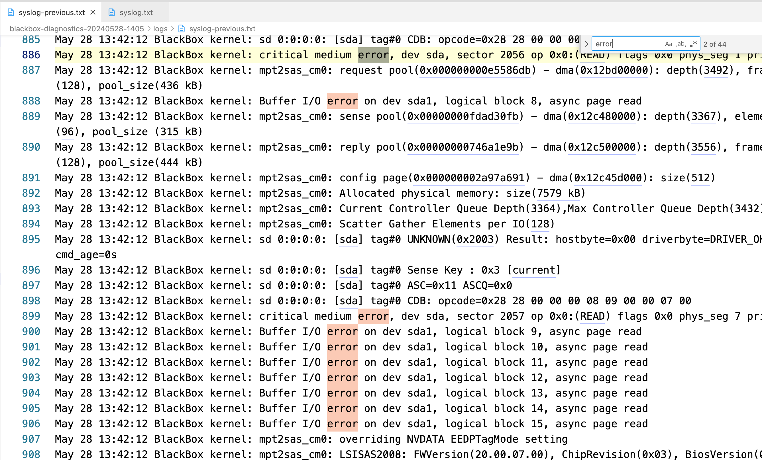

Also, I checked logs from statistics archive and found few errors on sda drive, so maybe USB issue?
May 28 13:42:12 BlackBox kernel: critical medium error, dev sda, sector 2057 op 0x0:(READ) flags 0x0 phys_seg 7 prio class 2
May 28 13:42:12 BlackBox kernel: Buffer I/O error on dev sda1, logical block 9, async page read
May 28 13:42:12 BlackBox kernel: Buffer I/O error on dev sda1, logical block 10, async page read
May 28 13:42:12 BlackBox kernel: Buffer I/O error on dev sda1, logical block 11, async page read
May 28 13:42:12 BlackBox kernel: Buffer I/O error on dev sda1, logical block 12, async page read
May 28 13:42:12 BlackBox kernel: Buffer I/O error on dev sda1, logical block 13, async page read
May 28 13:42:12 BlackBox kernel: Buffer I/O error on dev sda1, logical block 14, async page read
May 28 13:42:12 BlackBox kernel: Buffer I/O error on dev sda1, logical block 15, async page read
May 28 13:42:12 BlackBox kernel: Buffer I/O error on dev sda1, logical block 8, async page read
blackbox-diagnostics-20240528-1405.zip
Oh, maybe it helpful - right now all 8 HDD`s connected via LSI controller, previously 4 were connected to LSI and 4 to motherboard.
But command lsblk can return list of disks.
sda is the flash drive, if it's logging errors you need to replace it, or you can also try to reformat it first to see if it helps.

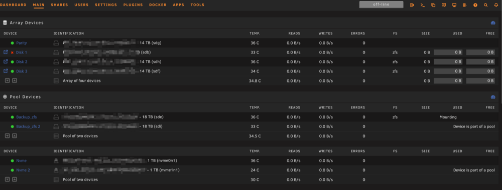

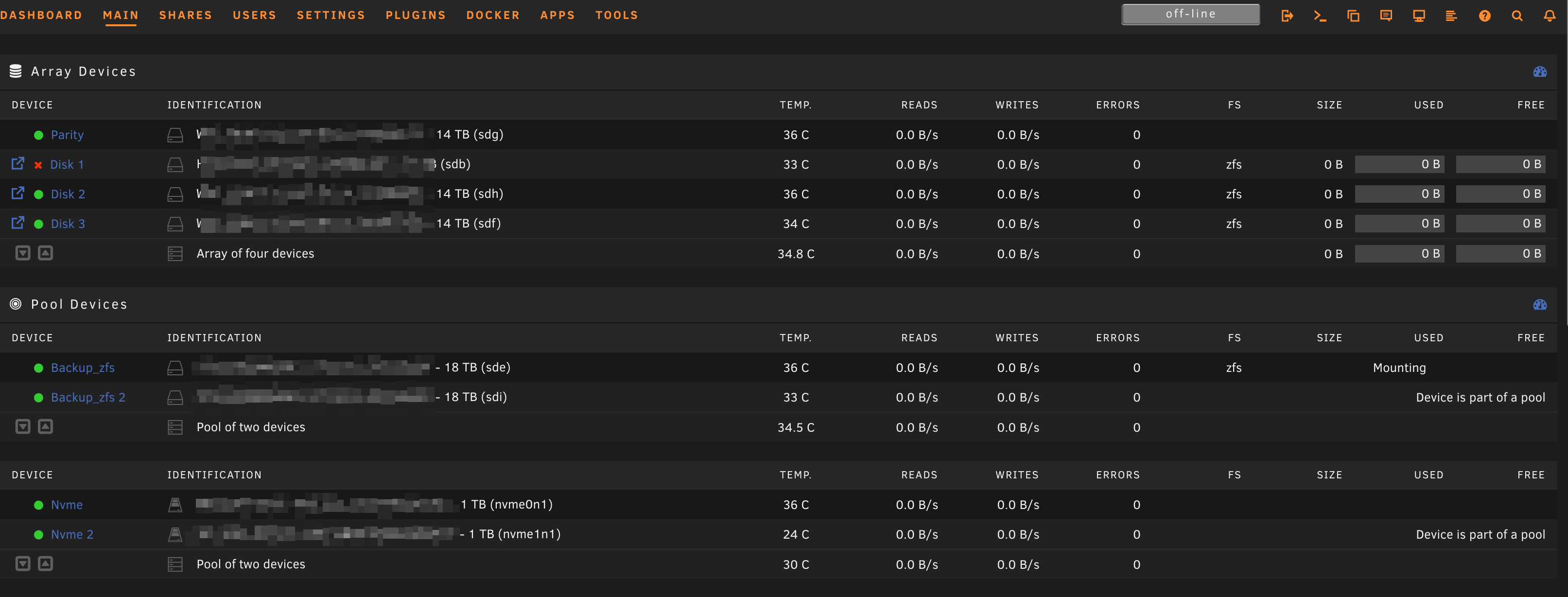

I formatted drive, flashed, copied again /config folder and Array is starting for 30 minutes...
Almost 1 hour Array is trying to start
sdb = disk1, and sde and sdi = both are "backup_zfs" pool
What should I do?

I assume disk1 is still disabled and being emulated? If yes post the complete syslog, or the diags, there could be errors with other disks causing those.
You are absolutely right.
So, just copied syslog:
syslog.txt
I don't see errors with disk1 on that log, do see errors on both pool devices, causing this:
May 28 16:10:05 BlackBox kernel: WARNING: Pool 'backup_zfs' has encountered an uncorrectable I/O failure and has been suspended.
A pool is suspended when zfs cannot continue to access it, because there were errors with both disks, this will make Linux get stuck, and Unraid will never continue without a reboot.
You will need to force a shutdown, then check/replace cables for both pool disks and post new diags/syslog after array start.
Many these records
00 00
May 28 16:06:27 BlackBox kernel: I/O error, dev sdb, sector 23437770560 op 0x0:(READ) flags 0x80700 phys_seg 1 prio class 2
May 28 16:06:27 BlackBox kernel: sd 7:0:0:0: [sdb] tag#851 UNKNOWN(0x2003) Result: hostbyte=0x00 driverbyte=DRIVER_OK
sdb is disk1.
Thank you, on my way.

Replaced cables, don`t see errors for disk1 anymore, but now I can see errors on parity drive...
Decided to delete backup_zfs pool.
Can`t see log

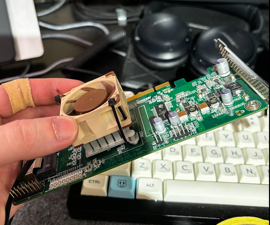

I want to say thank you, it seems issue is resolved, now I know how to backup flash drive and which logs can be important.
Solution was - add active cooling to LSI adapter:
I will take a look at my drives in few days to be sure.
