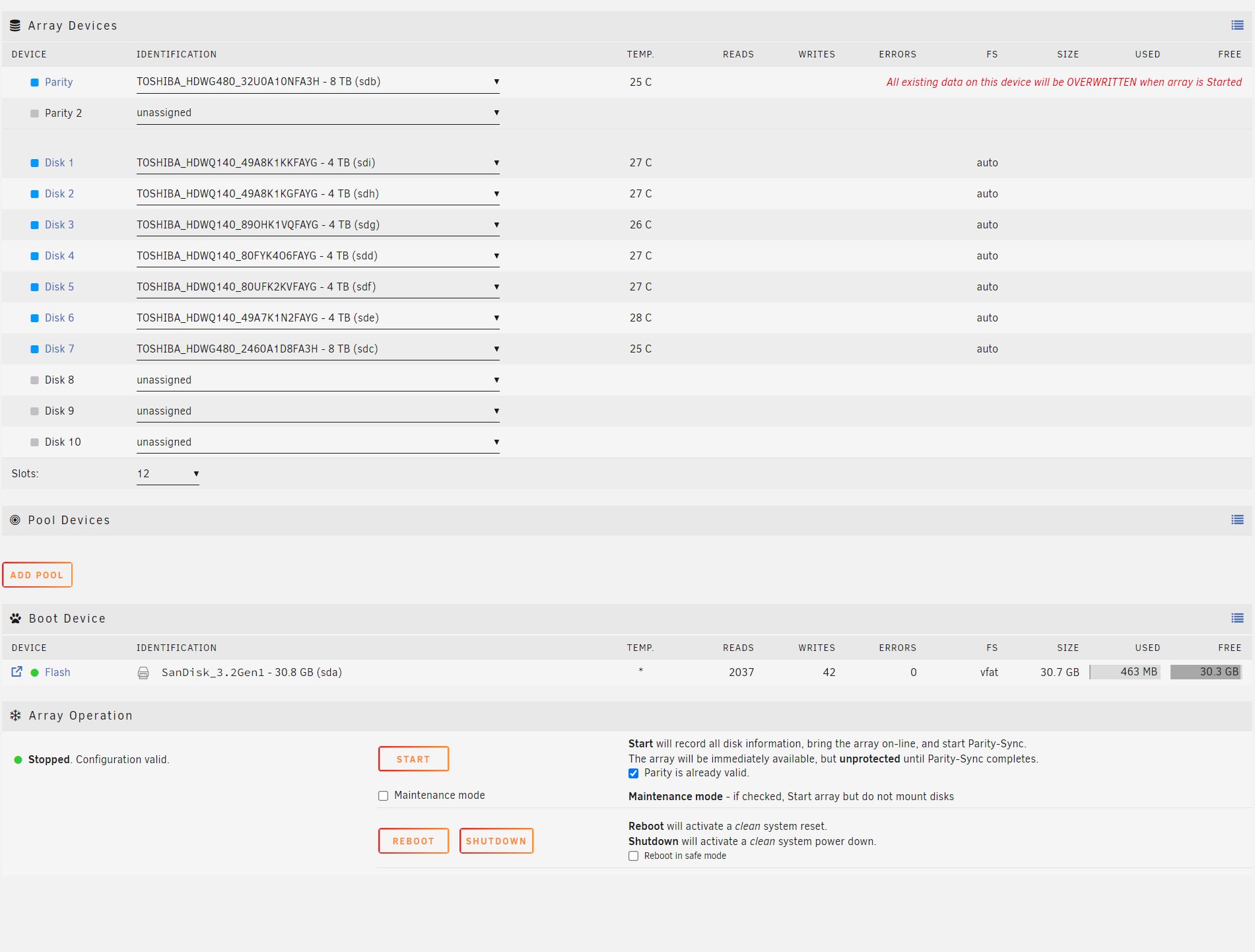

Thank you very much! I have now got the new disk installed, I'm still scared of turning on the array.
I went in to tool->new config and ticked "all" and the "parity is already valid" is ticked.
I'm worried I haven't described the situation correctly and because of that have got something wrong so I'll just put it down here as clear as I can.

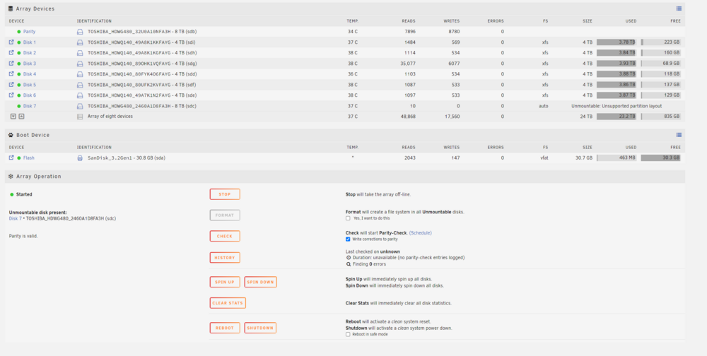

I'm a bit worried over the red text next to the parity drive but that does not apply when the array is in parity?unraid240601prerebuild.thumb.png.66bb7b3ab7e8672ac2b8aa1d5faa93c3.png

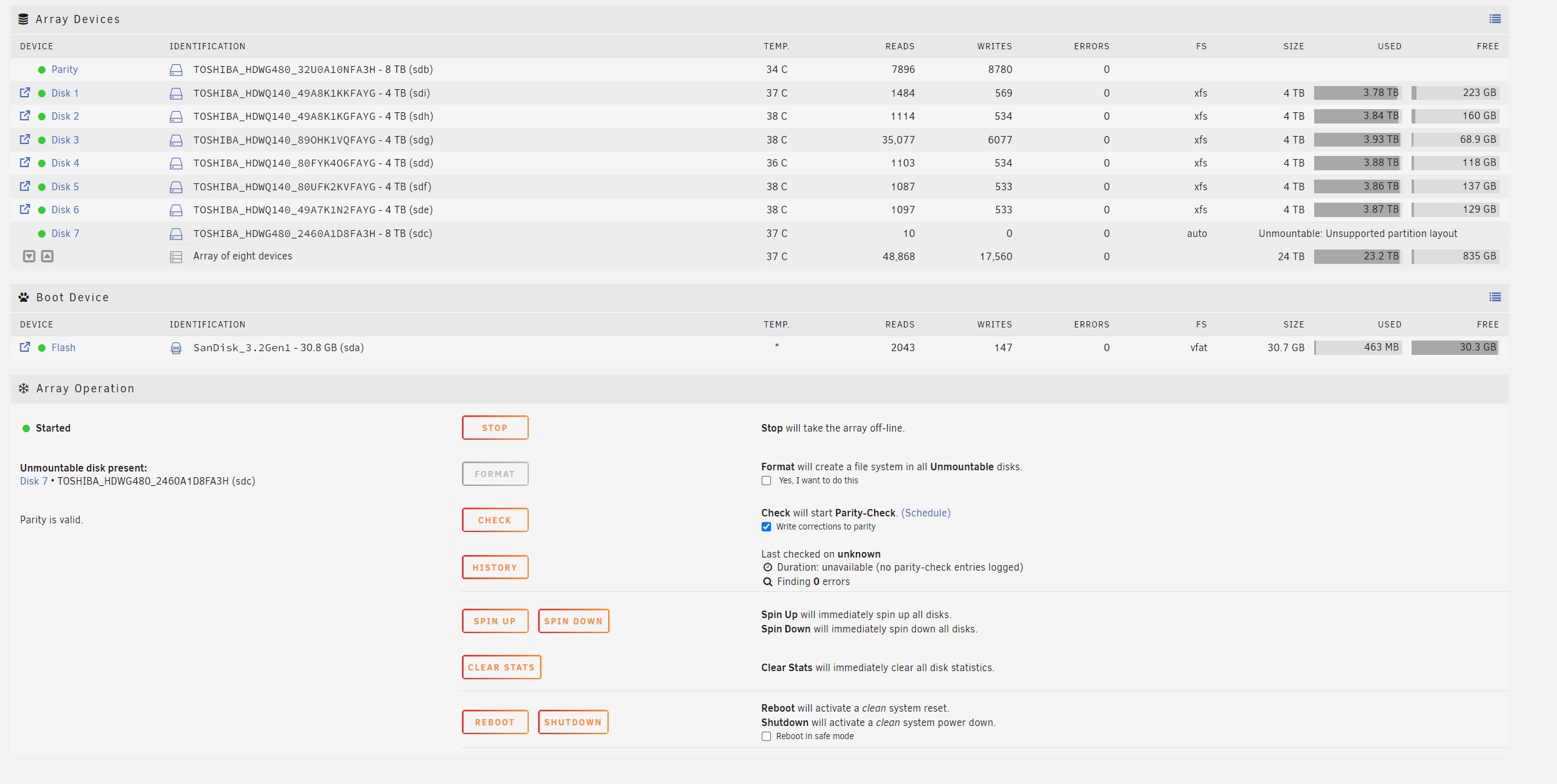

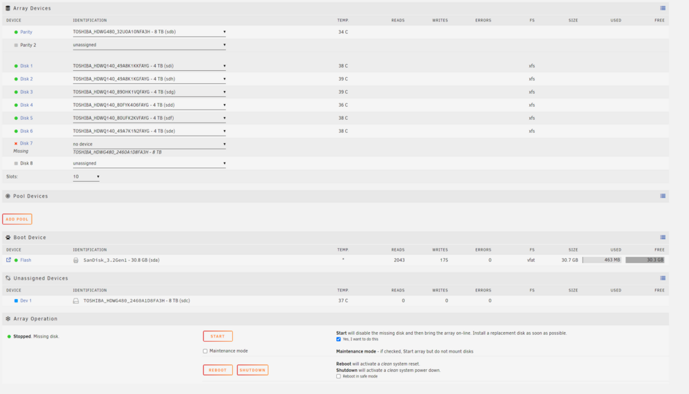

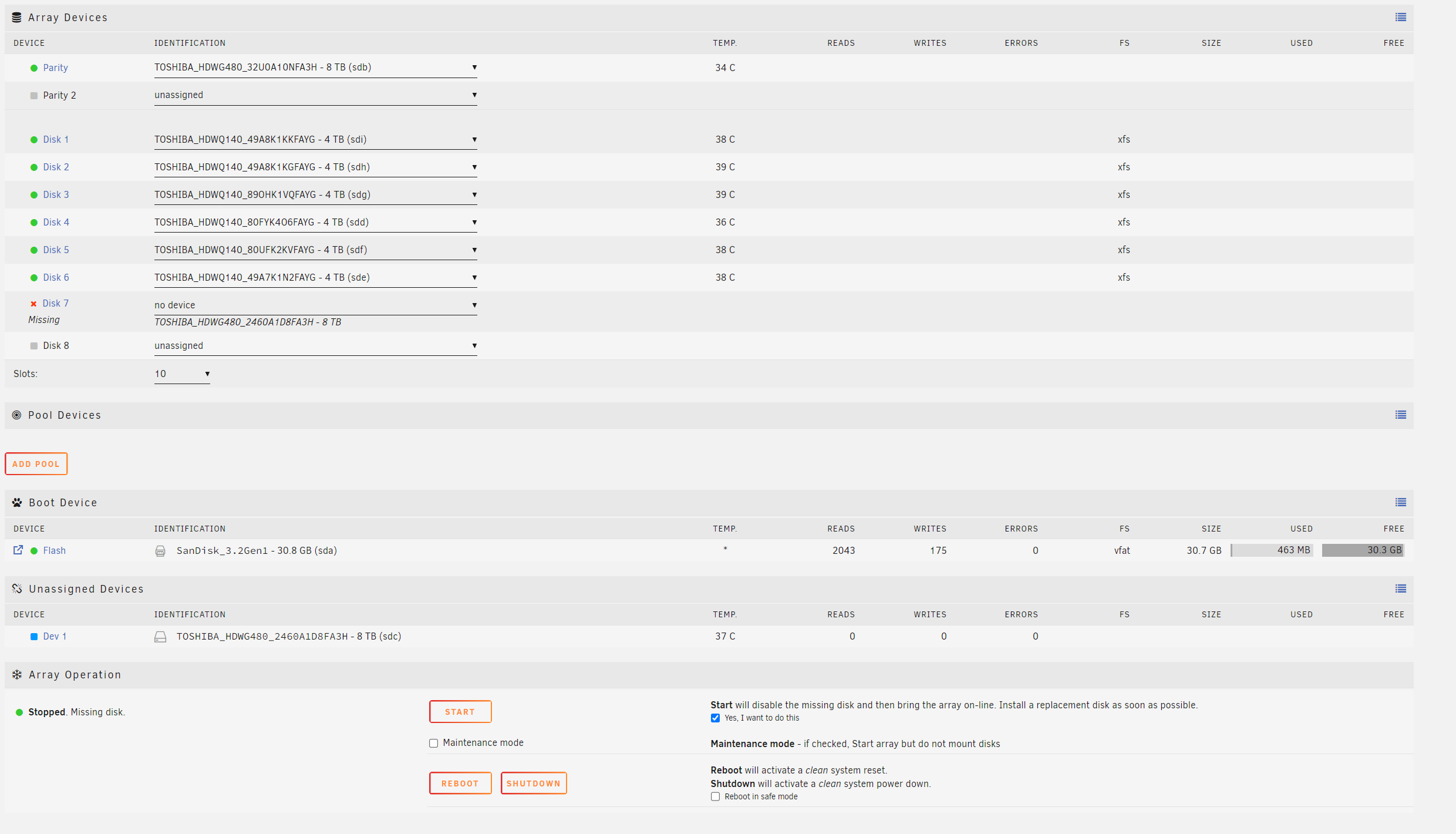

followed the steps above, this is what happend:
I stopped the array and this is how it looked (note the checkmark in the start array operation)

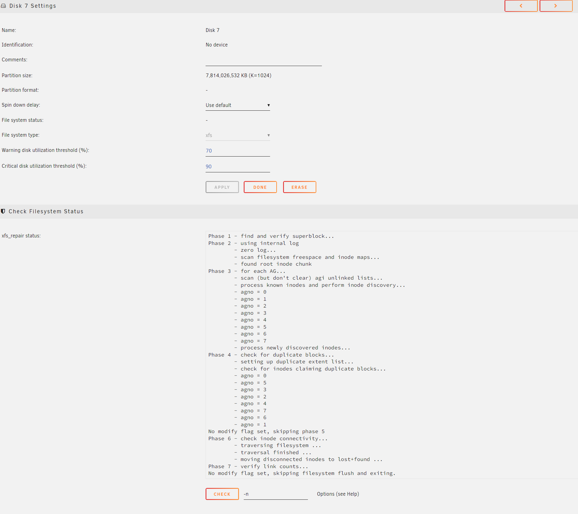

started again and got the emulated drive, then I stopped it and put it in "Maintenance mode" before I started (because it is a xfs file system).
I ran a check on the emulated drive.

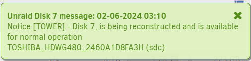

Assigned the new disk and started the array again, got this message
estimated finish is 3-4 days, I will update this post when it's done.
Thank you itimpi and JonathanM for the help!
It looks like you only 'checked' the emulated disk rather than repaired it as the last line of the check report mentions that the 'no modfiy' (-n) option was used.   That means that the rebuilt disk will also probably show as unmountable until you repair it.
Everything worked out fine, but yes I only checked the disk (I misunderstood what I had to do).
The disk had to be rebuilt on my new disk but it worked out.
