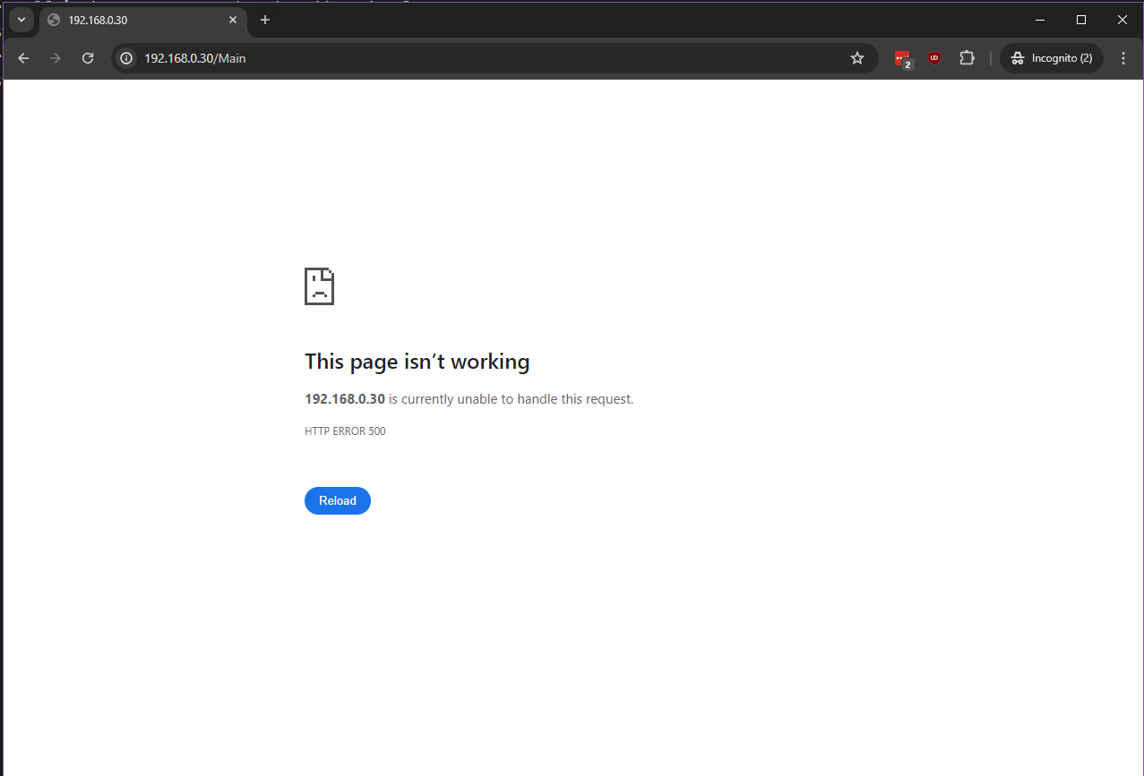

I'm having trouble accessing the Unraid server's web UI. Although I can SSH into it, the web UI keeps showing a 500 error.

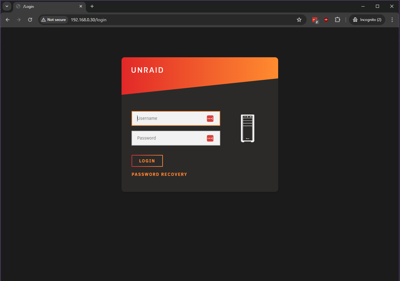

  5. I tried starting nginx and php-fpm manually, which got me to the login screen, but it still throws 500 errors after logging in.
  6. Rebooted gracefully but same issue.
