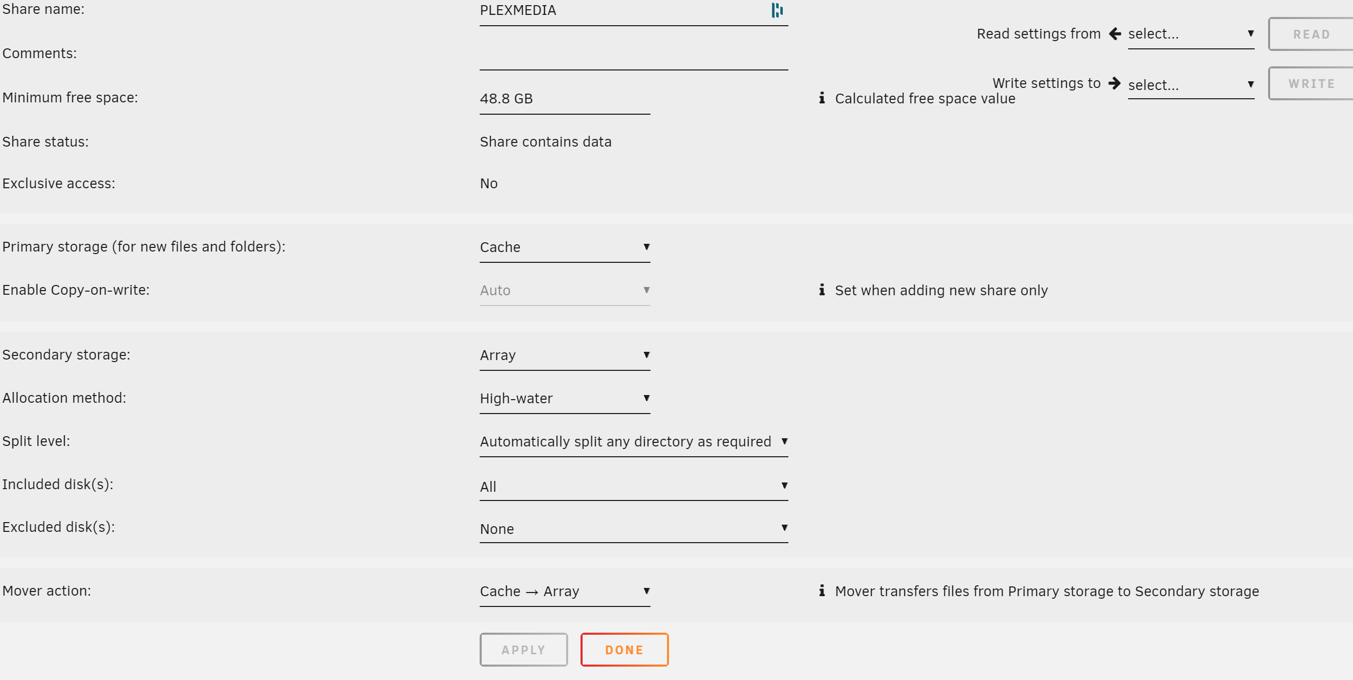

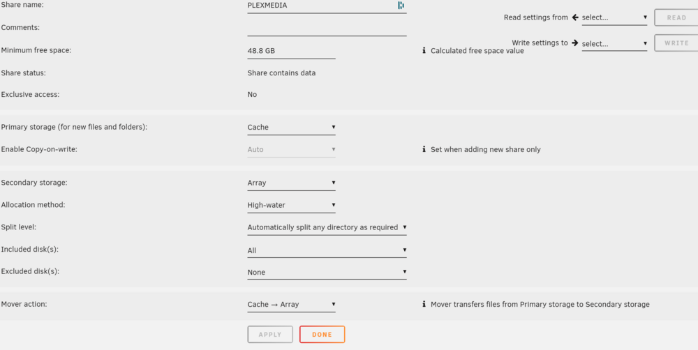

Hi all, Im struggling to get my unraid server to use the cache, its stays at 22% regardless of where I copy files from/to
I have set the shares to use the cache for primary storage and the hard drive array as the secondary
I have attached images of the settings ive used, any help would be very much appreciated

First thing.  The cache drive is only used to store new files being written to the share.  (Files that are being updated are written directly to the array.)
Second thing.  Reading a file from the array will not move it to the cache.   With your settings, once the file is on the array, it will always be there unless you delete the file.
Does this clarify the situation?
Hi, thank you i understand, however if I understand how it should operate, when I copy a new file to the PLEXMEDIA share it should use the cache but it doesn't, it just sits at 22%

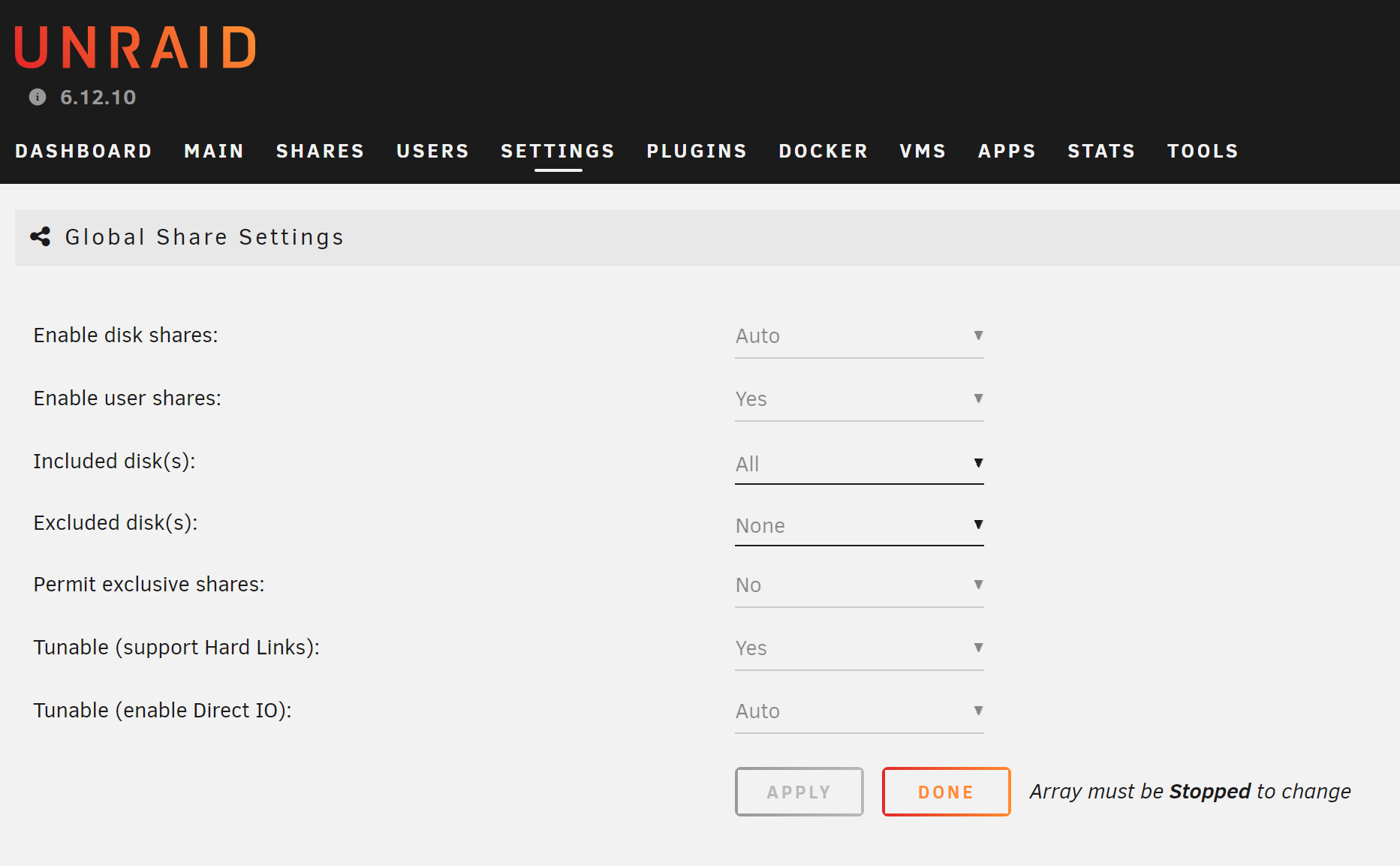

Im doing a little research and someone mentioned that it may be a setting that needs to be changed in the 'global shares page'? however I cant see an option to enable cache in it or am I looking at the wrong page?
thanks in advance!

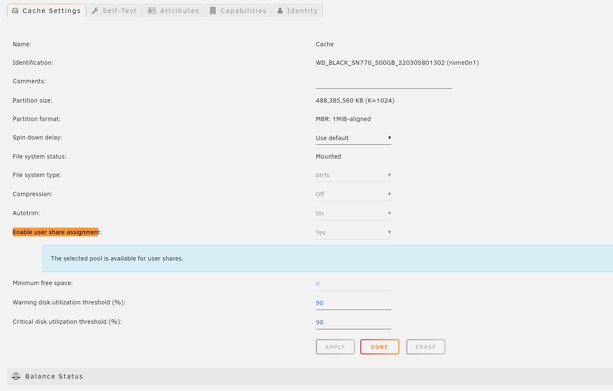

You might want to check that the pool to be used for caching has “Enable User Share Assignment” set to Yes.

Hi. thank you, I have checked the pool device like you suggested and seems to be on already:
