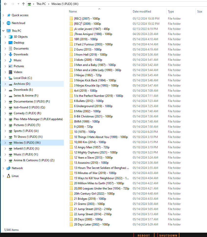

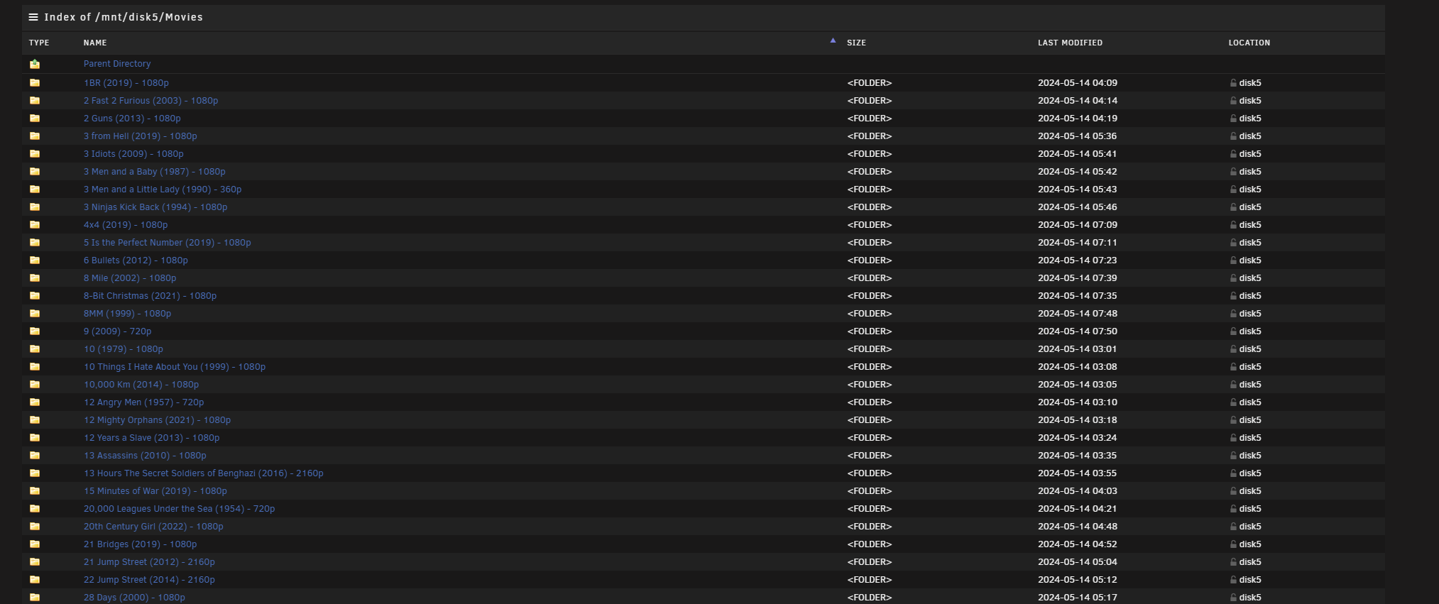

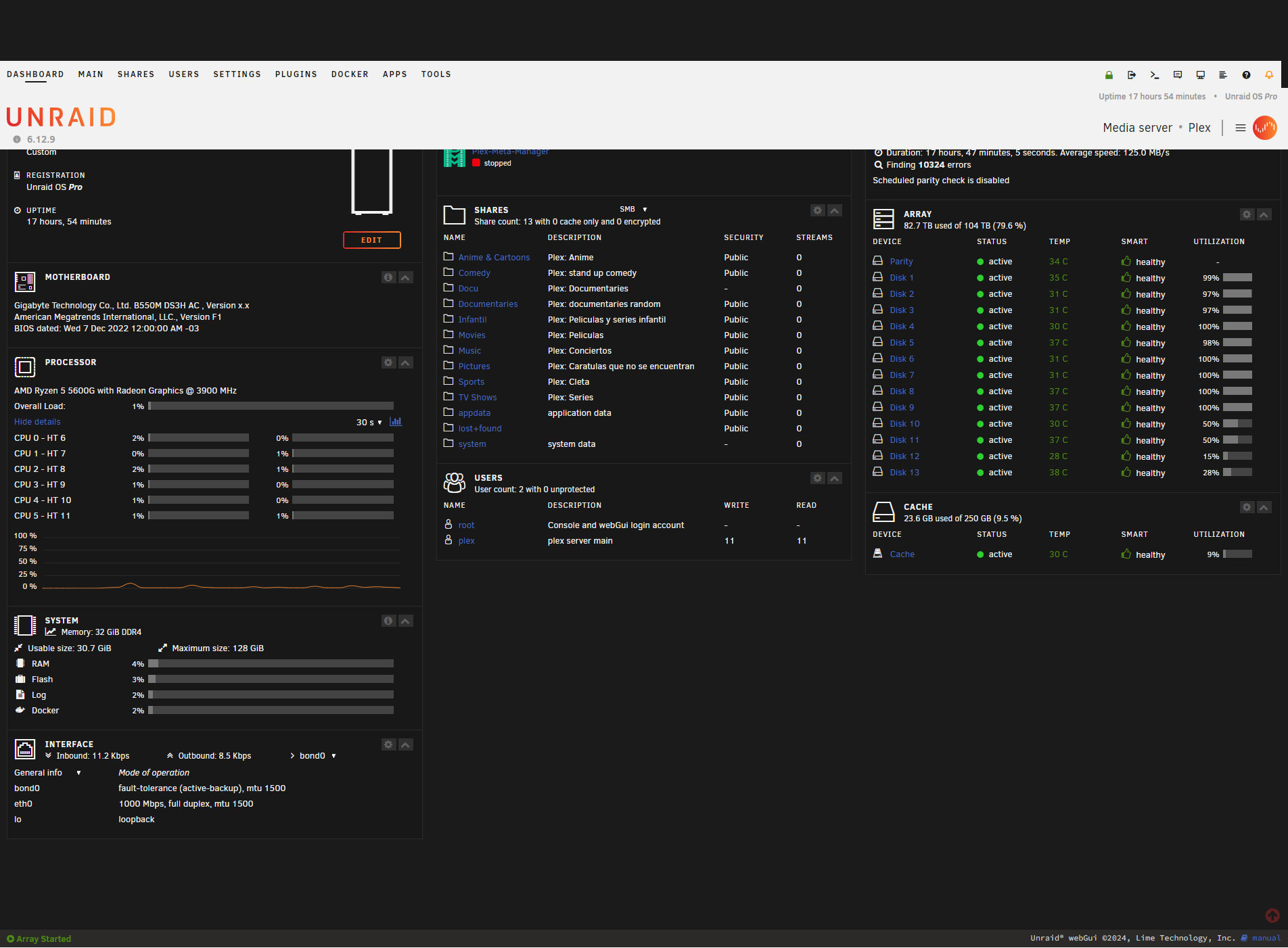

I've a share named Movies, and it isn't showing the files that are in this share.
Last night i finished moving a file from my computer (Windows 10) to this server/share with no issues and when i went to update the Plex library it refreshed and showed that all my Movies were unavailable, and ofc didn't update/added the new ones that i just moved with no issues.
The tricky part is that i've other shares in same hard drives and they're showing with no problem.

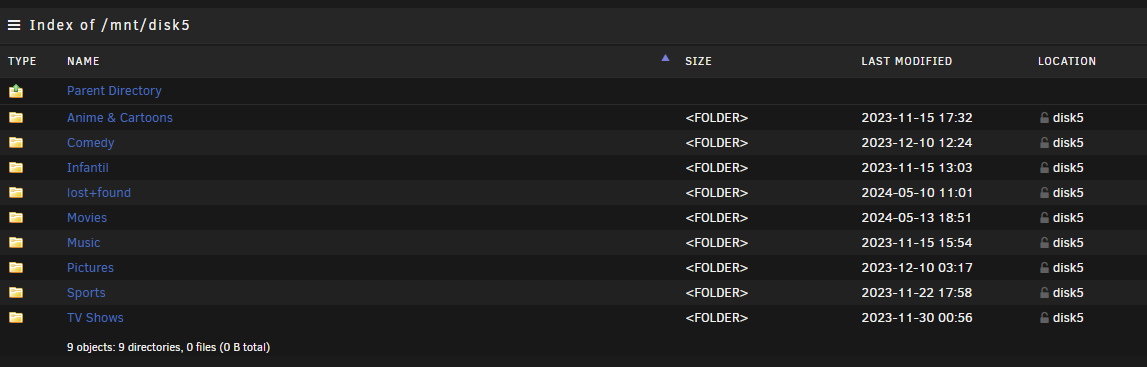

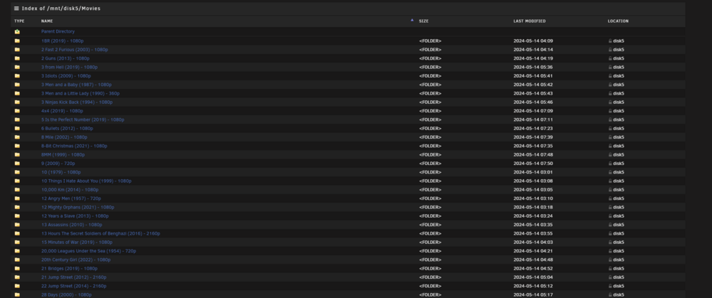

Besides that, if i go and check the files on the disks it shows them in the respective folder (share) Movies. I can see the files and also download them.

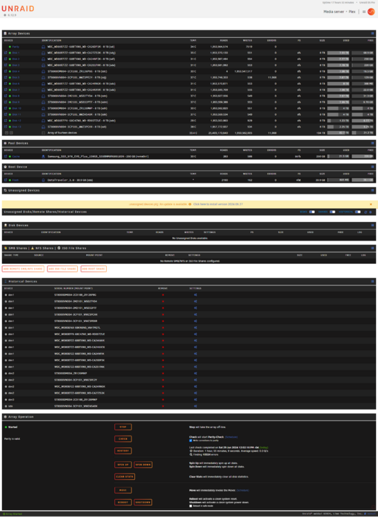

Here are some pics:
-Dives: https://imgur.com/a/U1Gsx8P
-Share Settings: https://imgur.com/a/AzKG0nP
-Share Settings after around 30 seconds: https://imgur.com/a/l5I8ZPq
*It changes the Share status
-Share Files: https://imgur.com/a/pVWgcA8
-Windows: https://imgur.com/a/8e8vxmC
-Movies on disk 1: https://imgur.com/a/J6VxNmw
-Movies files: https://imgur.com/a/q0xMddG

-Server specs: https://imgur.com/a/vqTEnWX

I tried with 2 other computers (windows) and also can't see the files.
This share has around 6000 movies, with subtitles, poster iamge, etc. It must contain easily more than 20.000 files.

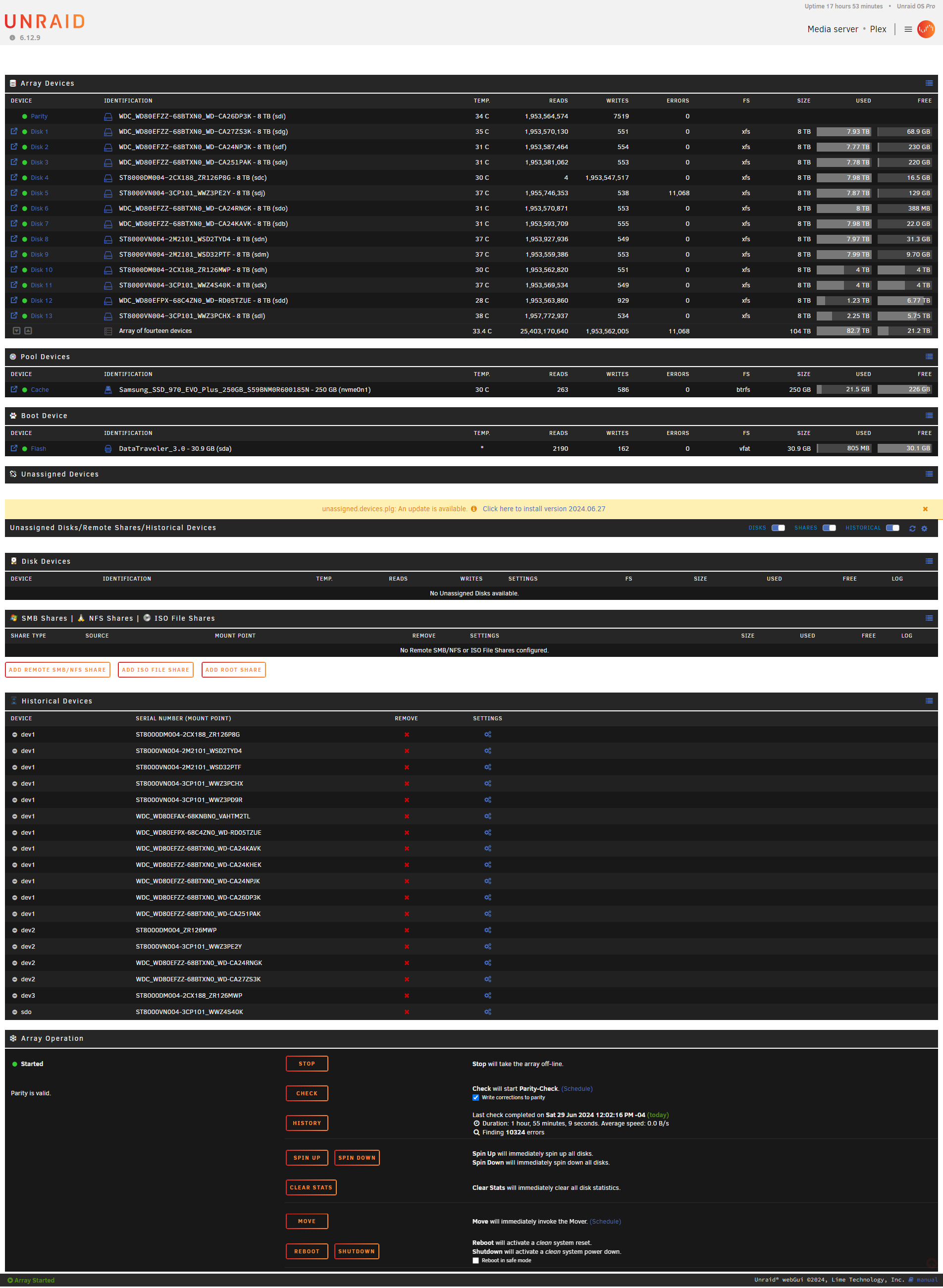

Can't tell anything about your filesystems until they are mounted.
Start the array in normal (not maintenance) mode and post new diagnostics
Emulated disk4 is mounted and is nearly full, but physical disk4 is missing.
What can you tell us about disk4?
Also, the Movies share has data spread across many disks, including emulated disk4.
Sorry for the delay on my answers, i was out of town.
About the disk4, I had a problem with a sata cable, that's why disk4 failed and it was showing as emulated.
I've news about this issue (no solution).

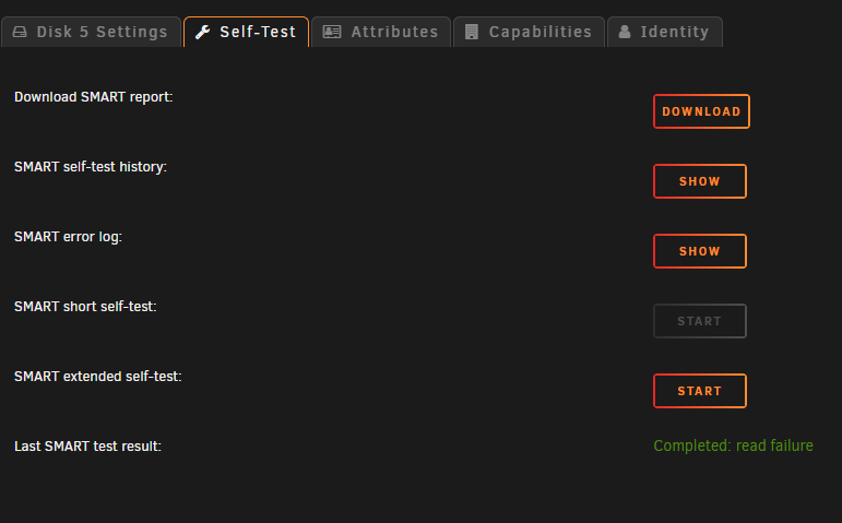

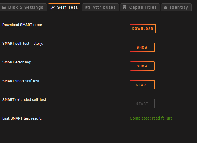

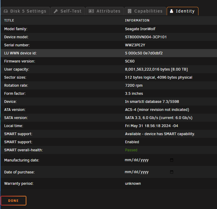

Disk 5 is showing read errors ~1 minute that i start the Array. Without me doing any action, always 20 read errors.
I can see the files, folders, download the files, everything, but it shows error.

I attached new diagnostic and also pics of disk5.
Can this be related to my issue?. Like i said, i haven't done anything different, and sometimes i would get some read error in any a different disk, would restart or change sata and i would stop getting any problem. Never had a share disappear
plex-diagnostics-20240531-1928.zip
Disk5 appears to be failing, run an extended SMART test to confirm.
I
If i do a short or extended test it says:
Completed: read failure
ATA Error Count: 320 (device log contains only the most recent five errors)
	CR = Command Register [HEX]
	FR = Features Register [HEX]
	SC = Sector Count Register [HEX]
	SN = Sector Number Register [HEX]
	CL = Cylinder Low Register [HEX]
	CH = Cylinder High Register [HEX]
	DH = Device/Head Register [HEX]
	DC = Device Command Register [HEX]
	ER = Error register [HEX]
	ST = Status register [HEX]
Powered_Up_Time is measured from power on, and printed as
DDd+hh:mm:SS.sss where DD=days, hh=hours, mm=minutes,
SS=sec, and sss=millisec. It "wraps" after 49.710 days.
Error 320 occurred at disk power-on lifetime: 2758 hours (114 days + 22 hours)
  When the command that caused the error occurred, the device was active or idle.
  After command completion occurred, registers were:
  ER ST SC SN CL CH DH
  40 53 00 ff ff ff 0f  Error: UNC at LBA = 0x0fffffff = 268435455
  Commands leading to the command that caused the error were:
  CR FR SC SN CL CH DH DC   Powered_Up_Time  Command/Feature_Name
  60 00 20 ff ff ff 4f 00      14:54:34.508  READ FPDMA QUEUED
  b0 d1 01 01 4f c2 00 00      14:54:14.162  SMART READ ATTRIBUTE THRESHOLDS [OBS-4]
  b0 d0 01 00 4f c2 00 00      14:54:14.159  SMART READ DATA

Btw, i never got errors on disk5 before the problem happened, not sure if disk5 failing caused the share to disappear or the other way around, if the share disappearing for some random reason its making the disk5 have the read errors because isn't showing properly
That drive looks as if it is on its last legs as it appears to have a large (and  increasing) number of reallocated sectors so should be replaced ASAP.
It is most likely that problems with that drive is what caused the share to disappear if the share in question had any of its content on that drive.
Its a "new" hard drive, literally couple months only, and i actually replaced an old one with this one.
My fear is if i replace the disk5 that is giving me red errors, i might fuck up even more the share movies or it won't fix the actual problem that the fiels disappeared of the share
Disk5 need to be replaced since it failed the SMART test, problem is that you already have a disabled disk and only one parity, you can try rebuilding disk4 first, but there may be rebuilt with some corruptions because of the disk5 read errors during the rebuild, but not many other options, and once that's done you nee to replace disk5.
I understand and i will take the lose if is needed.
What if this still doesn't fix the issue of the share ? is there a command or something that would move the files of the share to another share ?
First you need to resolve the disk issues, since they can be causing the filesystem problem, since the emulated disk cannot be 100% emulated.

Hello. Sorry for not answering before, but i had to buy new hard drives and i also replaced all my cables for a better brand (cable matters)
After changing cables, i rebuilt my array assigning the disk 4 that was missing (for cable errors). After it was done the share Movies its showing again.
Like i said in my previous posts, i was running this Plex Server without the disk 4 for some time (a month or so), so this wasn't the particular problem, and like i said a couple times, the issue happened from one second to another while i was using the server and it was up and running with no issues.
Now, clearly the disk 5 has problems so now i will replace that disk. I just wanted to give an update for my problem.
plex-diagnostics-20240629-1243.zip
Yep, has mentioned that disk is failing the SMART test, so it need to be replaced.
