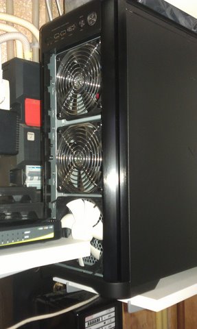

I am planning on working with the three 4 in 3 cages I just mentioned, they will blow air from 3 12 cm fans from the front side of the case, over the drives towards the MB, PSU area. Cpu will be cooled by the stock cooler at the moment and there's one 14 cm. case fan in the upper back of the case pulling air out of the case. Is this enough cooling?

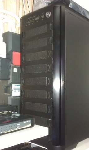

Attached are some pics of my case in the closet where it will sit during his working hours. WAF is higher that way, what she does not see, is not there ;-)
As you can see there is nothing to see about the 4 in 3 with everything in place.
