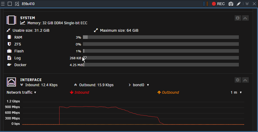

Not mean to deny your words, but my test setup is clearly shows actual ARC usage in Unraid's main array of ZFS-formatted HDDs:
- fresh Unraid with no VMs or Dockers,
- 1 parity and 2 data HDDs in main array (all three are old 500 GB SATA II Hitachi Desktars, Unraid settings for filesystem is set to ZFS),
- 12 GB RAM reserved for ARC with "options zfs zfs_arc_max=12582912" in zfs.conf,
- 1 GbE Unraid network card
- 10 GbE network card for source file transfer (Windows 11 PC)
resulted in stable transfer over 100 MB/s throughput (102-105 MB/s) until ARC was over, then transfer dropped to ~25-30 MB/s. After that I delete copied file from Unraid's share - ARC drops to 0% full, start copying again - it starts growing immidiately.
How is it possible?

As I said before in https://forums.unraid.net/topic/166724-zfs-arc-vs-unraid-cache-priority/#comment-1424125, while 12 GB ARC had space in it, my transfer speed over 1GbE link was ~103 MB/s sharp, it sustained much longer than 5 seconds.
It's really strange, let me fire it and test it again.

I take back my statement, but not completely: my 12 GB ARC was not filled till 100% before speed dropped, only about 40%, which took ~20 seconds, but not 5 :)
