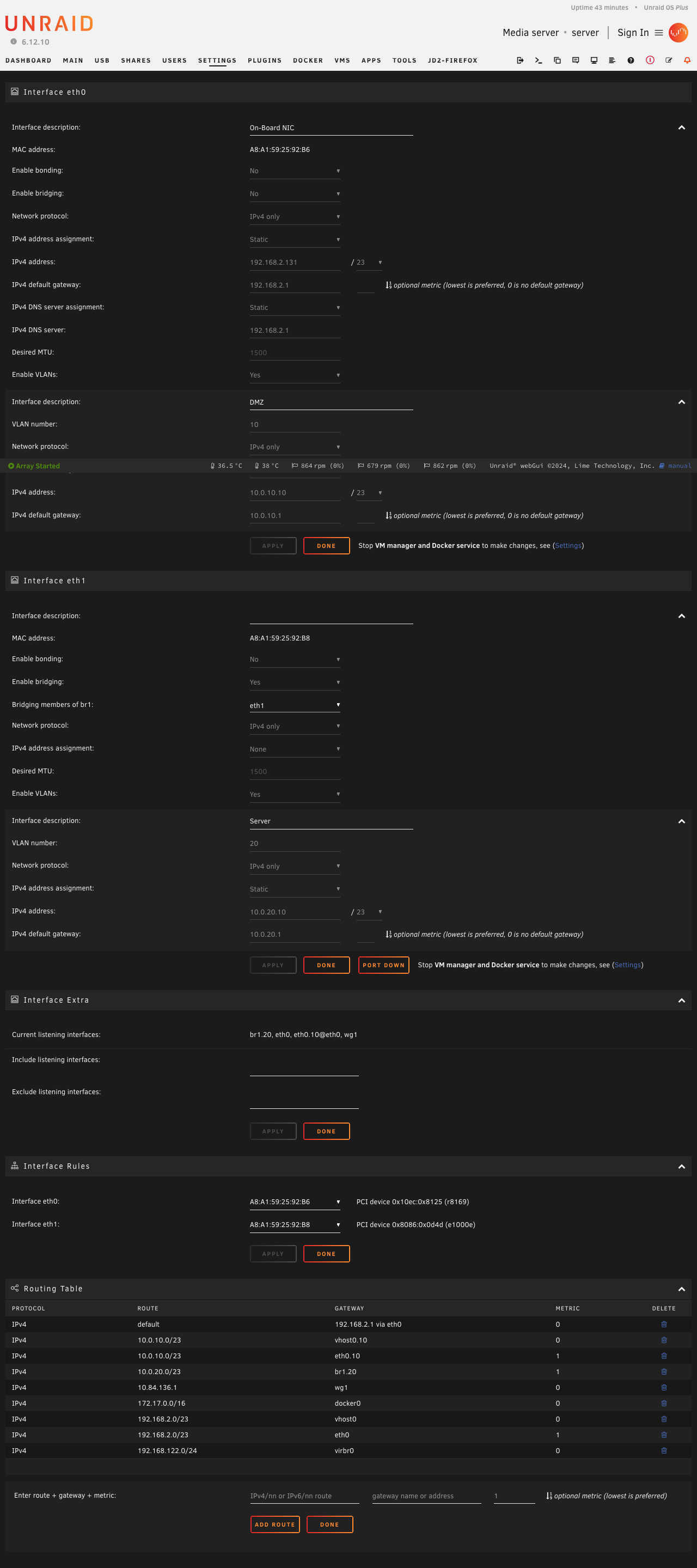

I'm currently in the process of migrating my network and separating all services onto different VLANs. Since I'm using Ubiquiti networking gear, I had to switch back to using macvlan for my Docker containers based on the recommendations in the Unraid 6.12.4 release notes. The network part of the migration is working fine, and I followed all the required changes listed in the 6.12.4 changelog to use macvlan successfully:
  • Disabled bridging on eth0 (main interface)
  • Kept bridging enabled on eth1 with my Docker VLANs
  • Enabled "Host access to custom networks" in Docker settings
However, I'm still running into stability issues after some hours of uptime. The server crashes and becomes unreachable, with call trace errors showing up in the logs. This seems to also cause other issues like Docker randomly shutting down and restarting, as well as BTRFS errors appearing in the syslog.

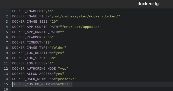

I noticed that in my docker.cfg file, only "br1" is listed as the custom Docker network. When I try to change this, it reverts back after restarting the Docker service.
I've attached the syslog from the last few days capturing the crashes and call traces, along with the latest diagnostics package and my current network.cfg and docker.cfg files. Any help or suggestions on resolving these crashes and call trace issues would be greatly appreciated! Let me know if you need any other information from me.
Thanks in advance!

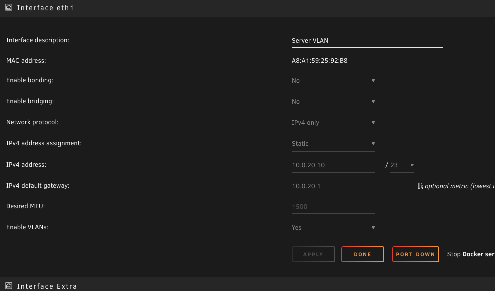

If docker is using eth1 you need to disable bridging there.
But when disabling the bridge, i can no longer use the vlan which is tagged to eth1
EDIT: Solved it by tagging the VLAN on the Switch port and set the ip settings on eth1 matching to the vlan. I will let the server run then for some time, hopefully it is no longer crashing. Thanks for the quick answer :)
Edited by CryPt00n
