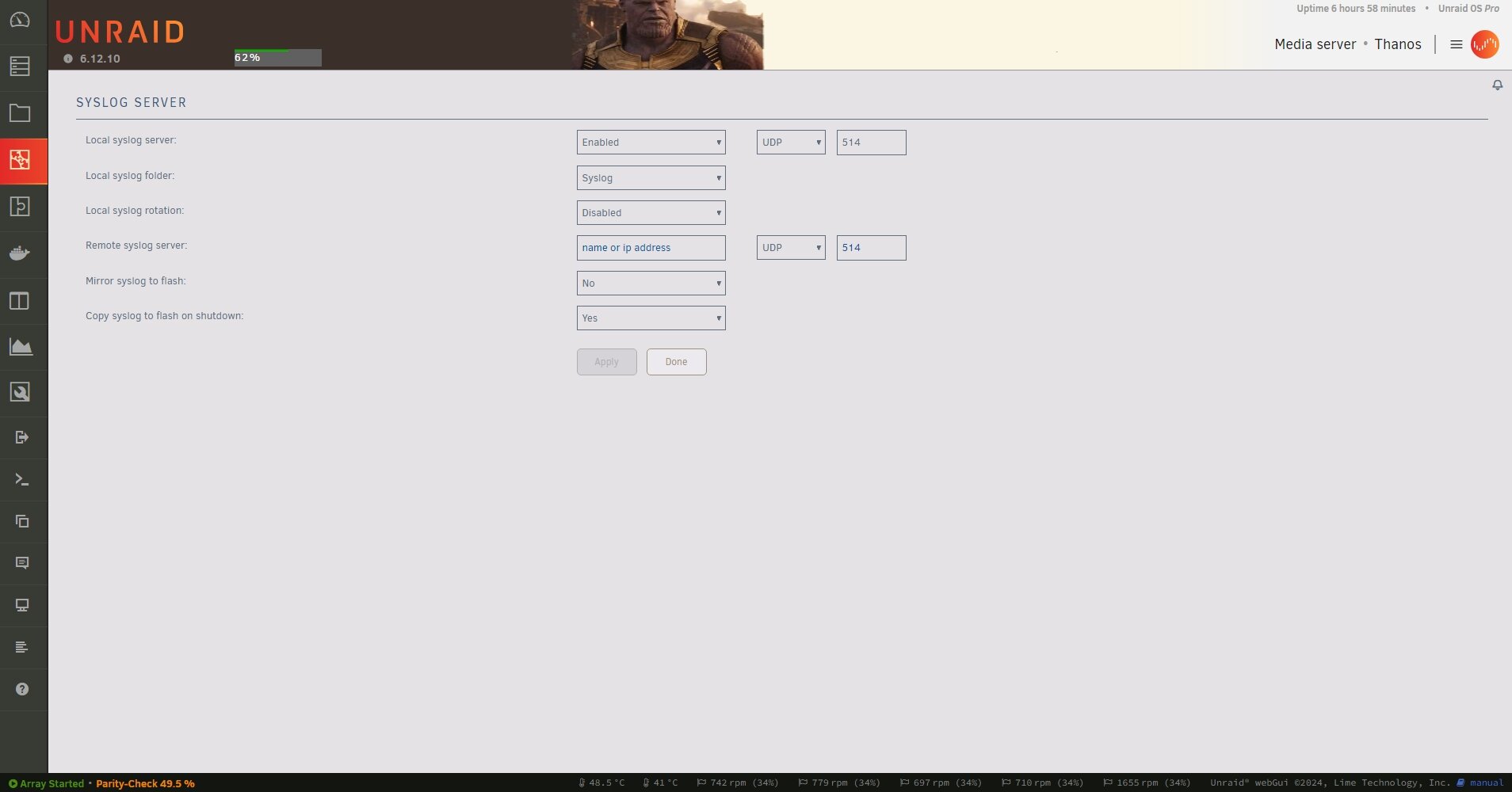

Post a screenshot of the syslog server settings.
Hi, ok so this is how i had the syslog settings
You are missing the remote syslog server, see the instructions and enter the local server IP, or just enable the mirror to flash drive option.

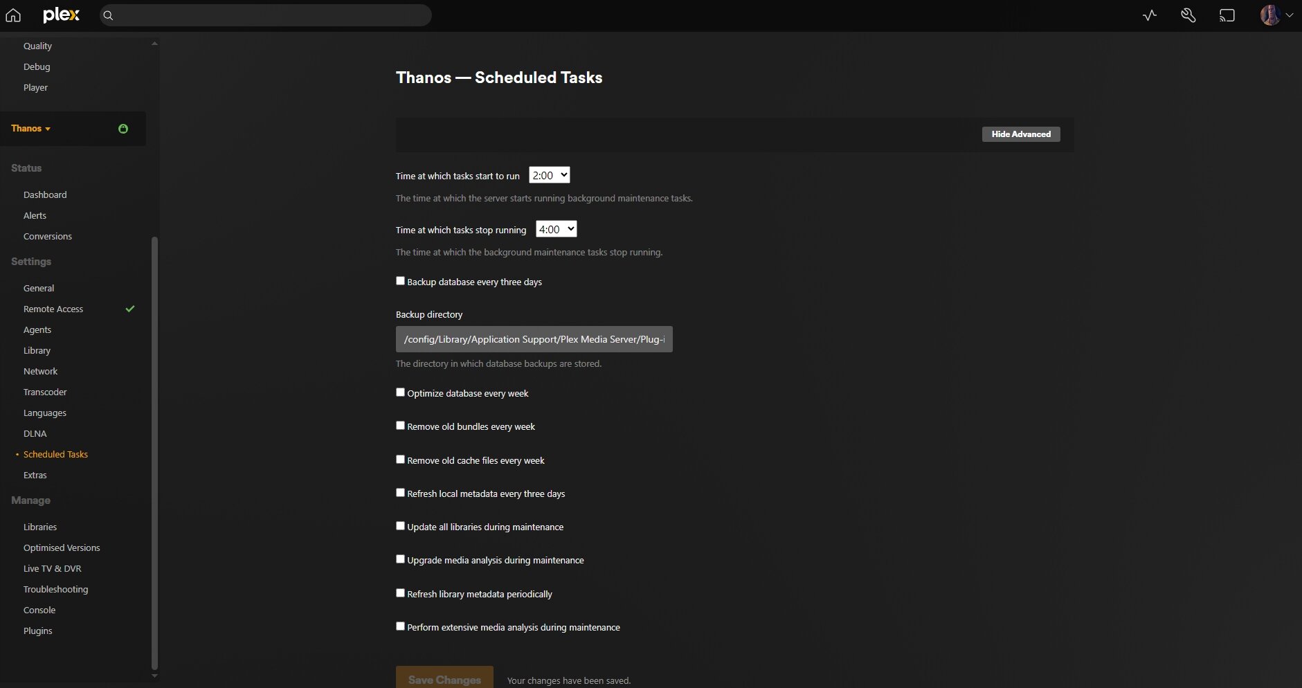

So firstly thank you for your help I think I have now pinpointed the problem being with plex running scehduled background tasks as once I knew the error messages were coming from plex I was looking through all the settings on there and noticed that the background tasks were set to happen between 2am and 4am which matched exactly with my issues
Last night I set these to 9am to 10am and it shut down just before 10am so seem to point towards this being the cause I will now hunt through the plex related posts to try and work out what I need to change to stop this from continuing to happen maybe it needs a longer window to perfom them all and is crashing due to not completing
