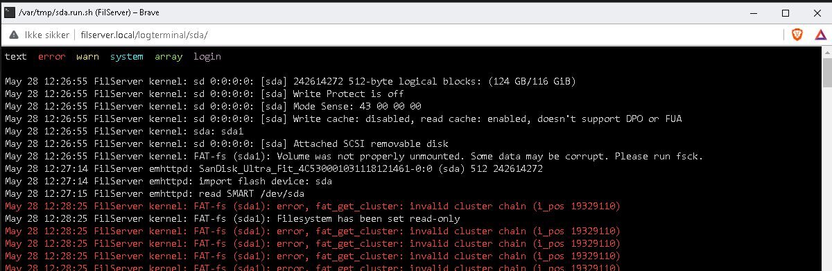

I get this when I choose disklog information under my flash drive in the main window
Does that mean that I have to change USB stick, and is it the reason that I can't create a certificate under /settings/managementaccess/
First thing I would do is to stop the array.   Then shut the server down.  Pull the Flash drive.
Then plug it into your PC and run chkdsk on it.    Report if chkdsk could correct the issue.  Then look in the root of the flash drive for files named  FILEXXXX.CHK  (where XXXX are sequential numbers).

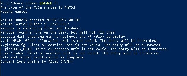

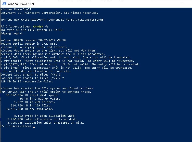

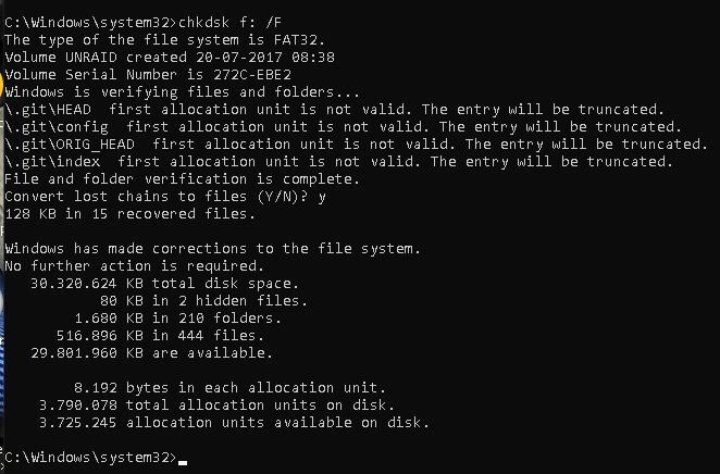

As suggested by Frank1940 I ran a chkdsk as admin on my winbox, and it has been repaired/restored
I had to boot in as admin to make repairs so I jumped from Powershell to command prompt that I am more usaed to

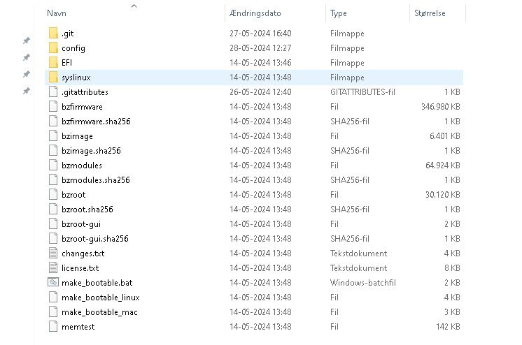

I can't seem to find any FILEXXXX.CHK
That is good.  It is what you want!

Okay now everything is up and running it seems
