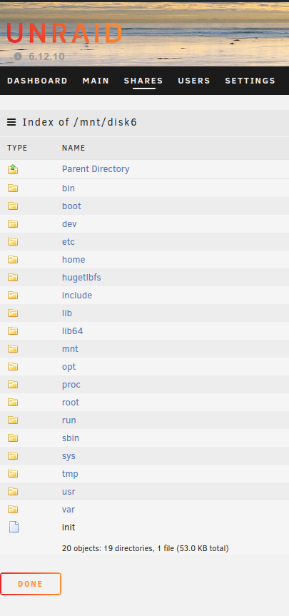

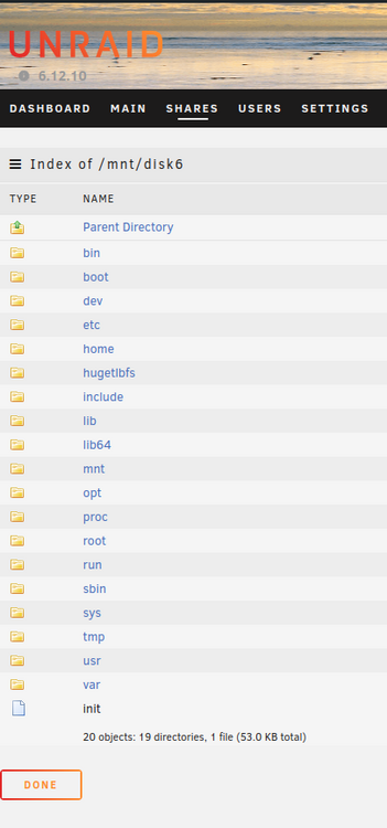

I just fired up Plex to watch a few TV shows and noticed that large chunks of TV episodes were missing. When I had a look at my Unraid server I noticed that Disk 6 is acting really strange. I've had a few disks die on me, but I've never had this happen. In the Unraid UI the file contents of disk 6 - rather than listing my shares - seems to be listing the contents of the underlying OS root!

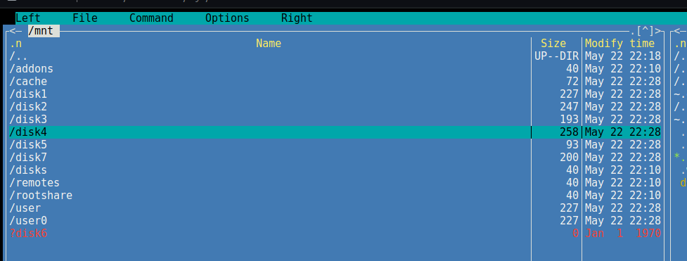

When I bring up a terminal window and use mc tolist the contents of /mnt everything appears AOK except for disk6 which is listed in red and has a question mark in front of it! When I double-click on "disk6" mc states "Error: Cannot read directory contents"

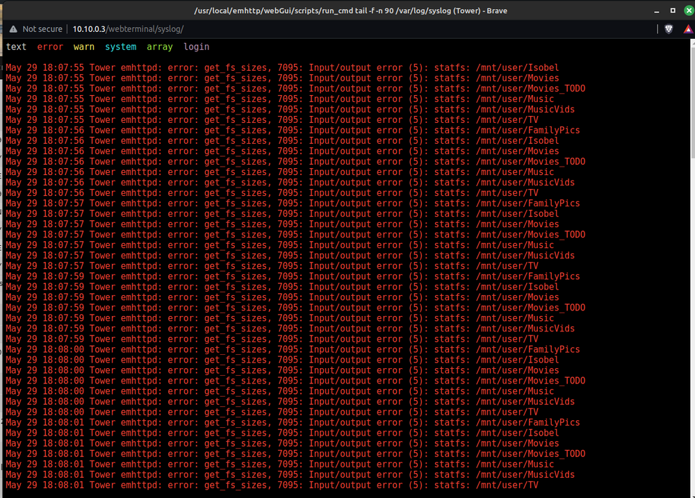

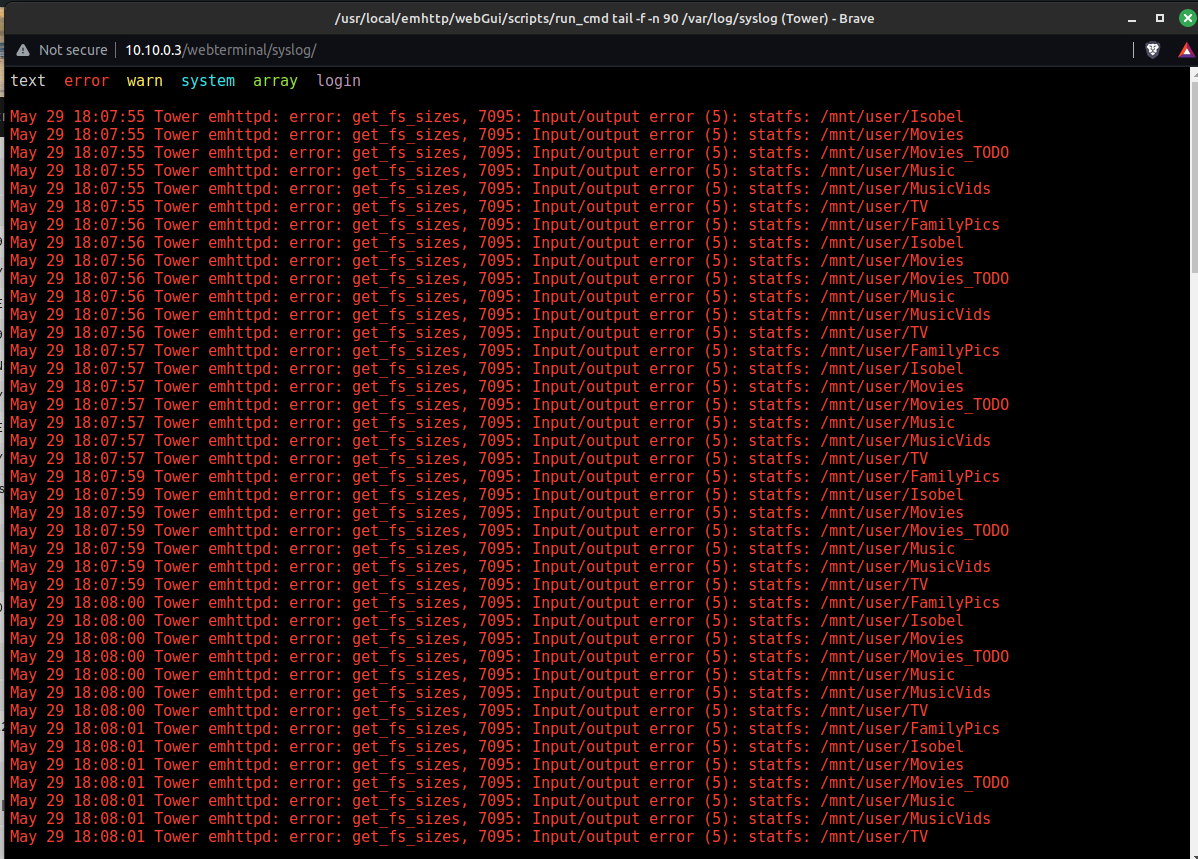

My syslog looks like this:
I have dumped the diagnostics file. Looking at syslog1.txt I can see lines like this:
May 28 18:24:37 Tower kernel: XFS (md6p1): Corruption detected. Unmount and run xfs_repair
