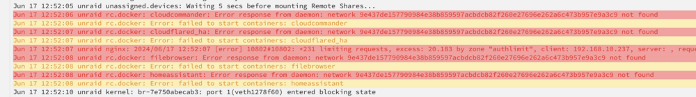

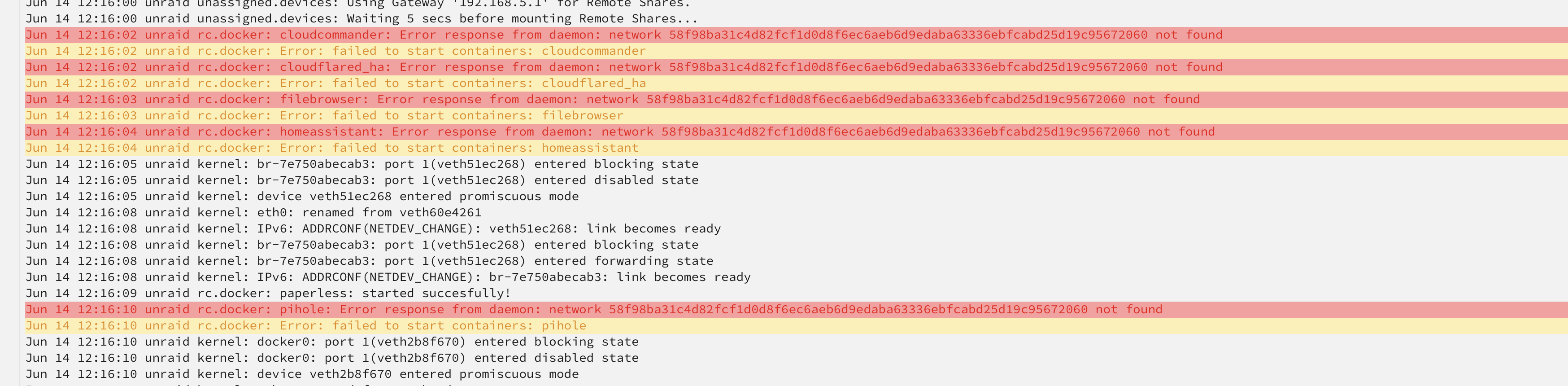

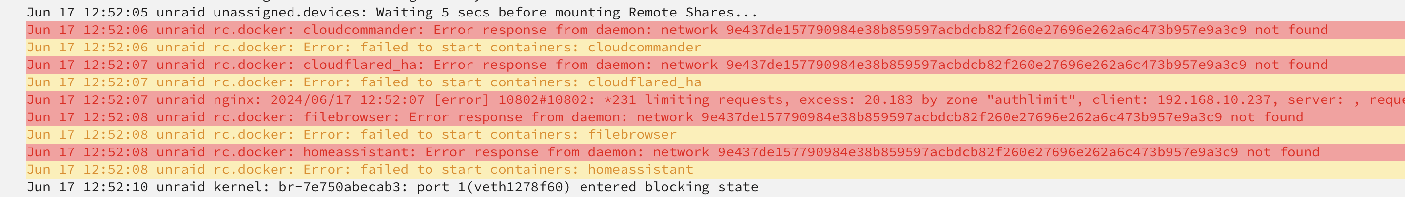

Oh looks like that was the issue. No more traces in the logs 😀. I switched to ipvlan, but now when I reboot the docker all my dockers that uses custom network with static IP are not starting. I get this error

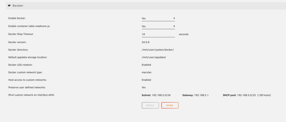

These are the settings I have in the docker networksScreenshot2024-06-14at12_59_26PM.thumb.png.84c66c9048b2bf196793f9bc07226b59.png

Even with the macvlan, bridging disabled, I am getting the network not found error. switching either to ipvan or macvlan doesn't start up the custom network. All my dockers are custom, all start fine, except the one that are external are not starting up.
I think I have all the settings correct.

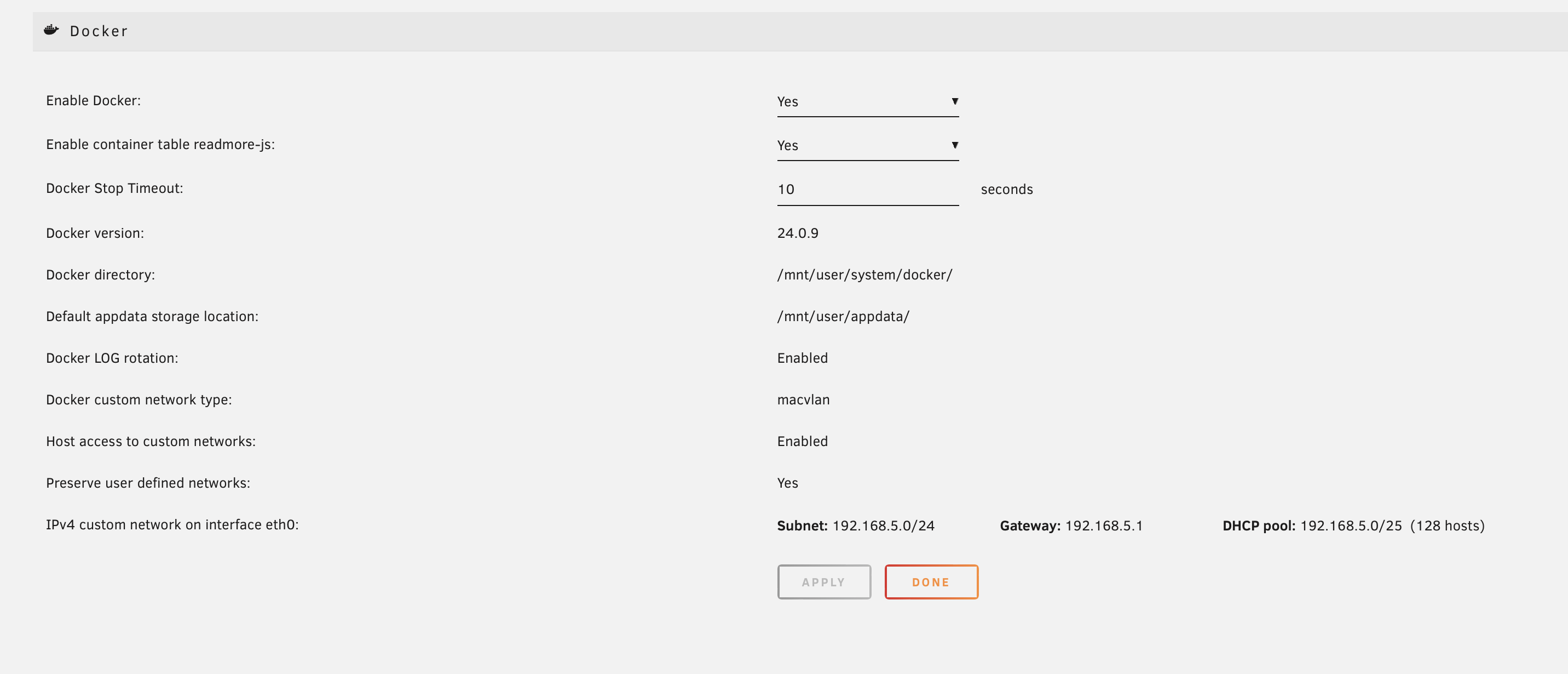

And this is the docker:

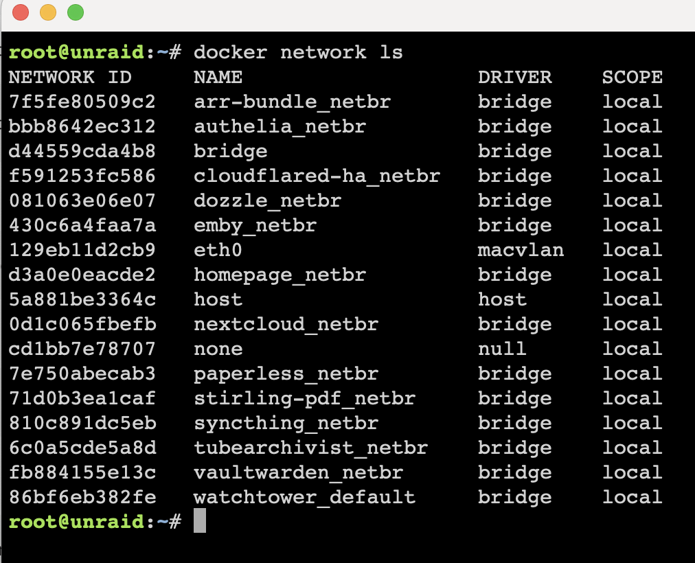

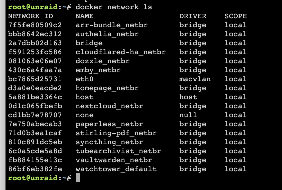

my custom networks:

I think I might have found the issue, but I am not sure how to resolve it. Everytime I do enable/disable docker it doesn't preserve my network, with macvlan as well as ipvlan.
Now the id is different, even though I have preserve user defined networks enabled. Am I doing anything wrong?

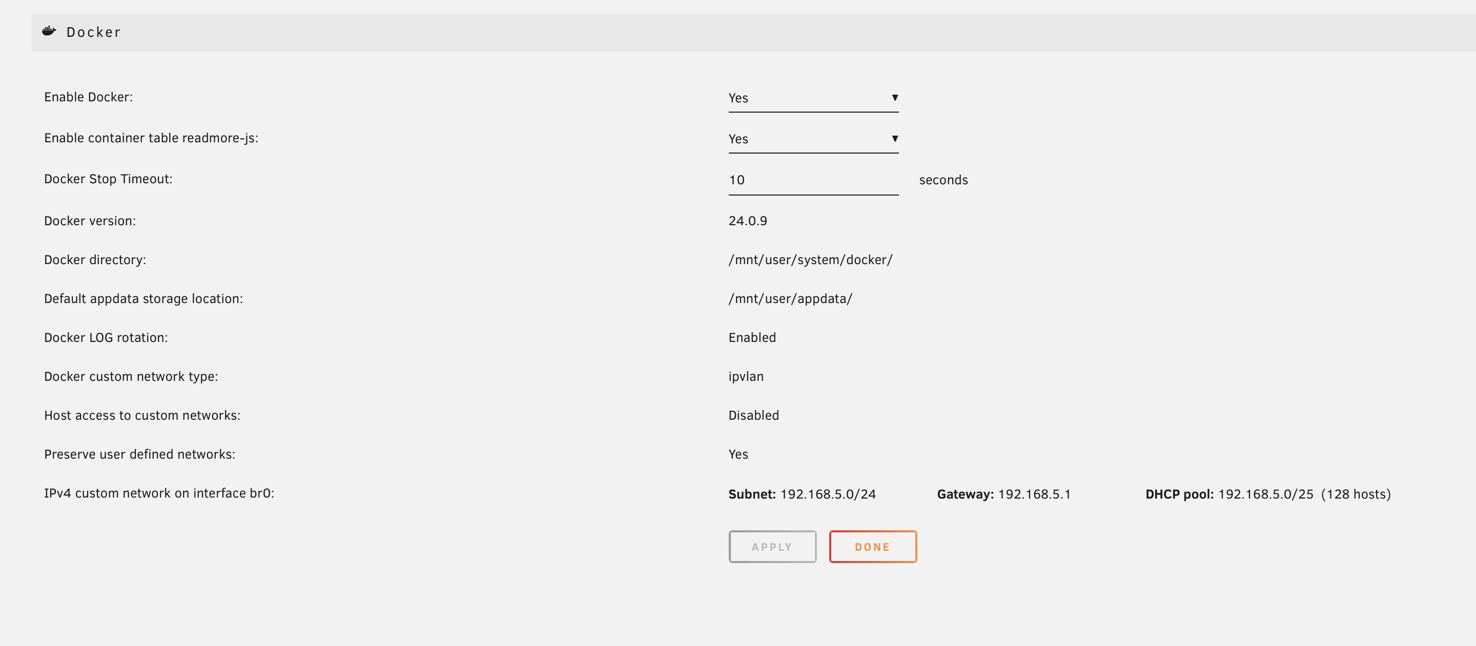

Before recreating the docker image, I wanted to try to create a different network with parent as br0 (for ipvlan) in one container and use it in other containers. With this configuration it works somehow. If I enable/disable the docker everythig start now.
Created main network from pihole container and used the same network in other container as below.
