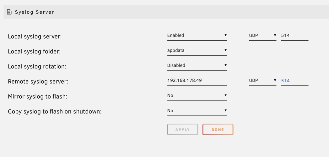

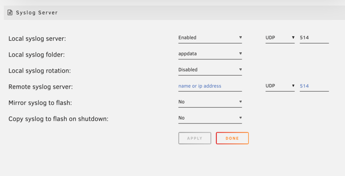

Sure. Thanks for being so patient
image.thumb.png.cbea69b6090d9ff9e8334e3447fc9ad2.pngimage.thumb.png.cbea69b6090d9ff9e8334e3447fc9ad2.png
That has only configured the syslog server in "Listen" mode.    As mentioned in the syslog server link you need to fill in either the Mirror to flash option or put your Unraid server's address into the Remote syslog server field to actually start getting something recorded.
Ok, wow, that was not transparent to me. Didn’t get, that that is a precondition. Did now. Thanks a lot. Then I wait for the next crash now.
