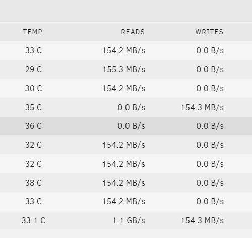

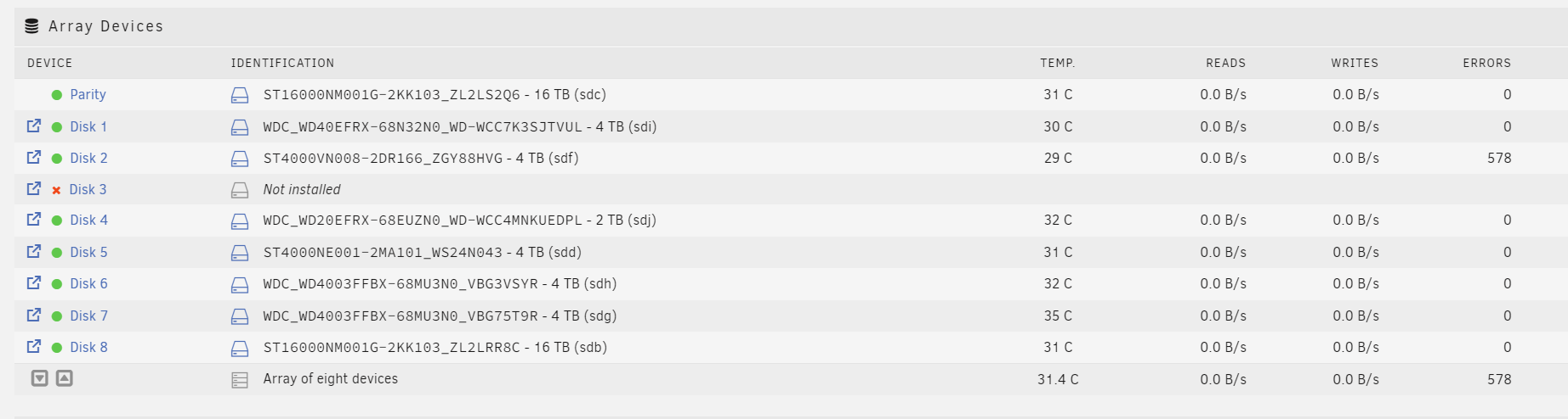

I've got today some UDMC errors on 2 drives. On one there was only 1 error, on another drive there was 8 and it has been disabled, so I changed the cables and started the rebuild by re-enabling the drive that got disabled.
I'm an Unraid user for over 9 years now so I did my fair share of drive replacements and array rebuilds, they were always going at max drive speeds, but this one now is very weird. The drives seem to jump around and the speed is only around 30-40MB/s
First I thought that maybe one of the dockers or the VM is reading/writing something to the array. Although unlikely, but it's been few hours and it's still like that...
Here is a video of the machine: https://drive.google.com/file/d/1NUtch5smwJ5RbYMIEQRtYUb9BSoxUXDI/view?usp=sharing
Here is a screenshot of the array: https://drive.google.com/file/d/1daZOaKxv1opOJrOxY5I5ayTxQPsEuWRK/view?usp=sharing
I don't know if it matters, but most of the drives are connected via LSI SAS2008.
Should I be worried that the LSI card is failing or what is going on?

That is weird. The rebuild has been going on for 8h now. Regarding the Macvlan I never had problems. I saw that warning, switched the Macvlan off and then had problems with my VMs not being accesible on local network, so I just switched it back.
Edited by Trylo
Even with disables VMs and Docker it's the same: the slow speed and the searching sound of the drives. I can try to change these settings, but I think I need to wait for the rebuild to be completed.
LOL. All of the sudden the speed is back where it should be. It happened just after 2TB mark so it makes me think if the 2TB drive (I have only one old 2TB drive there, the rest is 4TB and 16TB) is at fault...
 I'm starting to think there is something wrong with my LSI SAS2008.
I'm pre-clearing a new drive now and it's going very slow.
It's going 50-70MB/s and dropping sometimes to almost 0.
What do you guys think about this?

And here is from the other one that just showed 578 errors:
root@NAS:~# smartctl -a /dev/sdf

1 minute ago, JorgeB said:
You could have a power issue, with the PSU itself or the connections, are you using any splitters?
Yes, I am.
SMART looks fine, so most likely power/connection issue, avoid splitters, especially if they are splitting one plug to more than 2 disks.
Thank you for your help. I found a PSU with native 11 SATA connectors, so I'm going to drive now and buy it. Hopefully this will solve my problems.
I think that was it. I've changed the PSU. No more splitters for drives. The pre-clear has been going for almost an hour now at full speed and no more errors on any drives.
It's a shame I spent money on a drive I didn't need to change, but oh well...
