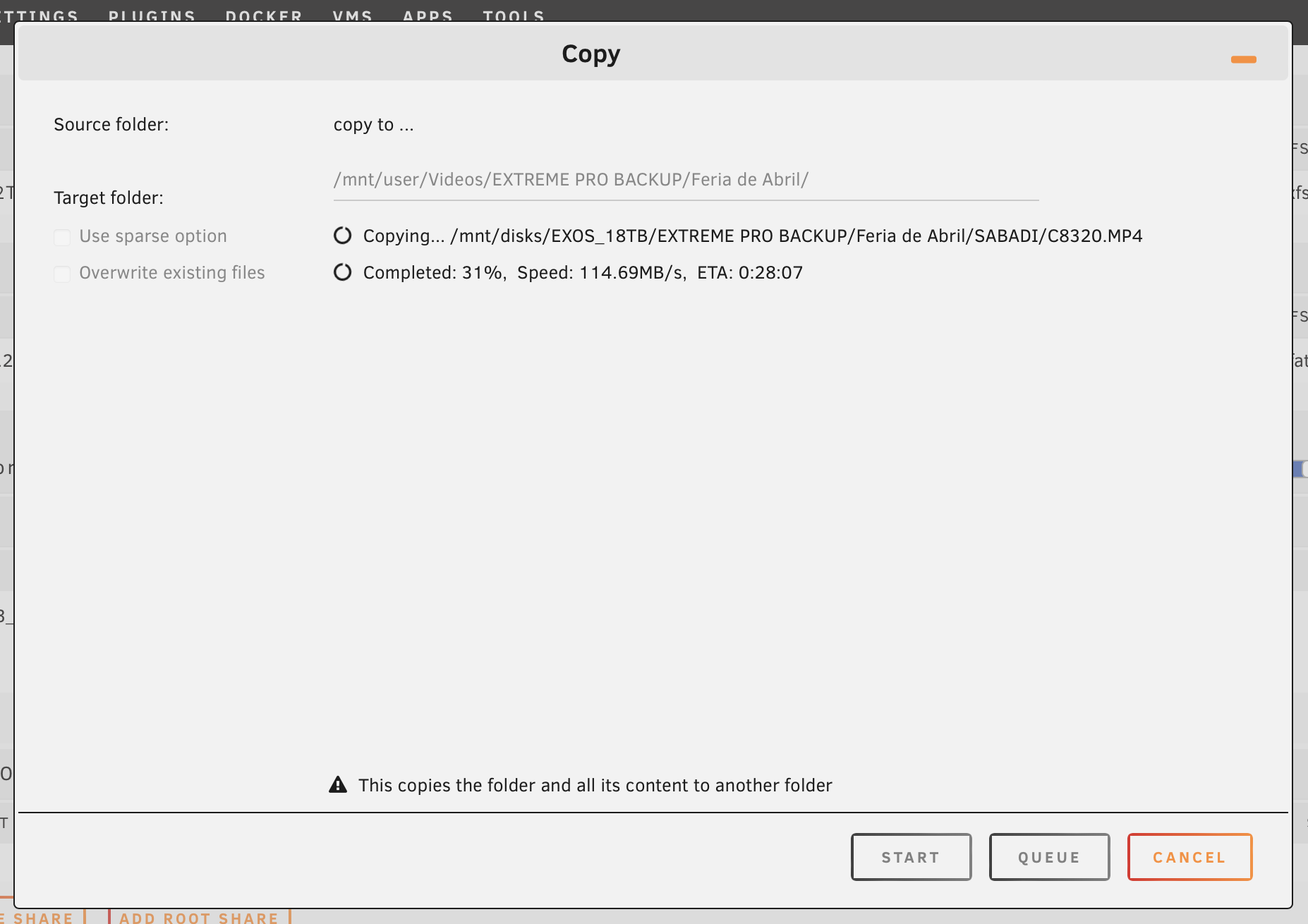

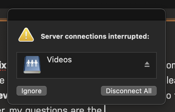

sexybard-diagnostics-20240601-0151.zipsexybard-diagnostics-20240601-0151.ziphey guys, so I haven't gone back to the Krusader, I downloaded the Dynamix File Manager and I tried to look up some tutorials on YouTube but couldn't find anything. I read somewhere that you can control sharing files within the Main section of the raid, would that be called the GUI? please correct me if I'm mistaken. I'm still learning every single minute of the day when it comes to this and what I did on the Unassigned Disk Devices was find a folder to copy over to the unRaid server by right clicking on the file then it would open up the trajectory so I could choose a specific folder and it started copying over, my questions are the following: I will add screenshots for context. Why does the server connections get interrupted? will this interrupt the transfer of files? I noticed when going back into the unRaid the files are still transferring even though it lost connection. But a second time it lost connection it stopped transferring and I had to manually select the missing files in the folder that didn't copy to start where it left off. I wan't to understand as I'm looking for a stable way for this to not let me down. Also if there's no problem whilst closing the server and ejecting the folder connected to the MacBook that is linked to the server. Will the files still transfer? is there a message when the transfers are complete to let you know that it was successful?
Thank you guys. for your time and help.
** I just edited the post because I keep getting disconnected from the server whilst I'm trying to select the files I need to copy over. I uploaded the Diagnostics which I think I uploaded twice, sorry for that!!!** Just got logged out right about 2 minutes ago so it should show up guessing?
Edited by ztatzu
