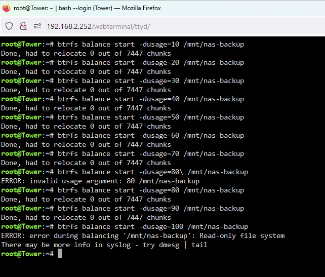

Try stopping and restarting the array, then run the balance again, if it still goes read-only, you will need to free up some more space.
It needs to relocate a few chunks, try with -dusage=20, and if still 0 relocated chunks, try 30, etc
ehhhh??? im confused. Do i restart the array again and try 100 again? Do i move more off the pool?
That's weird, re-start the array and post new diags.

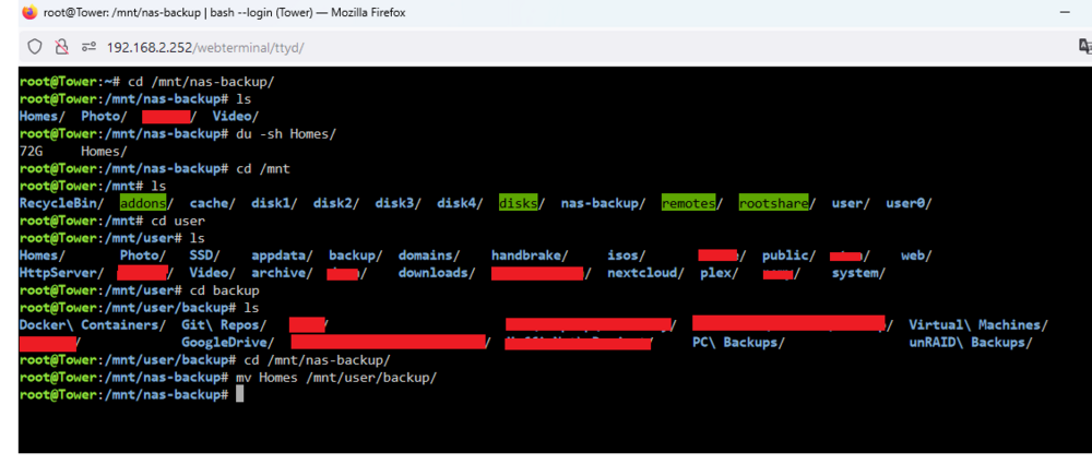

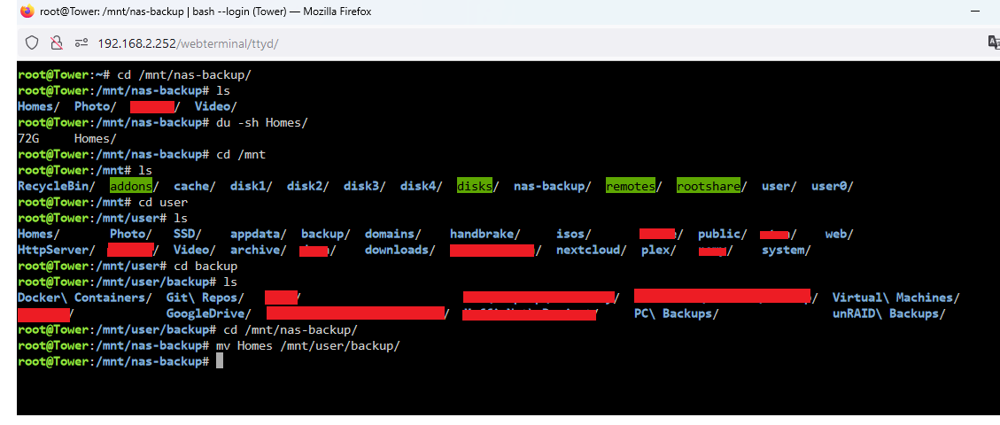

Huh.... i just noticed the 72G folder that i moved off the pool is back on it. But it's also still in the folder that i moved it to. And both are 72G
Edited by YourNightmar3
Possibly the pool was read-only when you tried before, try again now, and post new diags after the move.
That's odd because im pretty sure  saw the used space in the UI benig a bit less on the drive that i moved the folder off of.

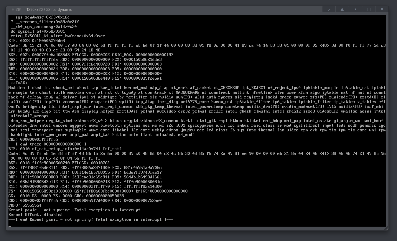

The entire server just crashed suddenly, i've never seen this before.
Do you know which device is this?

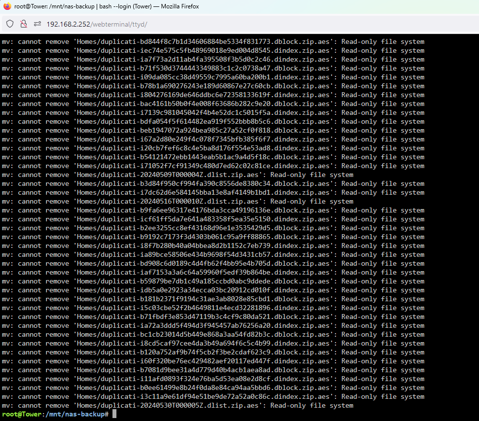

And immediately after starting the array, the pool is readonly again :/

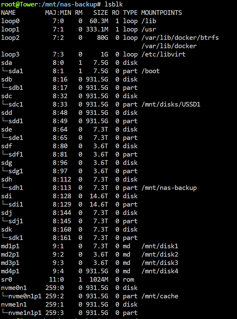

It's not the flash drive, looks like it's a SanDisk_SSD_PLUS_1000GB, and it's not USB, but it has the same ID as another one, that's not normal with SATA devices.
Ah, i took a look into the physical machine and you're right. There is a SanDisk_SSD_PLUS_1000GB still connected that has died. I used to have two of them for my cache, i now have two nvme ssd's for my cache and both of those Sandisk SATA ssd's are still wired up while one is dead. It's been in there for i think well over a year at this point.
