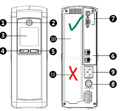

You say when on battery everything immediately "shuts down", you mean a graceful shutdown or the power to everything just gets cut? Are you sure you have connected everything to the top outlets (Nr. 10 in picture)? The bottom outlets (Nr. 11 in picture) just provide surge protection, not battery protection.

My CyberPower UPS is like in this picture, If I'm not mistaken, all the sockets are Battery Backup + Surge Protected Outlets
However, I had tried both the first hold at the top and the last one at the bottom:
