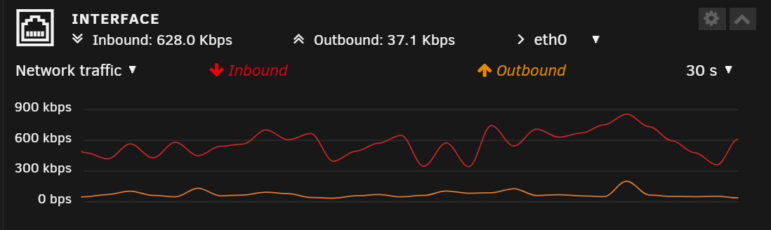

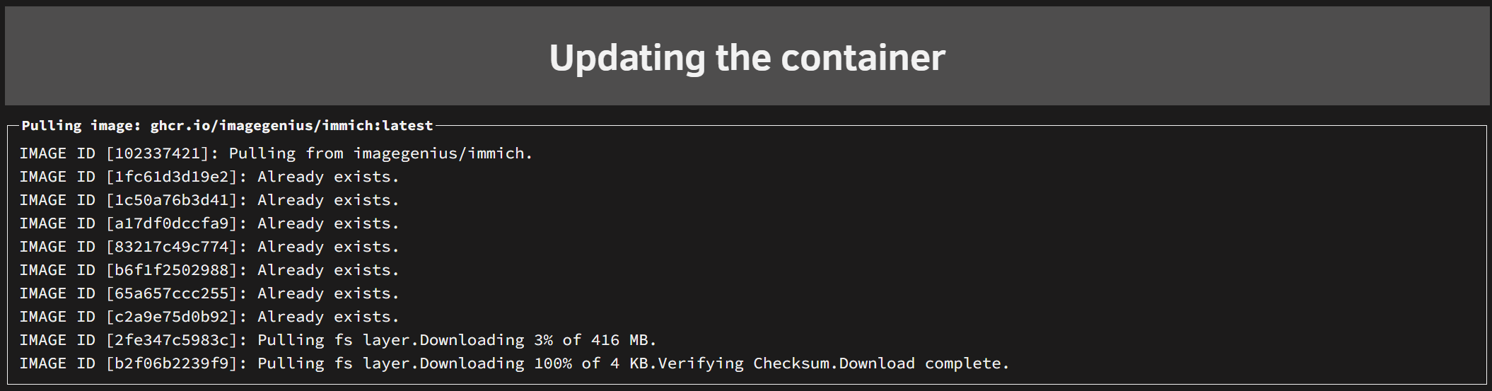

So I got around to rebooting my routers but it didn't help. Downloading immich update now from ghcr.io/imagegenius/immich:latest at ~300-600Kbps (<75KB/s) 😪
For a 416MB package it will take me ~50 minutes.
