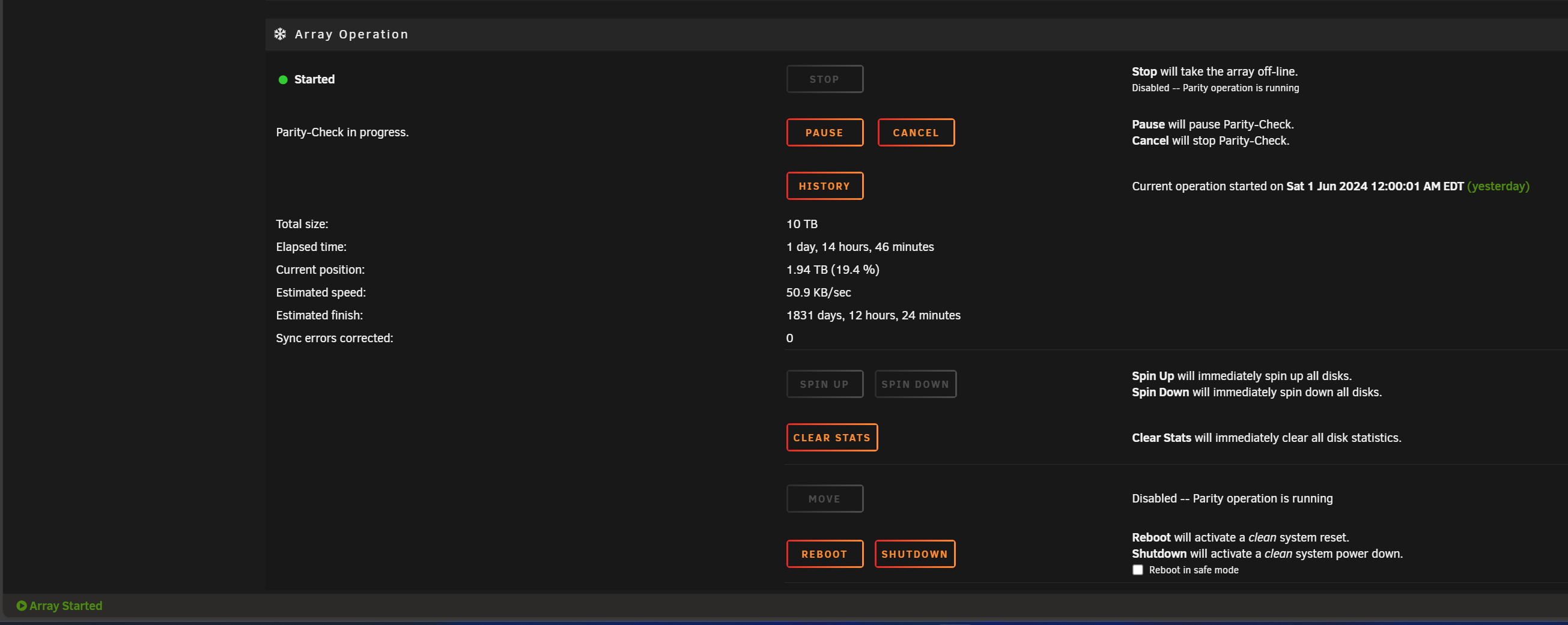

I logged in today and saw the parity check was only at 19% it typically finishes within 24 hours. I took a quick look at the logs and saw a lot of errors that I can't make sense of.  Could this be an issue with the new hardware? Or is this all due to the warm disk warning I got when the parity check first started? I'm not sure how to proceed or what my next steps should be, diag attached. Thanks in advance for any help.

I've tried to both pause and cancel the parity check with no success. My server seems to be a in half way state where it shows the option to pause or stop the parity check but at the bottom it no longer says the parity check is running. I've also attached a new diag that hopefully shows why the parity check didn't pause or cancel.

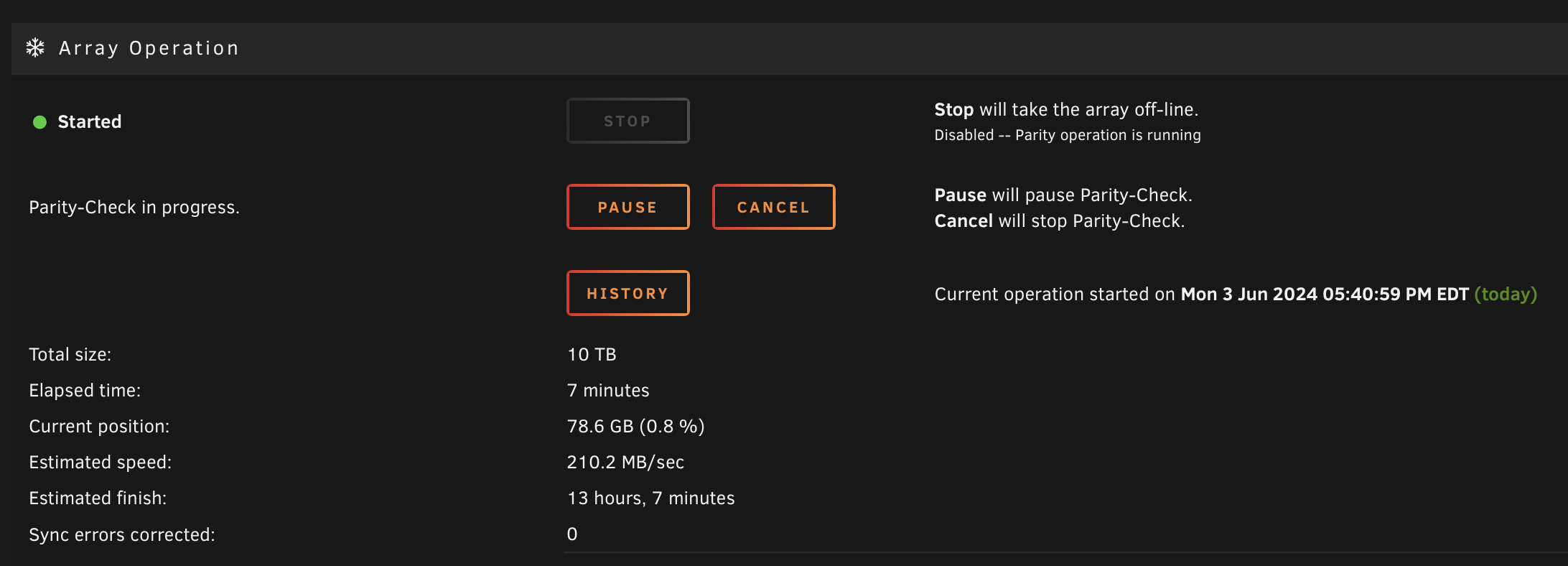

BIOS update did not seem to do anything. I also forgot that bios updates wipe the current bios config so I tried my best to match things up as best I could. I'll need to go back in later and readjust my fan curves again but that's an issue for a later date.
I'm still seeing quite a few ACPI warnings and errors in the logs, not sure what I"m missing here. The parity check does seem to be running at its normal speed... for now anyway.
