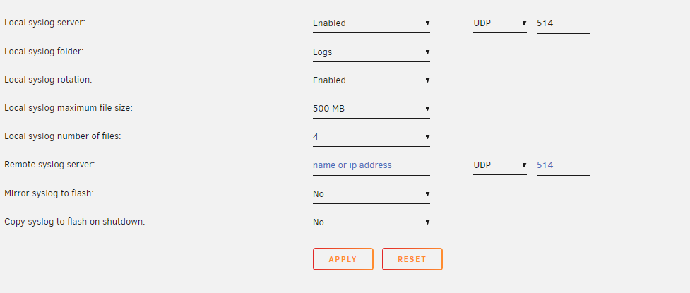

did set up a log server,
A common mistake is not to set either the Mirror to Flash option OR to set the Unraid Server address into the Remote Server field.    If neither set is set then nothing will be recorded.
I thought if I wanted to not write to the flash drive, but to one of my actual cache drives I didn't select mirror syslog to flash. I have it set like this currently.

To achieve what you want you need to put your server’s address into the Remote Syslog Server field as mentioned into the syslog server link.
Done that, doing SMART tests currently to test for more hardware issues. Will report back if I manage to catch some logs that say what happened on unclean shutdown.
