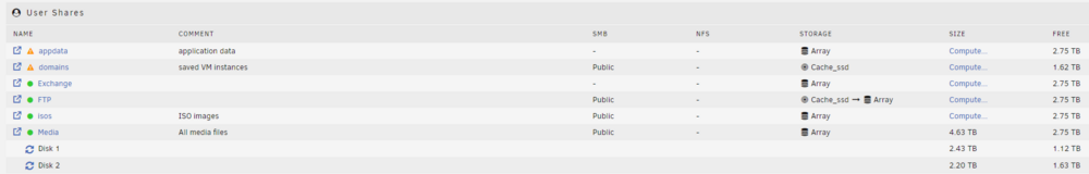

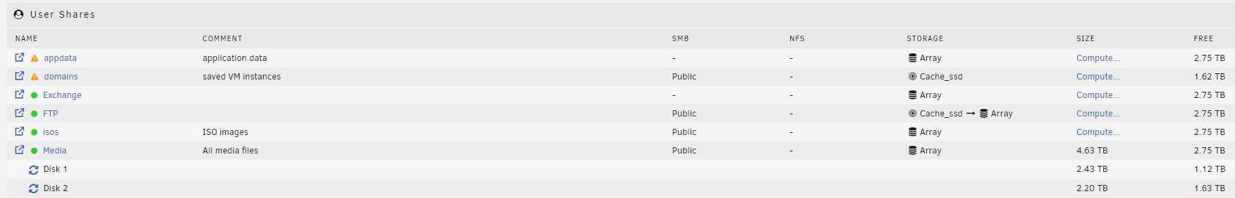

I have a bit of an issue. I have user share named "Media", which is used as SMB network drive.

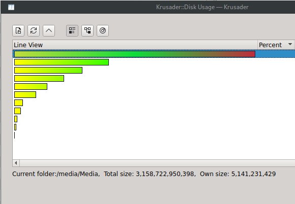

My problem is, there is about 3.2TB files on it - i get about same info in windows explorer, Windirstat, Krusader and when in user shares calculate all files and folders containing in MEDIA folder.
But when i compute MEDIA folder under user shares, i get about 4.6TB used - which is wrong. Also under MAIN tab, used free space aligns with 4.6TB, not 3.2TH which is actual.

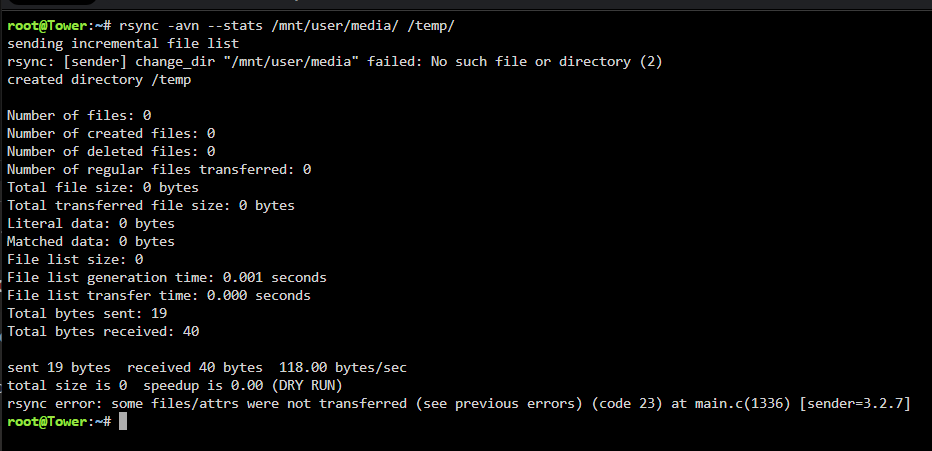

Post the stats that show in the end for:
rsync -avn --stats /mnt/user/media/ /temp/

Temp seem to be empty

Sorry, looks like the share is Media, not media.
rsync -avn --stats /mnt/user/Media/ /temp/

A ok, i understand. Thought that command was just checking for "temp" content, so results seemed ok to me.

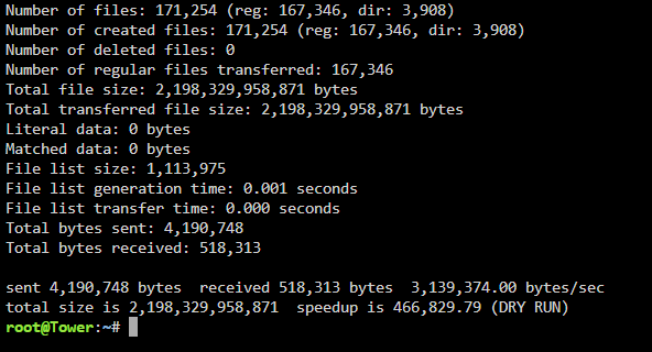

Here are new ones.
BTW, if it helps. There are two folders of which content got lost after an update a while ago. They are both empty, both are stated as 0 files/folders/MB, but size of missing files is similar to the size that is "Taken" - 1.4TB. Maybe there is some sort of connection, which i can't find

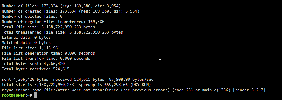

Run disk by disk now:
rsync -avn --stats /mnt/disk1/Media/ /temp/
and
rsync -avn --stats /mnt/disk2/Media/ /temp/
Strange, here is 4.6TB. And this looks like two missing folders.. about 3k files and 1.4TB difference - those must be missing movies and series, since it looks like they are "bigger" files

No issues with pools since /mnt/user is the same as /mnt/user0, but since both disks individually have more data then /mnt/user, it suggests you have duplicate files in both disks, and when using /mn/user, only the first copy of those files will show up.
