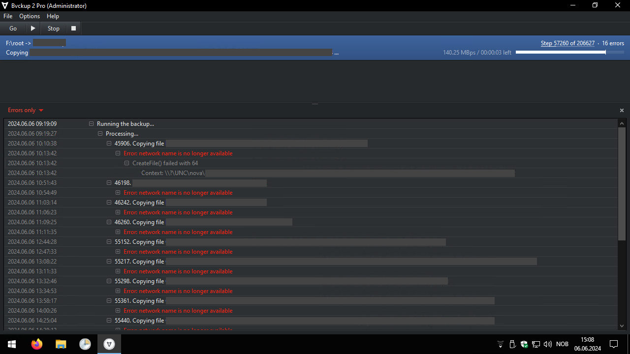

I am in the process of copying the contents of a whole drive to my Unraid array. Since the drive is encrypted with BitLocker I have to do this through a Windows virtual machine.
The problem I am facing is that the network share seems to become unavailable intermittently. After about 10 to 115 seconds it comes back. This does not seem to occur if I am not copying files in the VM. During the outage of the network share the share becomes unavailable for all clients, not just the VM.
In the screenshot below you can see that the backup software I am using (Bvckup 2 Pro) is giving me errors that the network name is no longer available. However, the problem persists even if I am just copying files using Windows Explorer.
I don't know if this is a common issue, but I was hoping anyone could point me in the right direction, as I have no idea how to troubleshoot this.

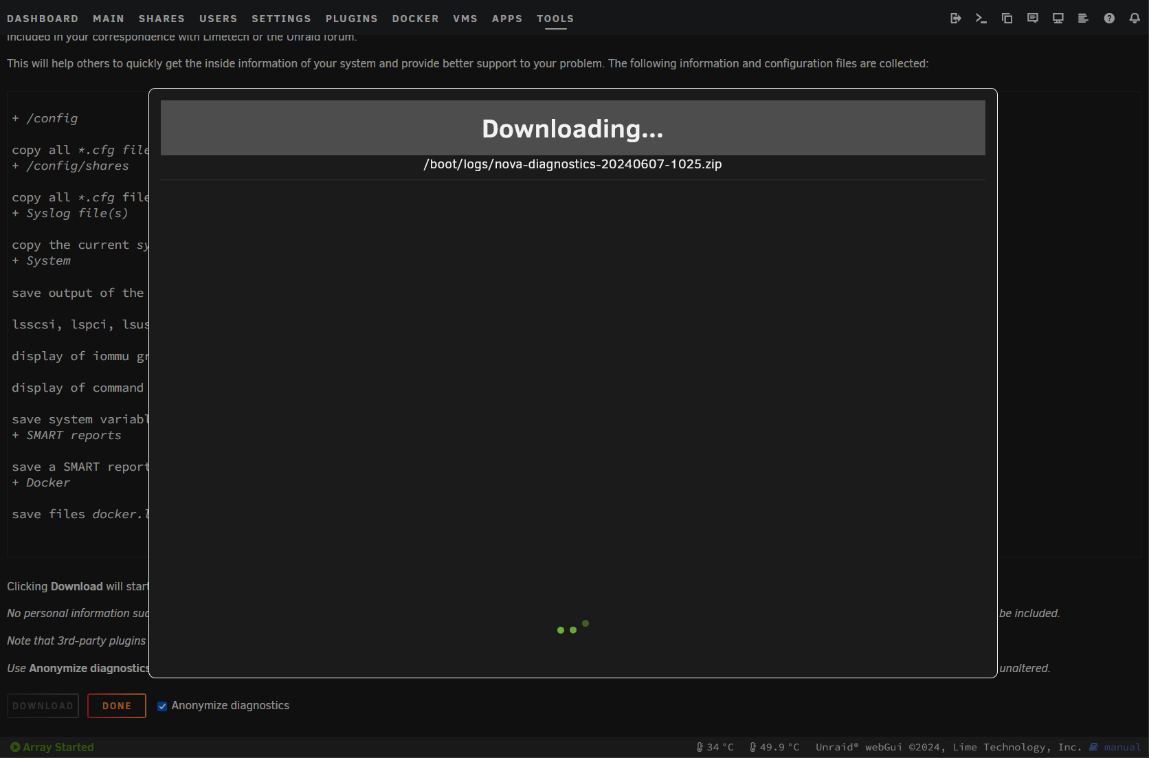

When I am trying to export a diagnostics using the tools it's just forever stuck like this:

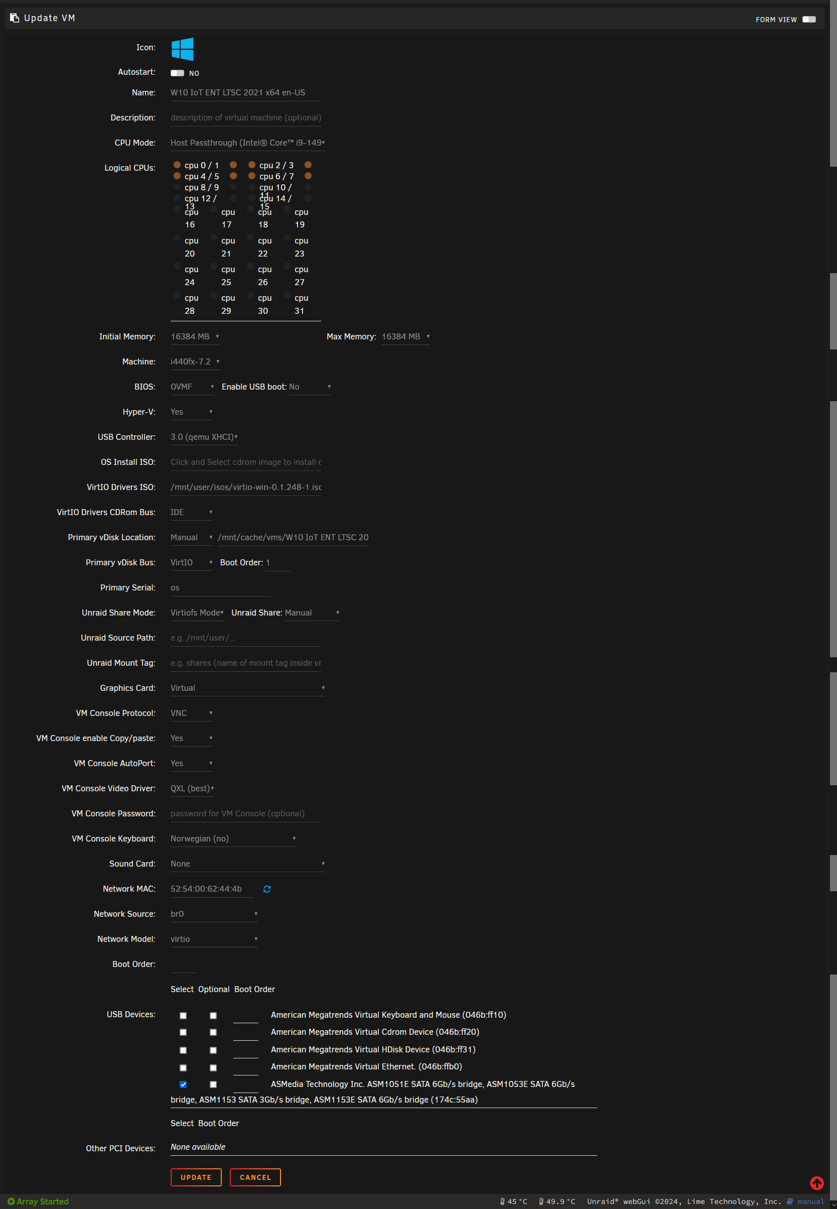

I don't see anything else logged that would explain the problem, post a screenshot from the VM form page, showing the complete config, you can post multiple screenshots if needed.
Sure. Here it is.

Googling that debugfs error it appears to be mostly harmless, though can't rule out if it's related, especially since the timing is around when the issue occurred.
Regarding the VM config, it looks good to me, but try changing the virtual NIC to virtio-net, and see if it's any better.

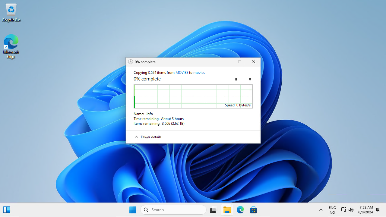

Here is a video recording showing what is happening. It shows that the copy times out for no apparent reason. On the right side, I am continually pinging my Unraid server, which always responds. On the left, I am using ping.canbeuseful.com/ to continually check for WAN dropouts in case there are problems with my router.
Everything seems normal. However, I should mention that I had a bunch of PCIe warnings in the log previously. I don't know if that is the problem.

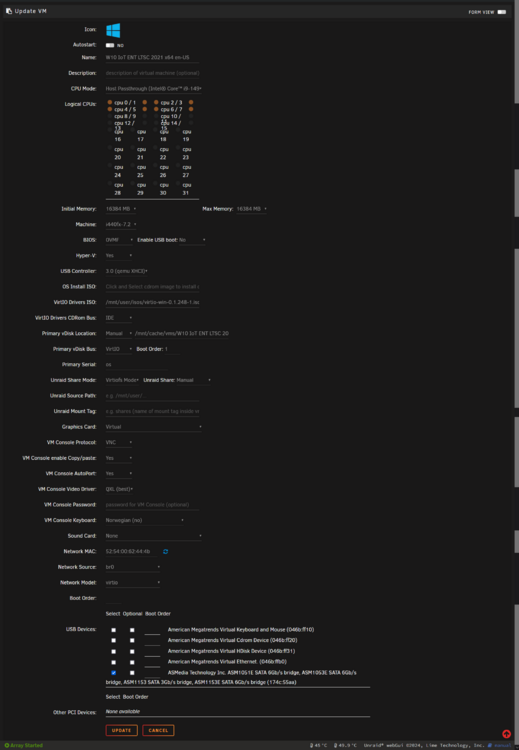

And this is with virtio-net?
Correct. I changed it as you suggested.
