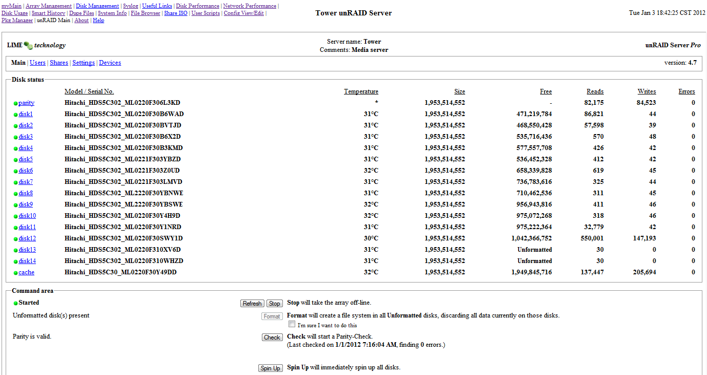

Can you post a screenshot of the unRAID screen as well
Thanks for answering.  I was getting nervous no one was interested....I'm actually quite worried because I have not experienced this problem before.  Here is a screen shot.  If you or anyone requires any further information please do not hesitate to ask.....As you can see from the screen shot the issue is disk 13 and 14 still appear as unformatted.
Edit:  If I select the option to the format option "I'm sure I want to do this" the the format becomes available...I guess I'm wondering if I should select the option to format again?  If yes should I take the array off line.  ???

You need to check the box to enable the "Format" button.  It is a second and separate step from the actual clearing.
Well that's embarrassing.....I selected to format the drives and all is well.  I updated my written instructions....so hopefully this won't happen next time.  Thank you gentleman :)
