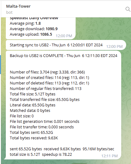

This is the messages sent to my Telegram account.  This week, it parsed 5.12TB of data to mirror, but only needed 65.52GB to update, which only required less than 12 minutes to complete:
