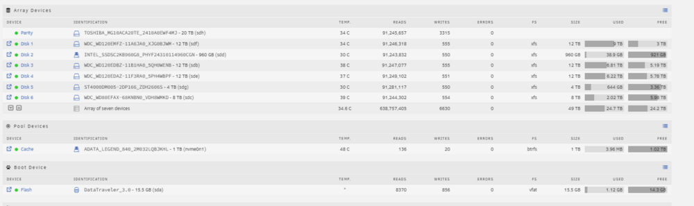

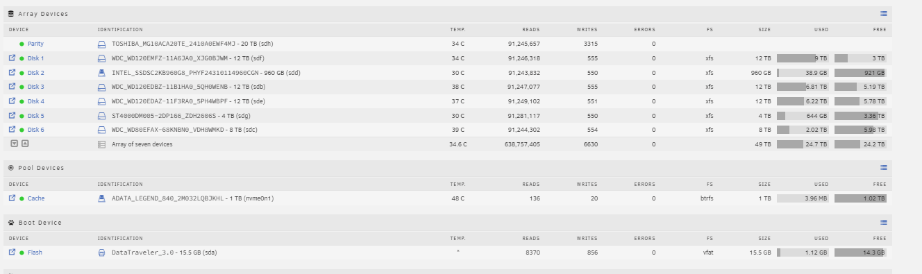

JorgeB Posted June 10, 2024 Posted June 10, 2024 Cache is showing as mounted on the screenshot, but it's also empty, did you format it? Quote
DuckWaze Posted June 12, 2024 Author Posted June 12, 2024 On 6/10/2024 at 5:42 PM, JorgeB said: Cache is showing as mounted on the screenshot, but it's also empty, did you format it? Yes, First it said "Unmountable: Unsupported or no file system'" and was unable to get it mounted. So then i did a format so i could get a new cache running. Quote

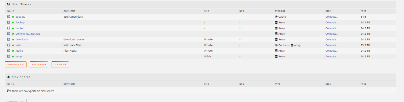

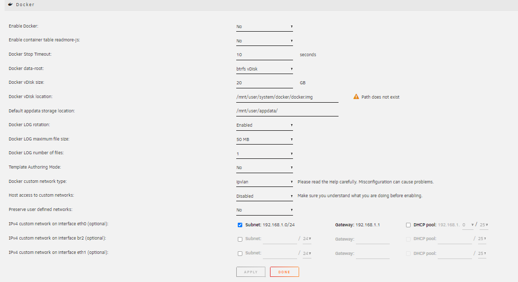

DuckWaze Posted June 12, 2024 Author Posted June 12, 2024 Here i have the error i get with Docker and a overview off my shares. Me hope i can get the dockers fixed by de back-up of appdata backup plugin Quote
Solution JorgeB Posted June 12, 2024 Solution Posted June 12, 2024 35 minutes ago, DuckWaze said: So then i did a format so i could get a new cache running. Formatting deletes everything, if you have a appdata backup you can restore it and recreate the docker image: https://docs.unraid.net/unraid-os/manual/docker-management/#re-create-the-docker-image-file Then: https://docs.unraid.net/unraid-os/manual/docker-management/#re-installing-docker-applications Also see below if you have any custom docker networks: https://docs.unraid.net/unraid-os/manual/docker-management/#docker-custom-networks Quote

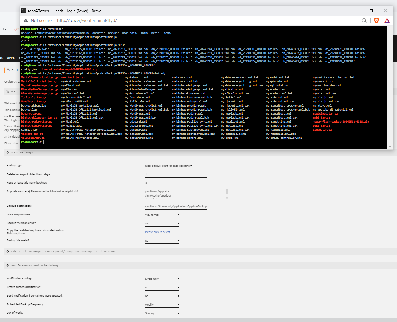

DuckWaze Posted June 20, 2024 Author Posted June 20, 2024 Thanks, I got the Cache Running again, Only i don't get the back-up from the dockers working. With the appdata plugin but i think this topic can marked as solved Thanks 1 Quote
